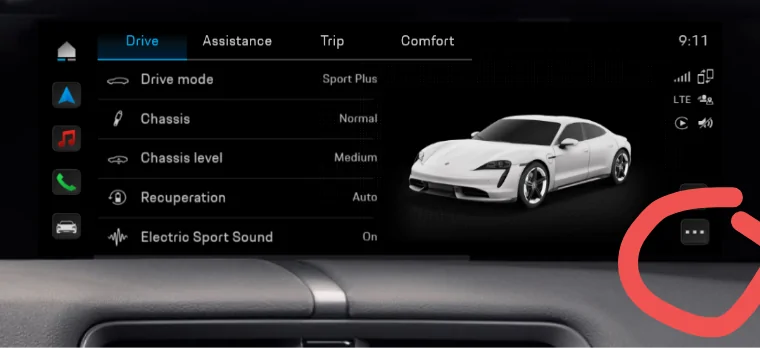

I think it is a setting for unlocking the doors. You can chose all doors, driver side only, drivers door only.
Would have to check where it exactly is in the menu.

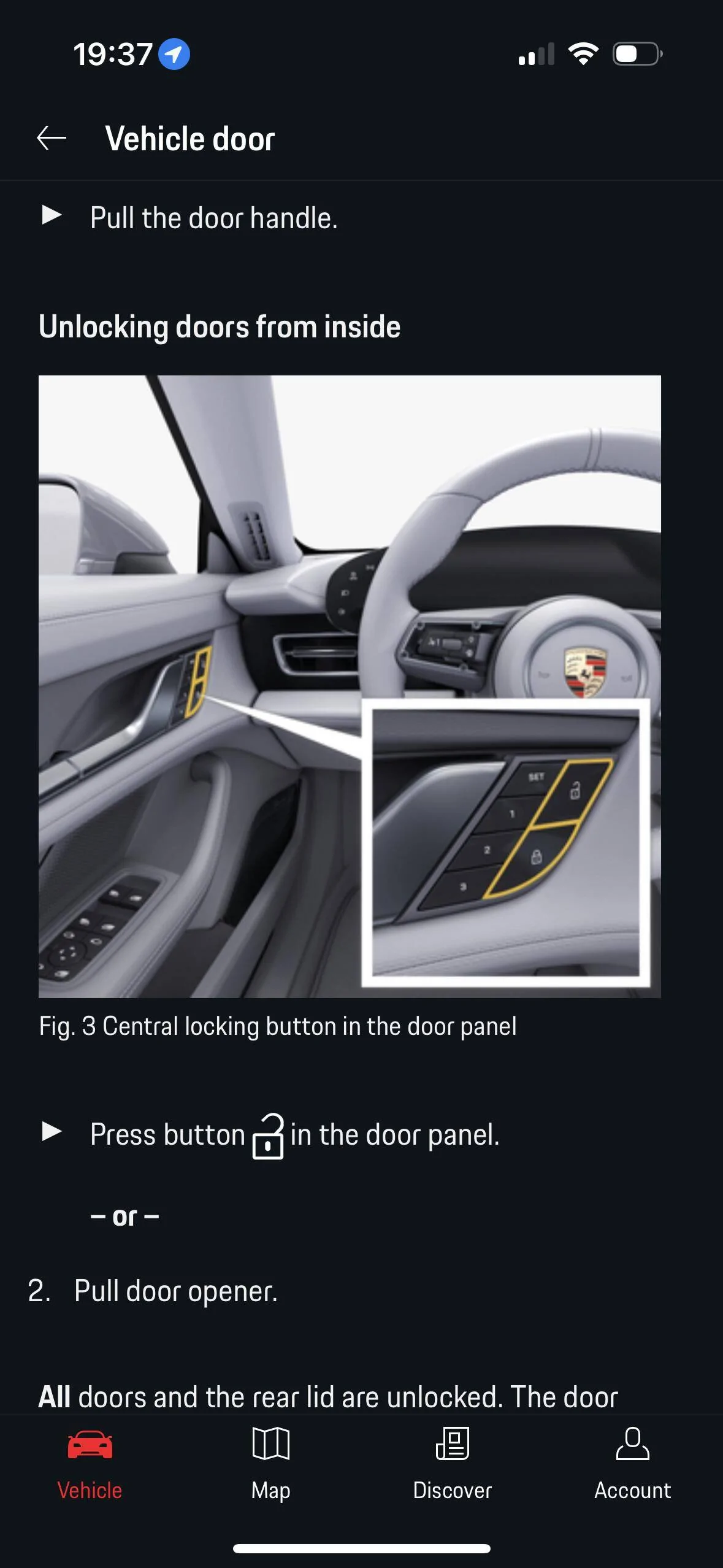

You should be able to unlock the doors using the interior unlock button by the door handle, worst case?

Check the vehicle locking options in the PCM - you can configure driver, driver's side and all.

It shouldn't change once set. It can be set per key so perhaps if this is the explanation then check settings on both keys.
