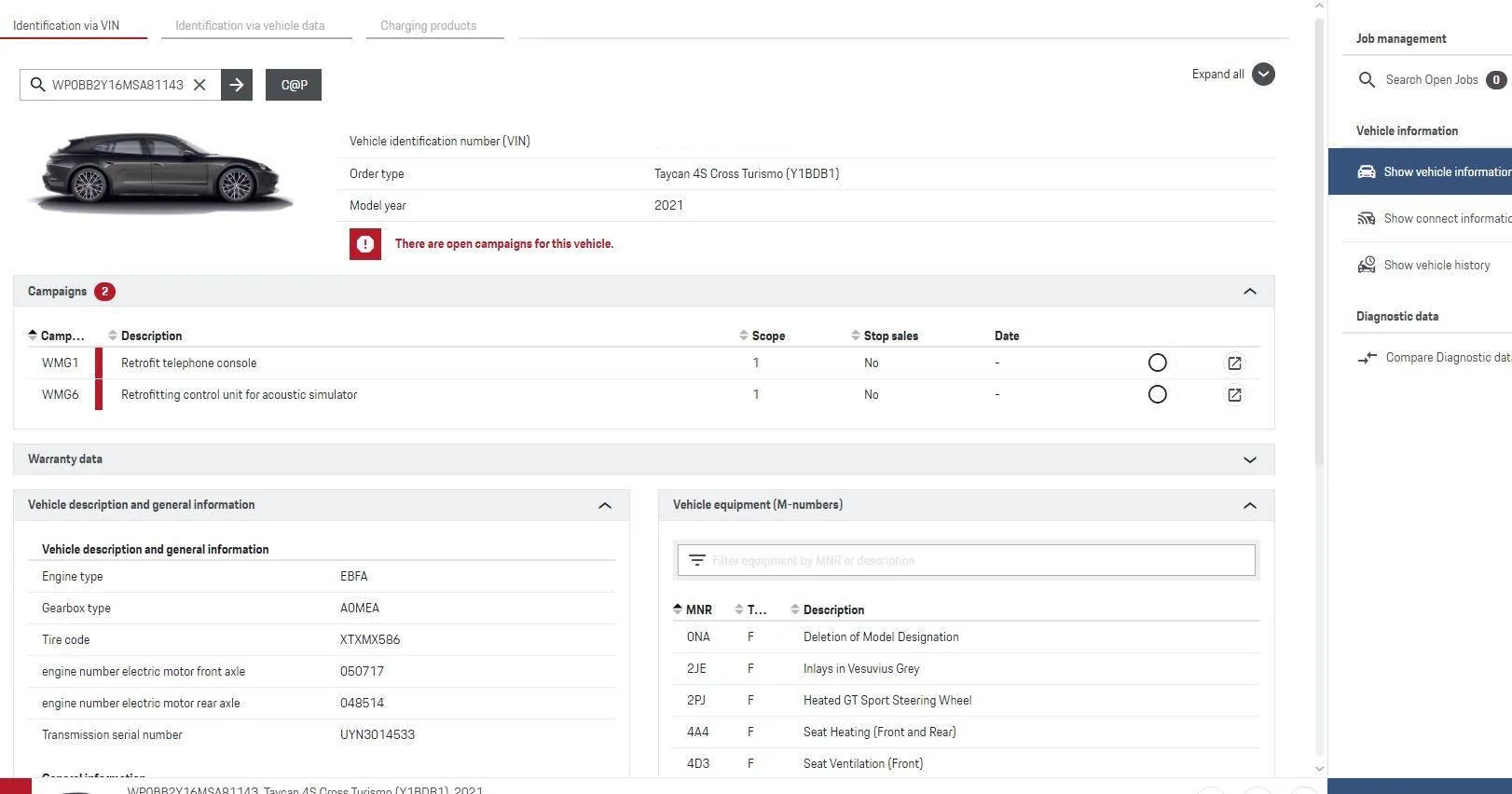

So for context, when I ordered my car and the build was complete out of the factory, I was able to look up the VIN and see there were a couple minor missing components thanks to the global parts shortage:
Porsche Taycan The mystery of the Acoustic Simulator module - what the hell does this do?? TaycanCT4Smissing parts
Fortunately neither components (phone charging pad or acoustic Simulator module) would affect delivery of my car or result in a stop sale. However I wondered what the Acoustic Simulator module was and best guess it had to do with controlling the Sport Sound (which I optioned) so I thought worst case my Sport Sound wouldn't work properly when I took delivery. Again no big deal I guess.
But when I did take delivery, my Sport Sound seemed to work normally which only raised more questions what the purpose of the missing Acoustic component was for. Then eventually I was able to get both missing components retrofit at a local dealership service dept and....still no real difference with the Electronic Sport Sound or any other obvious sound related function in my car.
So the mystery only continues to deepen what the heck the Acoustic Simulator Module actually does 🤔

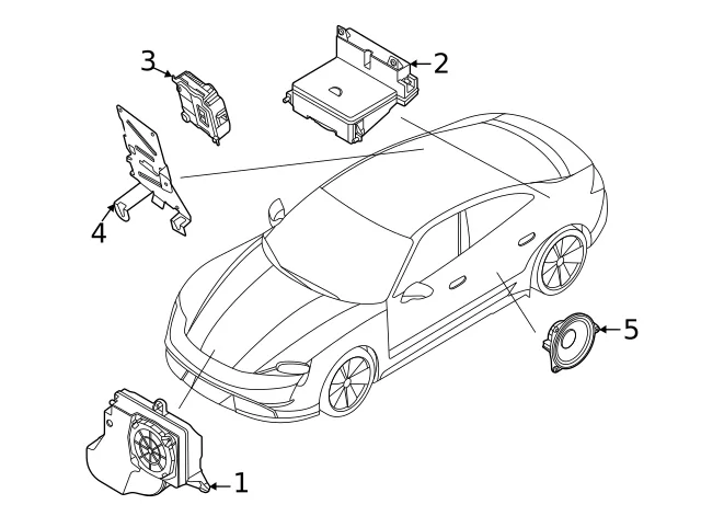

Might it be that you were missing one of the outside speakers? There are speakers both front and rear. This would then explain why you experienced the sportsound both before and after they installed the missing component.

That is possible. I really don't know what is all the hardware involved in Sport Sound production and sound system.
External speakers in the front and rear, as well as a pair of speakers in the rear doors for internal sound. And a dedicated amplifier for these four speakers, that seems to be installed in the passenger side of the trunk.
EDIT: Found a picture to illustrate.
Porsche Taycan The mystery of the Acoustic Simulator module - what the hell does this do?? e08dfd3e769a5b6660f92f648c8fe842

Thanks for the info! Can you explain how you found those open campaigns with you VIN? Or how to find any other stop sale items associated with that particular VIN? Thanks in advance!!
Kayone73
Kayone73
Ed
Apr 19, 2021
663
735
Orange County, CA
Someone else in this forums works for Porsche Parts Dept at a dealership and had access to their internal tracking system and sent me a screenshot.
This info is something normally not directly accessible to customers and we have to bug our SAs for this info.

DerekS on this forum found the retrofit manual for this a while back it seems, as it came up now when googling some partnumbers related to the acoustic simulator.
And it does seem to have a small'ish controle module...that I wasnt able to find in the partscatalogue... This is probable what your car was missing...
Item #6 on the picture on page 2:
https://static.nhtsa.gov/odi/tsbs/2020/MC-10183502-0001.pdf
