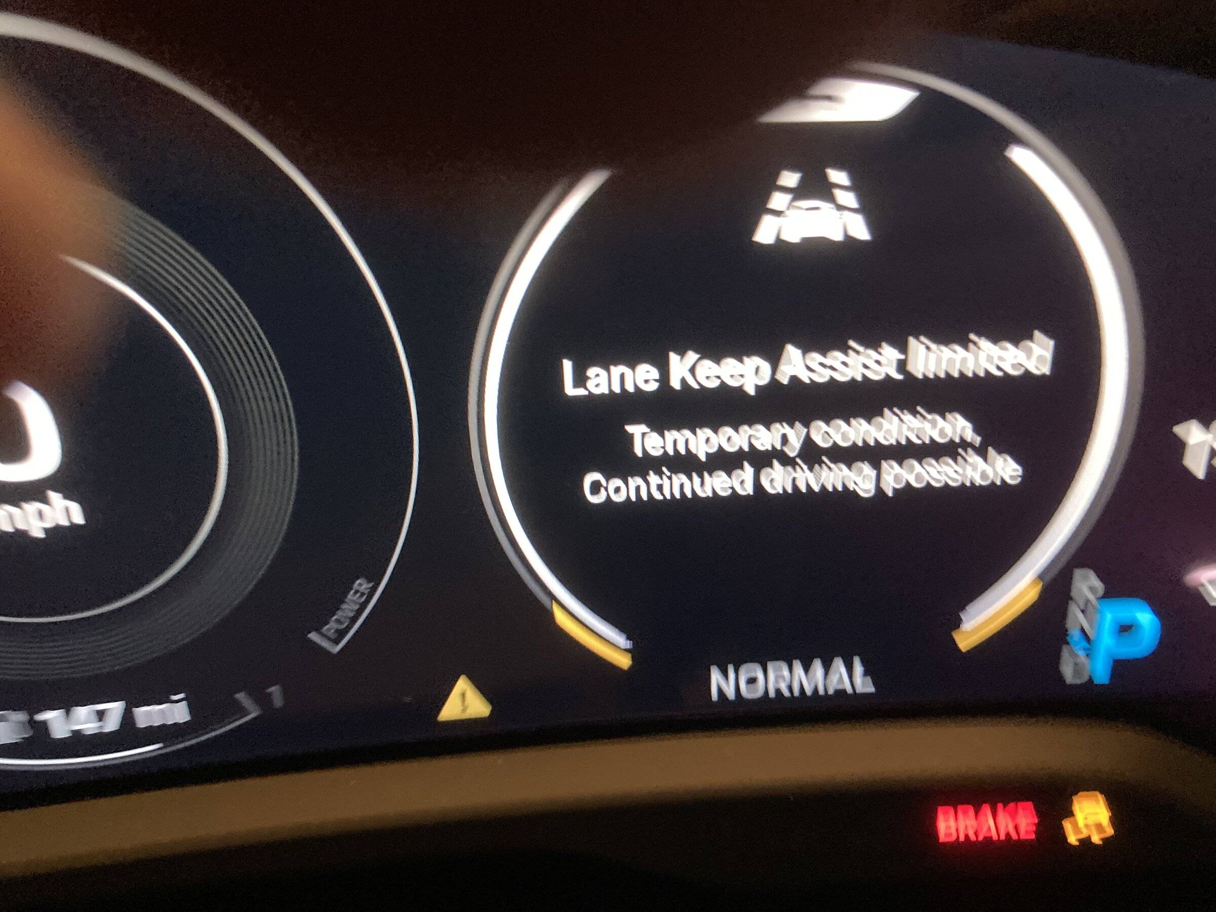

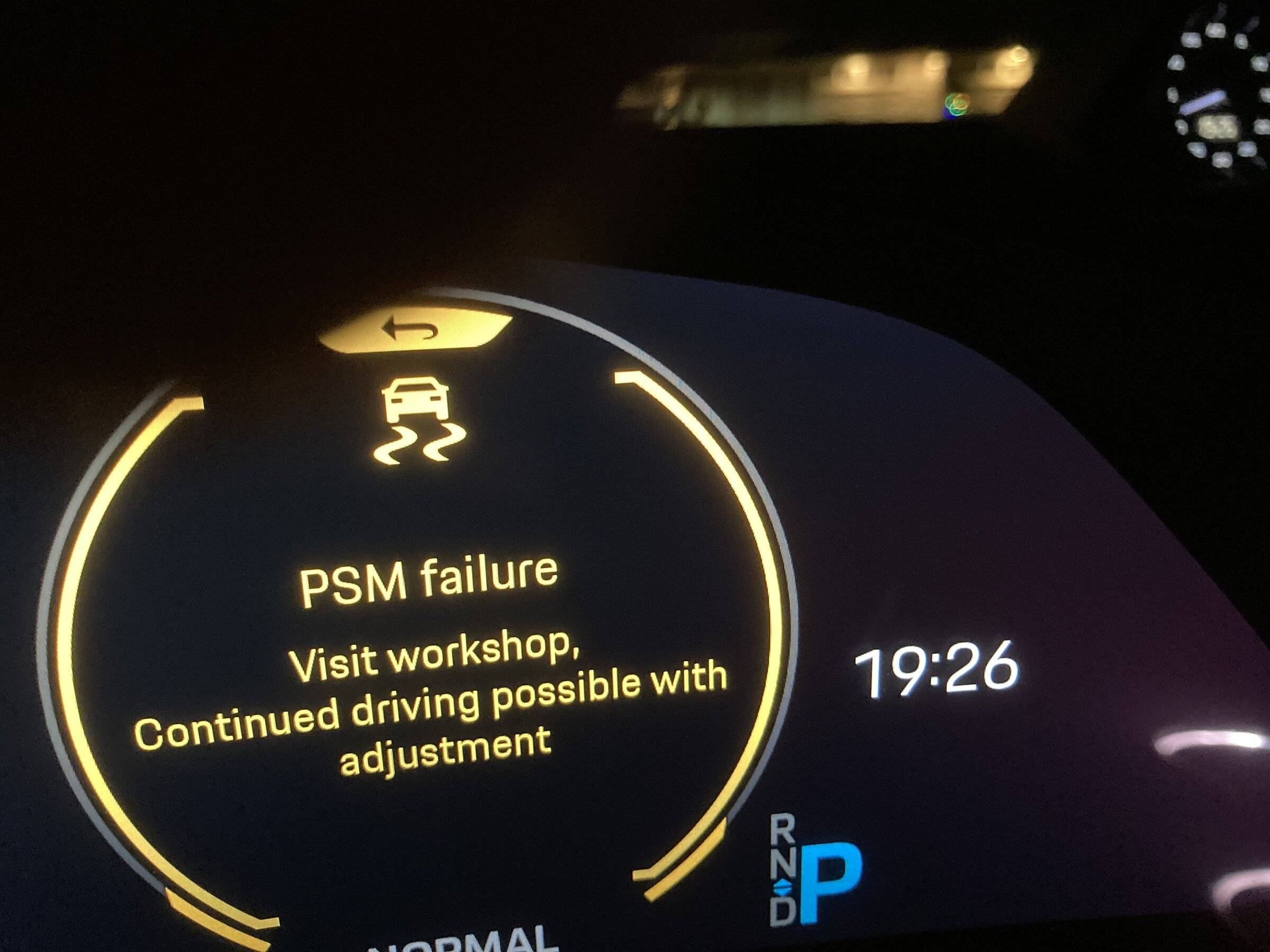

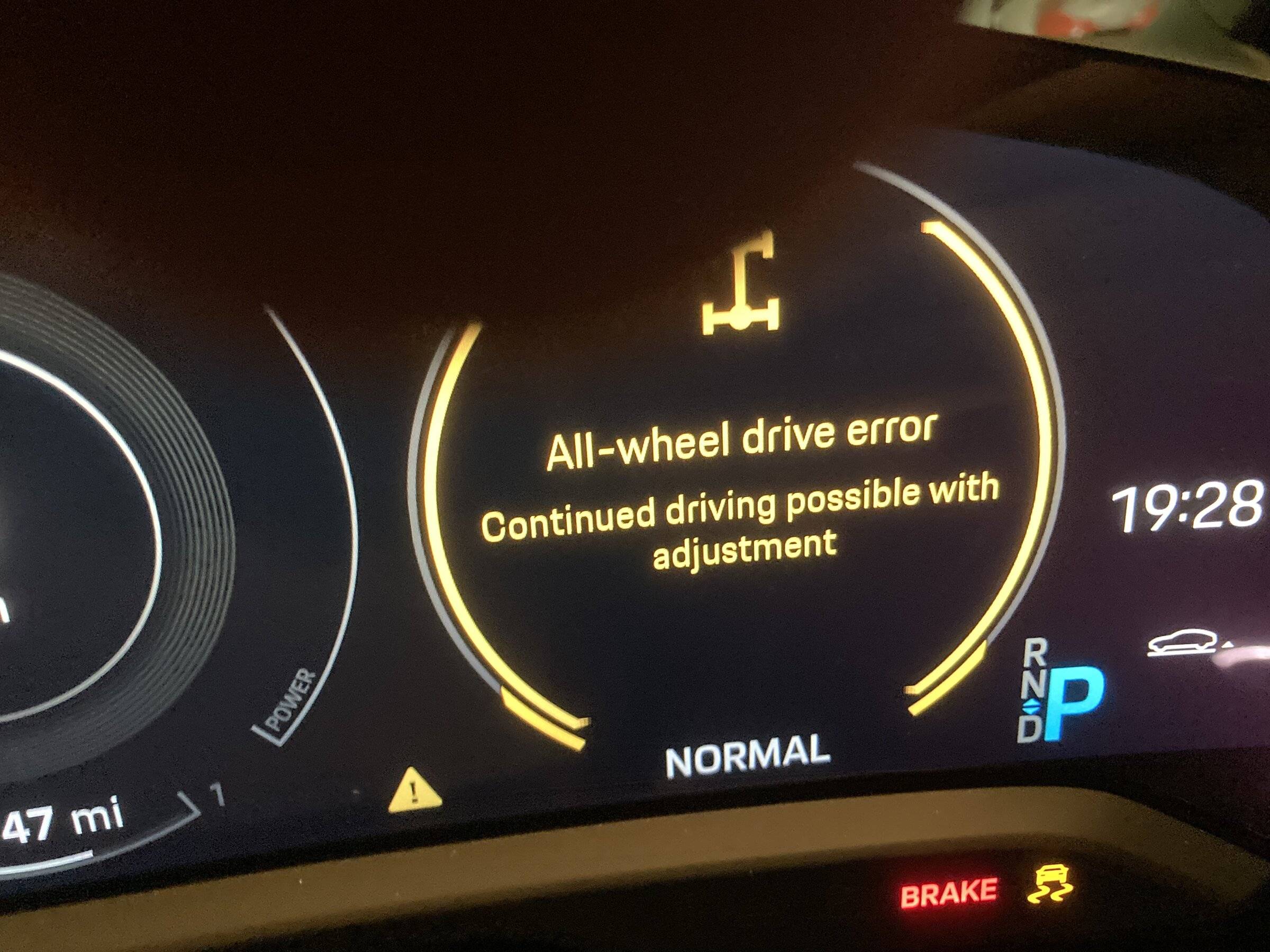

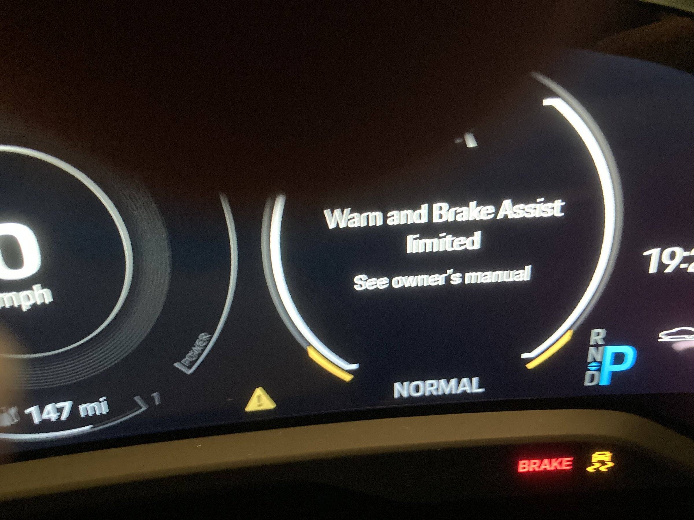

Weds or Thurs night I got a number of warning messages on the way home.
Porsche Taycan There’s a goat stuck in my front brakes AA9CE192-86C5-49AA-8436-9309267D9AE8
Porsche Taycan There’s a goat stuck in my front brakes 6B5707D1-C071-4ACA-BD36-7472EDE6C1C8
Porsche Taycan There’s a goat stuck in my front brakes D665E5D7-BE52-42CD-9AA1-FB4C52728B44
Porsche Taycan There’s a goat stuck in my front brakes 359F153D-881D-4C1F-ACA7-2718E197E6F9
Car is sitting at the dealer lot waiting for evaluation next week. ?
