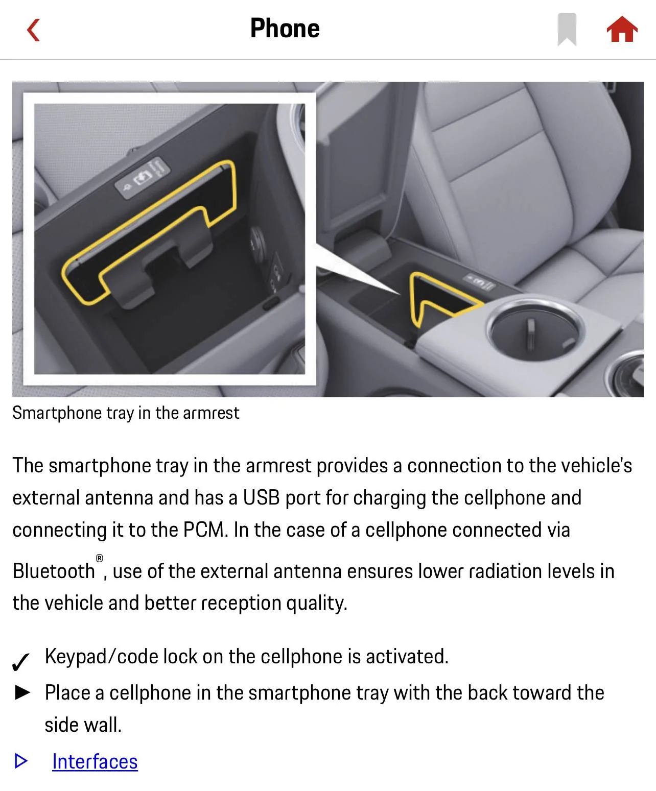

I don't like that mobile phone reception is a lot worse (and my commute has 3 zones where the call drops, whereas in other cars it might not drop at all, or only once) but I would spec it again. It's like an insulated capsule.
Do you have the mobile phone external antenna feature in Portugal? Here's what we have in North America:
Porsche Taycan Thermally & Noise Insulated Glass 1661617195734
bihus
Sep 3, 2019
Portugal
Yes, we do have the same in Europe. But as I'm one of the early adopters, that waited 2,5 years with a 25k down payment for a MY20 that will only get Android Auto next week (hopefully), I prefer to have the phone out to use Waze. But I'll give it a try. It's worth the experience.
