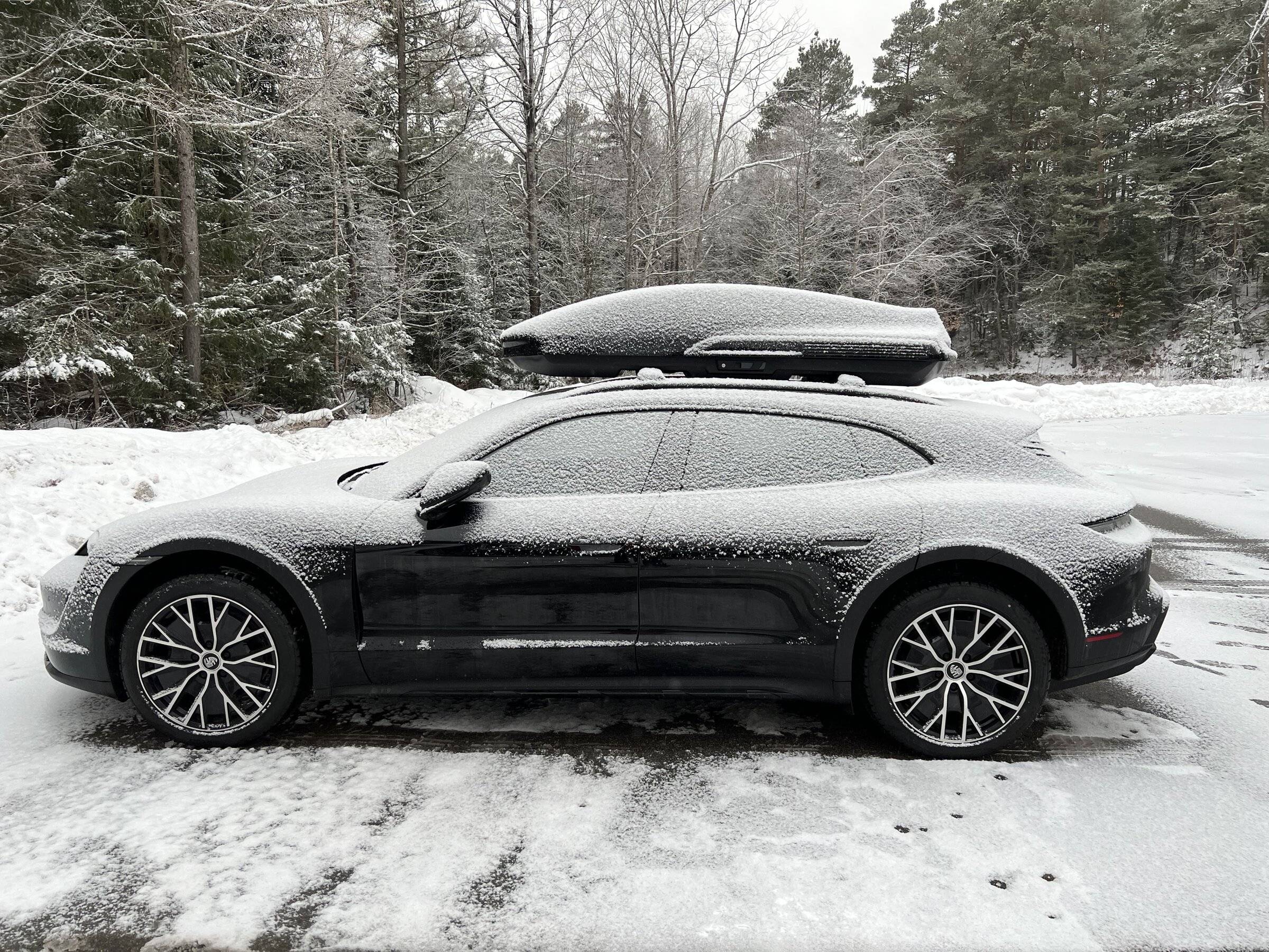

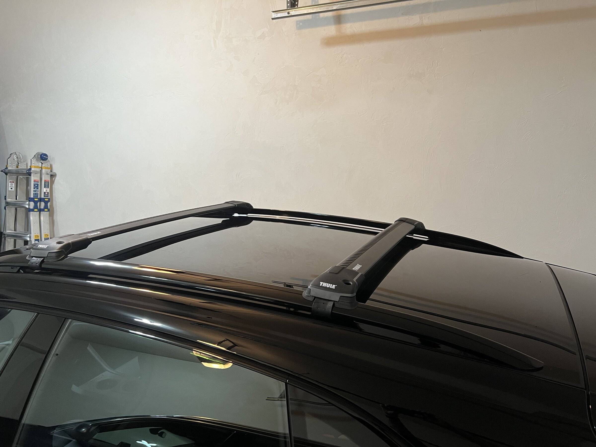

Some discussion in this thread. I purchased the Thule Wingbar Edge in black from an online retailer on Europe and had them shipped to the US. The Thule Wingbars are low profile and width-adjustable (though you still need to buy the correct size - WingBar Edge 9585B). They fit well. I am using them with the Porsche Performance Roof Box.

I have the 9585B and they are spring loaded so they adjust for the difference in width. They are low profile and fit great - enough clearance for our thule roof box attachment claws. I dont like how high the OEMs ones sit.

What Thule roofbox do you have? I ordered a Vector M. It is aerodynamic and the front comes quite low. I hope this won’t be a problem with the low position of the wingbars.

9585 or 9585B are the correct SKUs. On the FixParts site, notice that the part number changes depending on selection of the size, which in FixParts designation should be M/L for the CT. I and others here have the 9585B. It is adjustable and fits the CT roof bars well.
