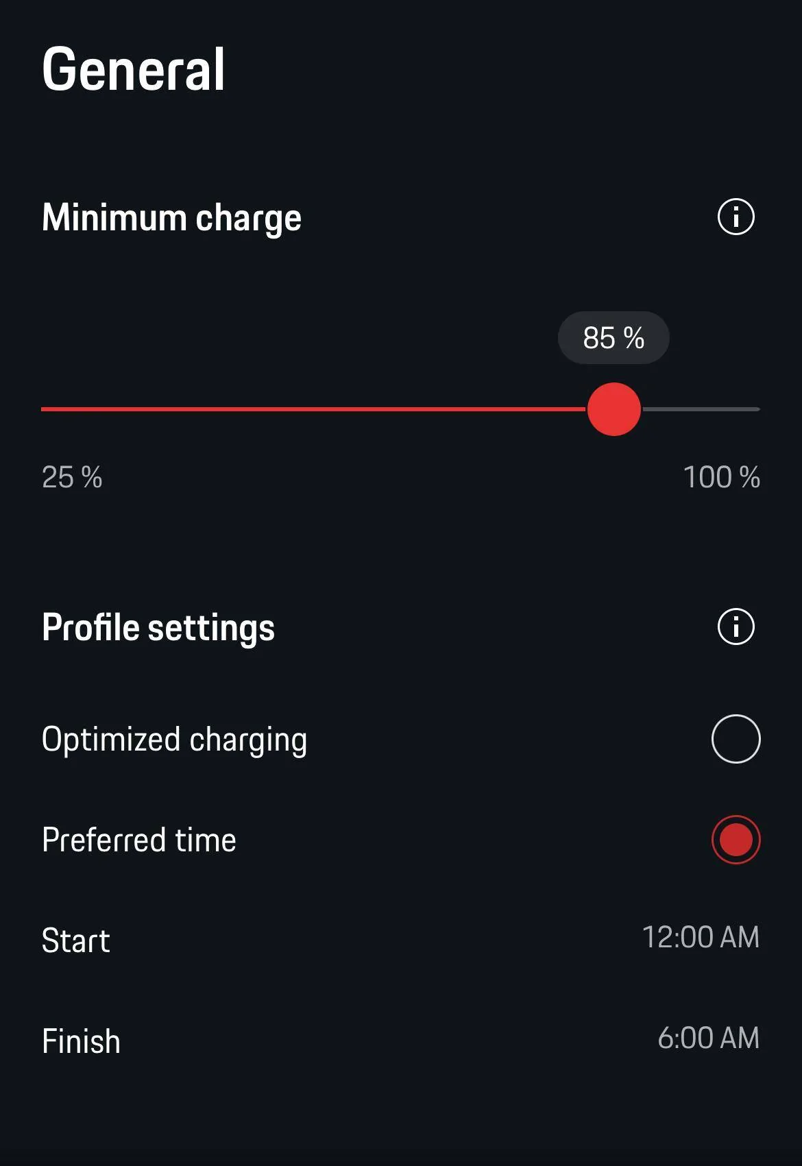

Yes, you can create / modify a charging profile from the My Porsche app, or directly on the PCM in the car, setting the preferred charging time. Example:
Porsche Taycan Timed charging? 1657770006098

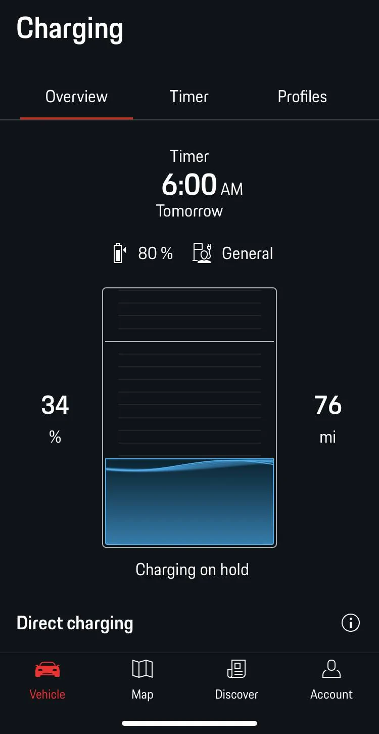

I have a timer set right now that will have my vehicle charged to 80% by 6AM tomorrow. Here’s what the charging screen shows in that case.
Porsche Taycan Timed charging? 651154ED-C990-445C-BFB1-90570369A2CC
