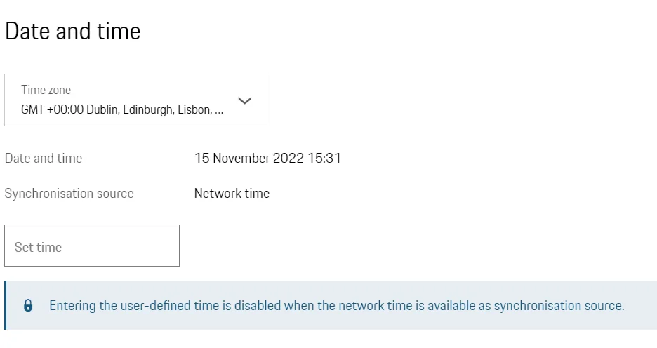

Might be worth checking what time the EVSE is set to. If it is the PMCC (for example) and it has bee connected to your network then it should auto adjust:

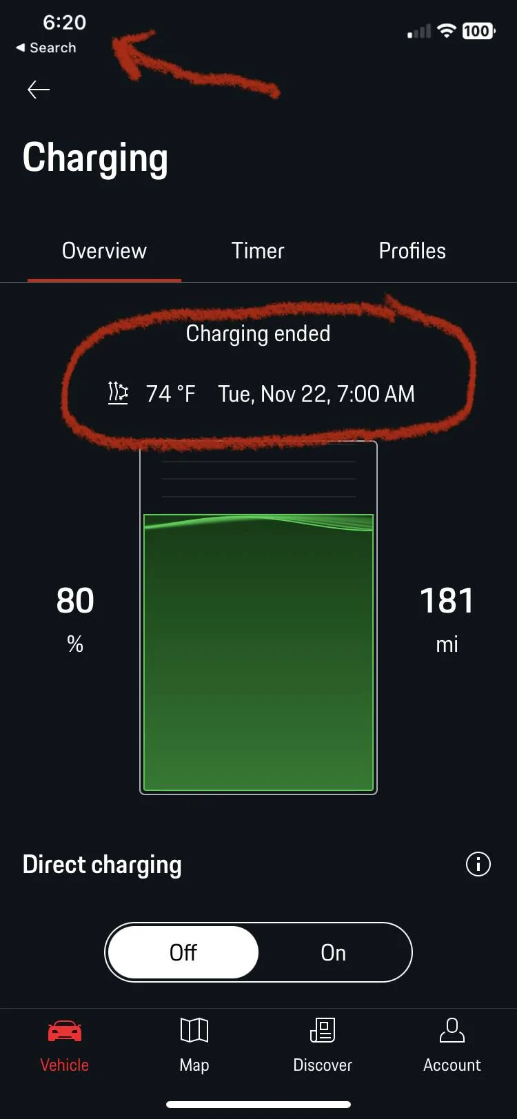

Here’s a screenshot showing the timer issue…

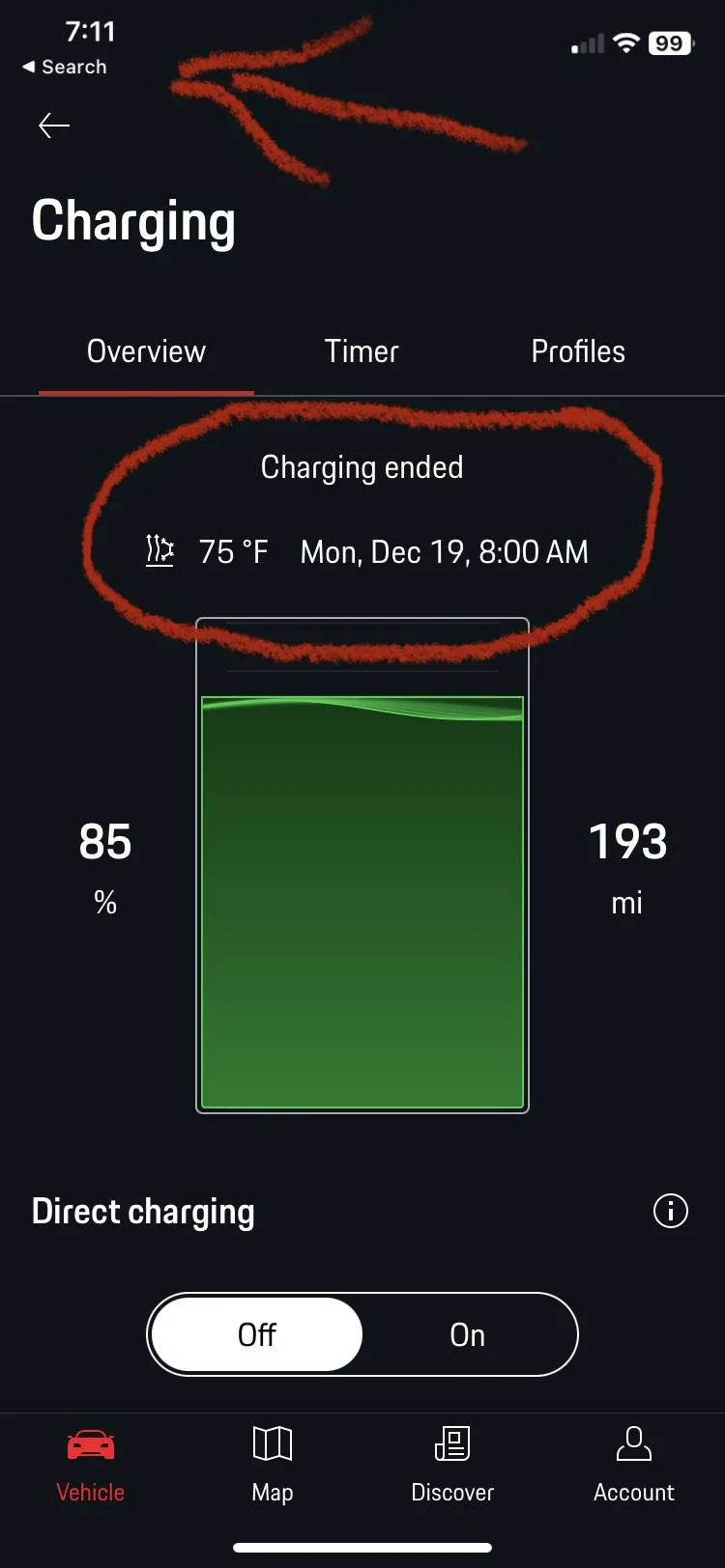

Since I originally posted about this issue I have sold that car and got a new one (another CT4 that I had custom ordered). The new one has the same exact issue. Not a big deal but just another software bug…
