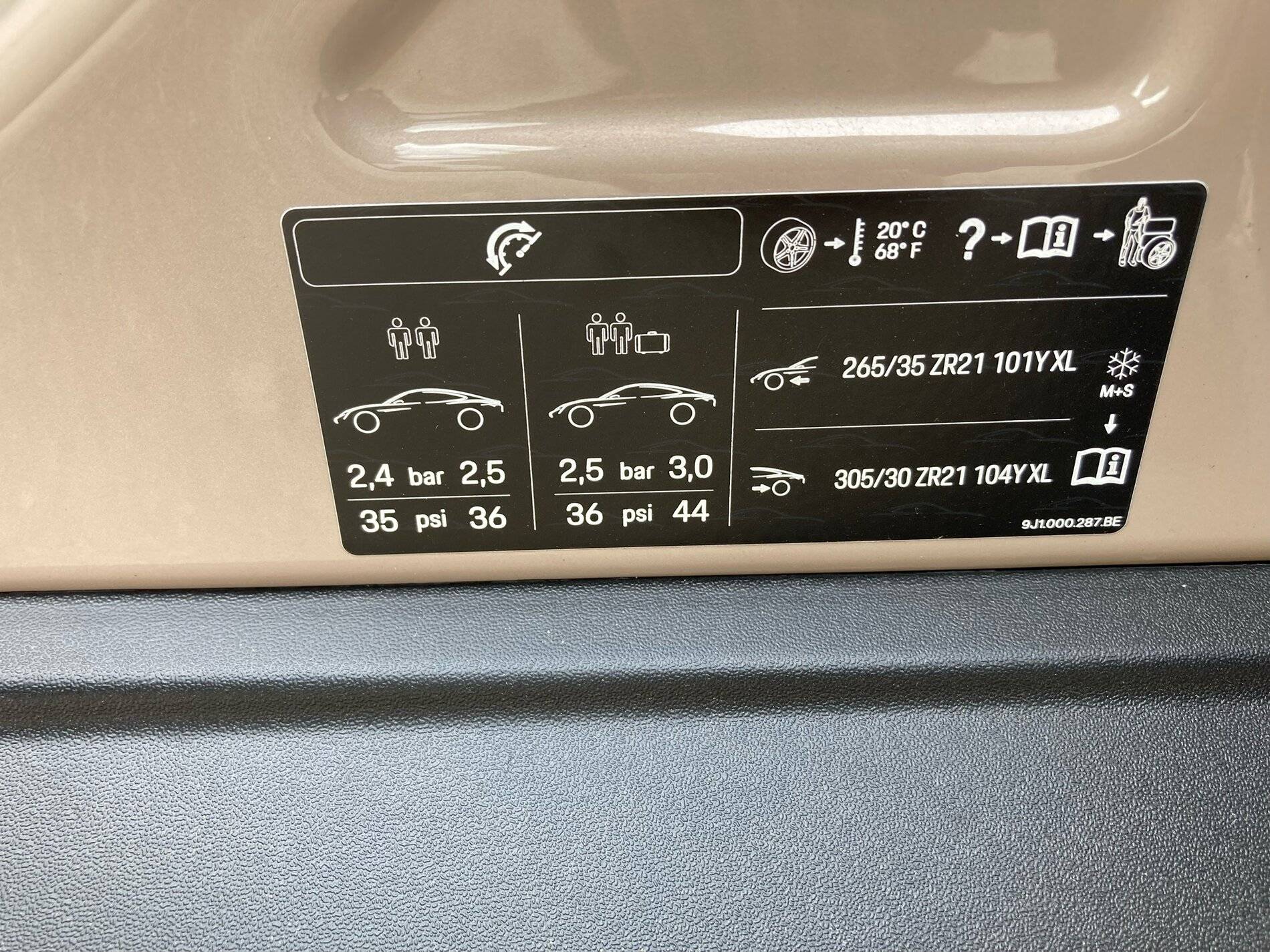

Thanks for that. Checked it and it says 2.6 / 2.3
As a reminder, the pressures on the door label are for full load. If it's just you, go for the partial load pressures. Anywhere between the two is fine though.
I have different pressures on the label (full load, one-two passengers only), but I don’t remember if there are additional settings for winter tyres as well.
I’ll make photo later.

Here’s my label:
Porsche Taycan Tire pressure / winter tires / tire noise 99D6FD55-CE61-44E8-8116-B9467BA7903C
