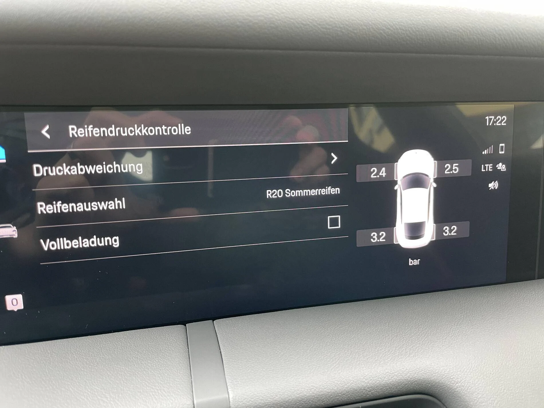

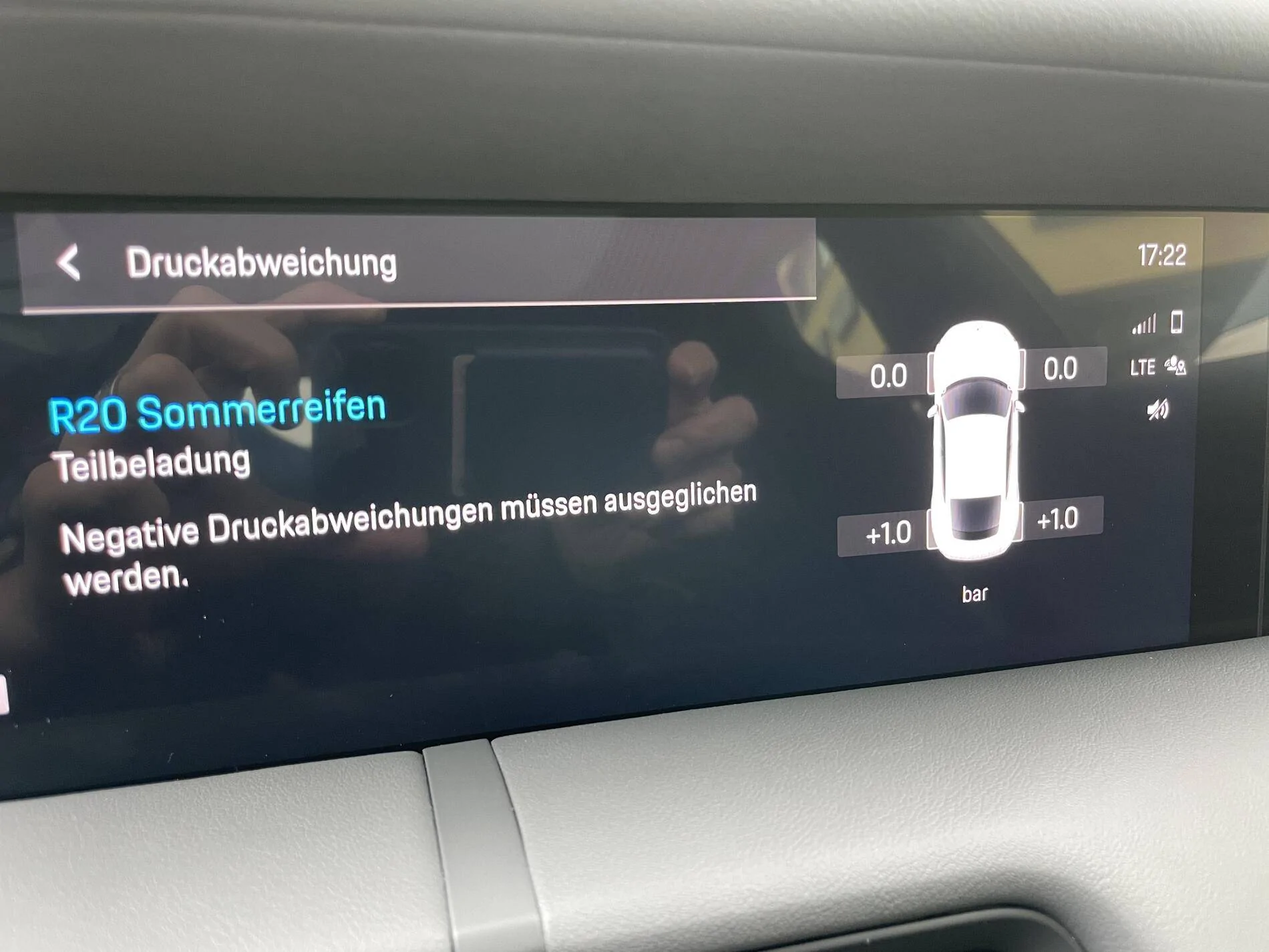

Hey everyone. I had my software update on Tuesday (only minor problems and settings getting lost as well as integrated Apple Music icon no longer appearing) and finally switched to summer tires as the car was delivered on winter tires.
So whilst I was checking the settings I landed on the tire pressure section and my rear tires are at 3.0 bar????? I have Michelin Pilot Sport 4 245/45 R20 front and 285/40 R 20 in the back.
I sent the dealer the photos and he said come in for me to check. I then asked him: what should the pressure be? Especially as I noticed that the front tires of the Taycan have higher pressure than the back tires (at least for my winter tires). He could not answer me and said the sticker on the car door is just a "reference" and not the real pressure. I just want to know what it should be and go to the petrol station and see what their basic tire pumps says my pressure is.
He said those are never exact and wants me to come in to make sure that it is not a fault on the reading in the PCM :mad:. What tire pressure do you guys have? Last time I ever saw tire pressure above 3.0 bar was a 930 Turbo.

Thanks guys.
In the end the pressure was at 3.0 cold. The dealer wanted me to come in as initially they thought it was a wrong reading and that the software update had somehow messed with it, which was not the case.
The guy then said not to follow the sticker on the driver door or Good to Know as even the tire pressures could be updated based on the "latest" knowledge of Porsche and tires. So he said: stick to making sure the correct tires are chosen in the PCM and then go by what the PCM display tells you to do!
Same for toggling full load/partial load advice.

He said to use the R20 Summer tires setting as I do not have EV specific tires (also an option in the R20 size).
He also recommended go down maybe 0,2 and 0,3 and drive a day so you do not end up being too low. So if you are at 3.0 you probably have 2-3 days of doing this.

Eh gad!!!! Now press on the scrolling button/wheel and you will see how much you are too high!!!
My suspicion: My car was delivered on winter tires, so maybe the summer tires were stored at 3.0 and they forgot to reduce when they changed the tires last week.

I have to check... will post a photo. But it is higher in the front and lower in the back. Think it is 2.6 front and 2.4 back.
Well they probably would have heated up a bit, but I saw that they are specced to have a max pressure of 5.0 bar! Let just hope that you never got to that level :eek:
