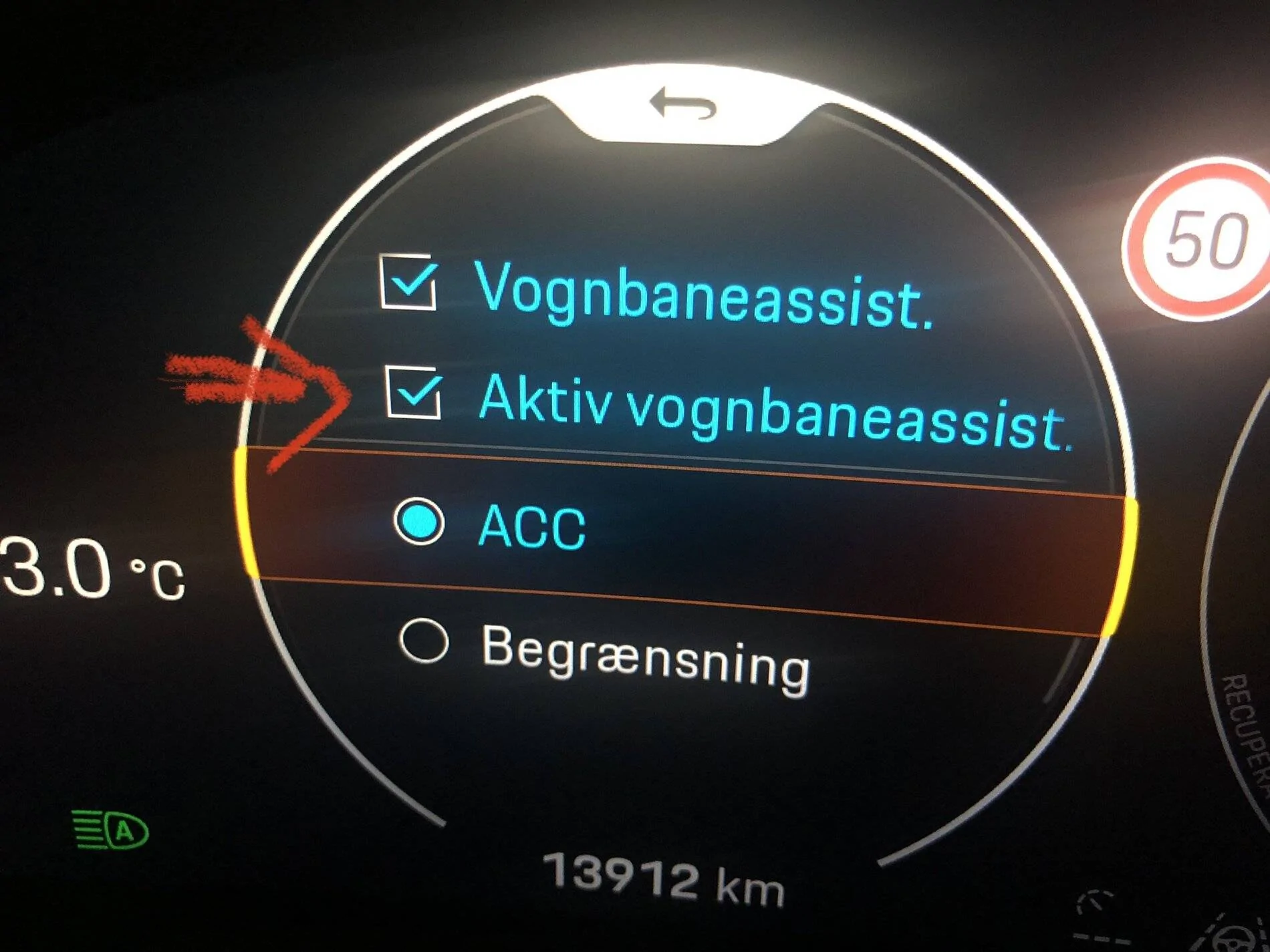

@14) have you tried / upgraded active route guidance which assist the lane keep system? It can be purchased in the Connect store (OTA). It sounds to me that you rely on the lane keep assistance alone which does not keep the car in center of the lane. But with the upgraded function - the car works beautifully in this regard also :) I did ad it and appriciate it on highway when on longer journeys as the car the drives almost by itself.

Hi JacobDK, I am very happy to hear this. Do you recall the exact name of the route guidance upgrade?
I guess it will be called “Active Lanekeeping Assistant” in english - the option shows up in the ACC menu (see picture)
