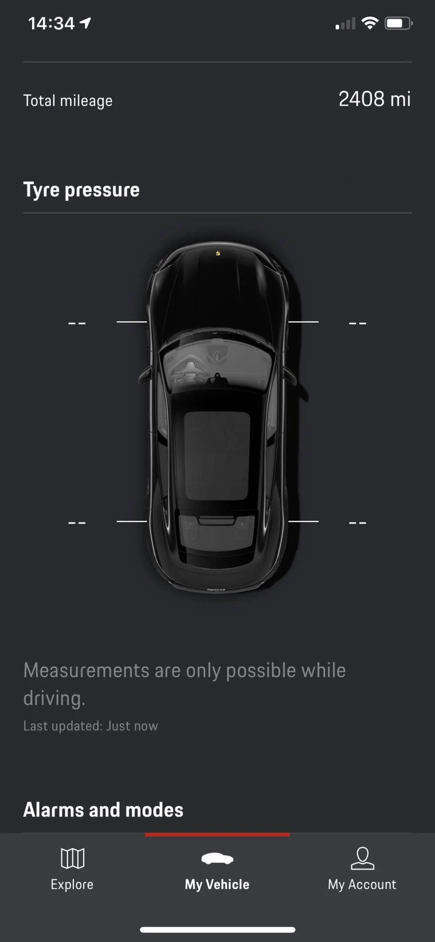

Had a low tyre pressure warning so I topped up with air. I tried to reset the system but just get spinning circles.
Car says reset will only occur above 15mph so I have driven around 10 miles above 15mph but this wont reset and the low pressure warning remains!
Each time I stop the car it stops and then starts again when I set off so I did a 10 mile highway run but still the same!!
Air pressure now checked manually and its correct.
The app not showing anything either!
