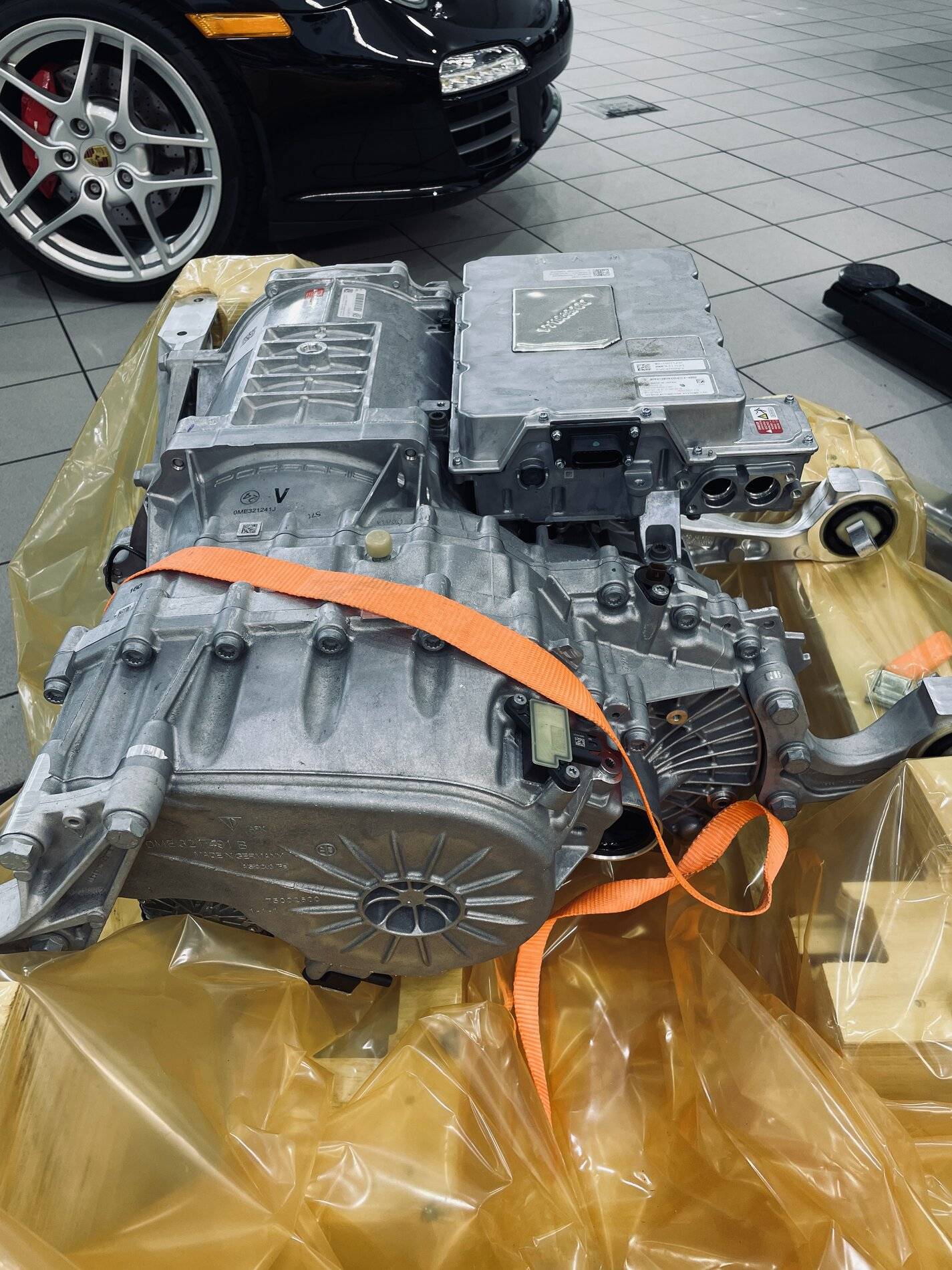

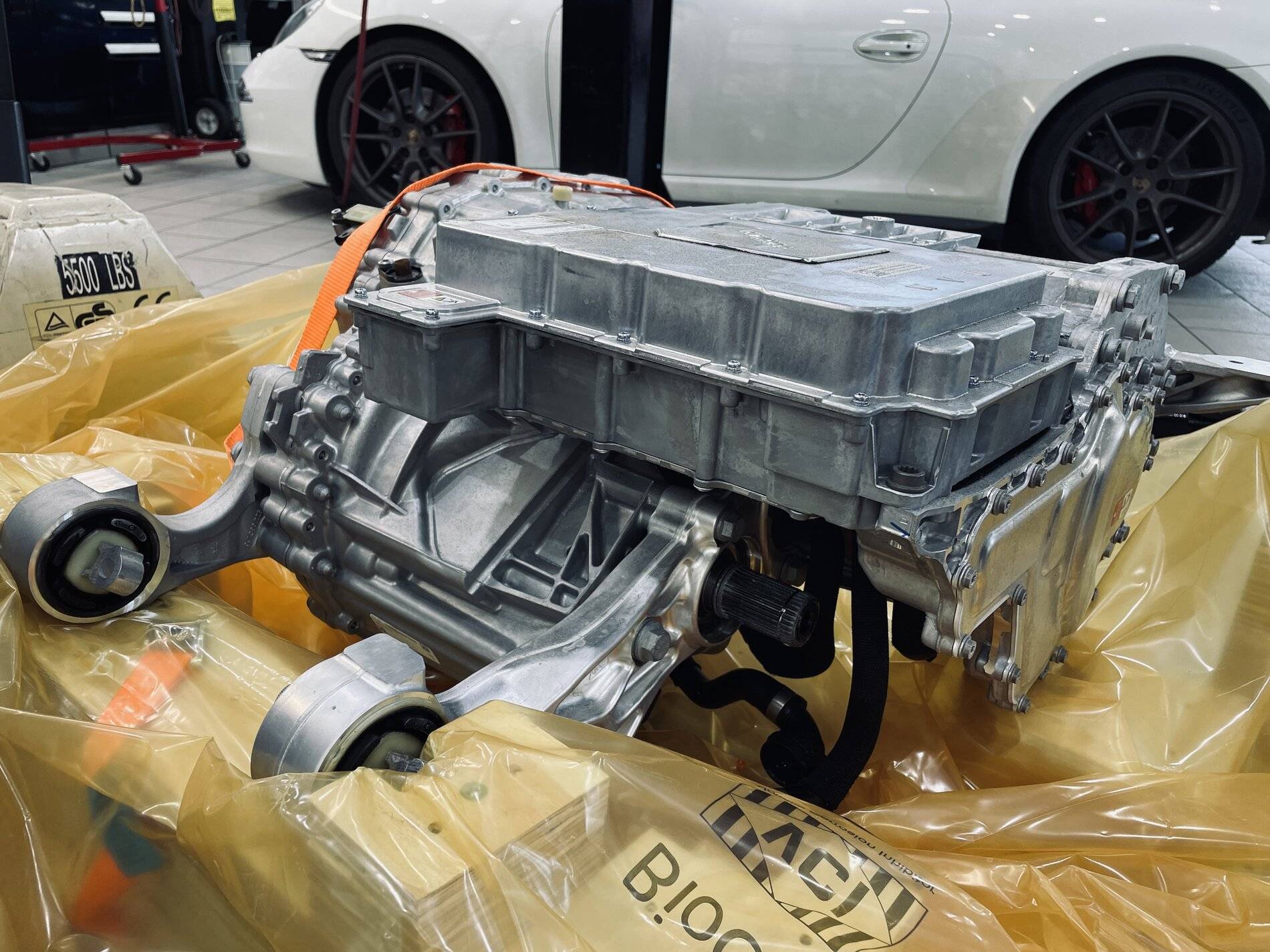

@rs38 no explanation as to what the problem is. Porsche sent an entire replacement and the original will be shipped to them for evaluation. As of Monday (10/4) the unit was installed. I'm waiting to hear if the noise is gone. Here are photos of the original assembly:

Received my car back this weekend. NOISE GONE! Looks like the new motor/trans resolved the issue.
