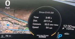

The Drive to Bob's Well Bread was uneventful - we left home at 100% SOC - and I purposely "under drove" the speed limits to see how well the Taycan could do. I was in full range mode, and drove under the speed limit by 2-3 mph the entire way -except for some rare bursts of speed to pass or get out of the way of other's tail gating me.
The Taycan did spectacular! Temperatures were mild 63F-78F and we ran climate control in eco mode for the entire route. Efficiency was better than I ever achieved with my 2013 Model S P85D - and came in at 305 wh/mile - see picture below.
The Drive to Bob's well bread used 72% SOC (arriving at 28% SOC) with 78 miles "left" on the range meter in the center of the dash display. This places the Taycan firmly in the 280 mile range category - and strangely enough the exact distance was 201.9 miles - which is the Taycan's EPA rating. We we drove the EPA distance and arrived with 28% battery left over.
Importantly the Porsche navigation system originally estimated we'd arrive @ Bob's WB with 21% SOC - but given my gentle driving we actually managed to arrive @ 28% SOC - a real gain in range due to being very judicious on the throttle and average speed. If you're driving 280 miles or less and the Porsche NAV estimate says you'll arrive with 5% or more SOC I'm pretty sure the Taycan can do it.
one of the reason for this trip was to "test" Porsche NAV battery % estimate - and I found on this trip the estimates to be rock solid. Which makes the porsche nav a great EV planning tool!
Based on this experience I would get in a Taycan and easily drive 260-270 miles in mild conditions with no problem as long as I knew the charging landscape as to where I was heading.

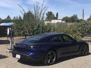

Bob's also has two L2 chargers - and while we ordered lunch (they were quite busy) and baked goods I used my 80 amp TeslaTap to charge from the 40 amp Tesla L2 destination charger - during our stay at Bob's Well Bread we managed to go from an SOC% of 28 to 40% when we left.

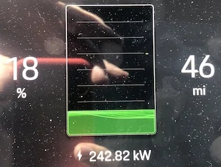

  • Activation via the Charge America app - after failing with Porsche Connect app (it didn't show any chargers to activate)
  • Charge rate as you can see was 242.82 kW to start with
  • And at the end of the session I made sure the vehicle was fully unlocked and the keyFob was in my pocket and the charging connector came out the first time.
  • 100% success and such a fast charging experience.

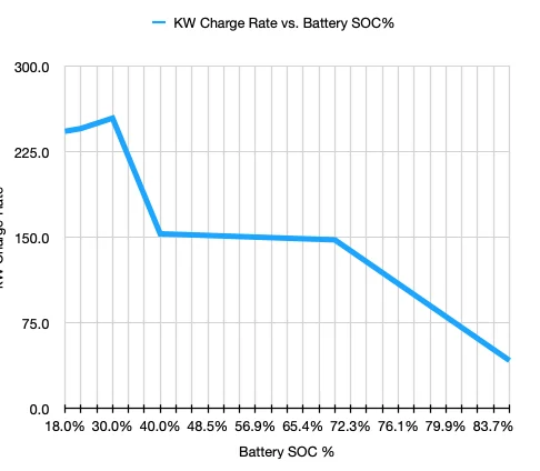

When the 350 kW chargers work the experience is stunningly good! We stayed exactly 30 minutes (the included free session) and managed to charge from from 18% SOC to 88% SOC in 30 mm 53 sec - and we delivered 67 kWh to the battery in that time for an average charge rate of 130 kW - I have never in 7 years of owning an EV charged to nearly 90% SOC in 30 minutes.
I initially got 242 and in various checking I peaked at 254 kW (nearly the 270 kW limit) but when checking later it had tapered to 150 kW or less - I don't have data for the entire session, but I do have data from various points and I've interpolated the "missing data" points - below you can see the graph of KW charge rate vs. battery SOC% - from my charging session the Taycan maintained a healthy 150 kW charge rate right up to about 70% SOC - and then started tapering…I'm not sure if the car was limiting charge rate or the EA station was limiting charge rate because I thought the rate could be above 200 kW until at least 60% - it doesn't really matter because nearly 90% SOC in 30 minutes is just great - and my wife and I both felt a bit rushed while we walked the dog to get back to the car at the 30 minute mark…

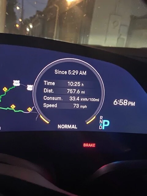

Since we are all talking about Taycan drives today - here is mine. I drove from Flagstaff, AZ to Denver via I-40 and I-25 - there are no fast chargers to take the shorter route through northern New Mexico into Southern Colorado, so I had to take the long way.
Have a 4s with the 20's on it, and temps were anywhere from mid-40's in the morning when I left Flagstaff to mid-80's in Central New Mexico.
I usually did anywhere from 5 to 10 miles over the speed limit. I left Flagstaff with 90% charge and charged to 90% or 95% in Gallup, Santa Fe, and Trinidad, Colorado. Usually took 30 minutes to get to a nearly full battery at the EA chargers.
This was the last leg of my 2,500 mile road trip, and should have planned the last leg a little better. 13 hours is a loooooooooooong time in an EV!!

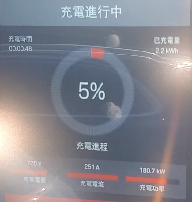

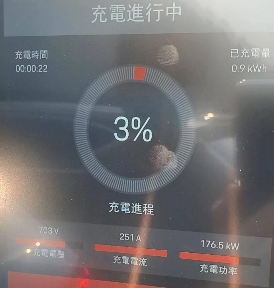

First time on a Porsche Hypercharger.
Is the Taycan topping out at 250 Amp charging current?
I finally got confirmation, that the Chinese standard also can fast charge.

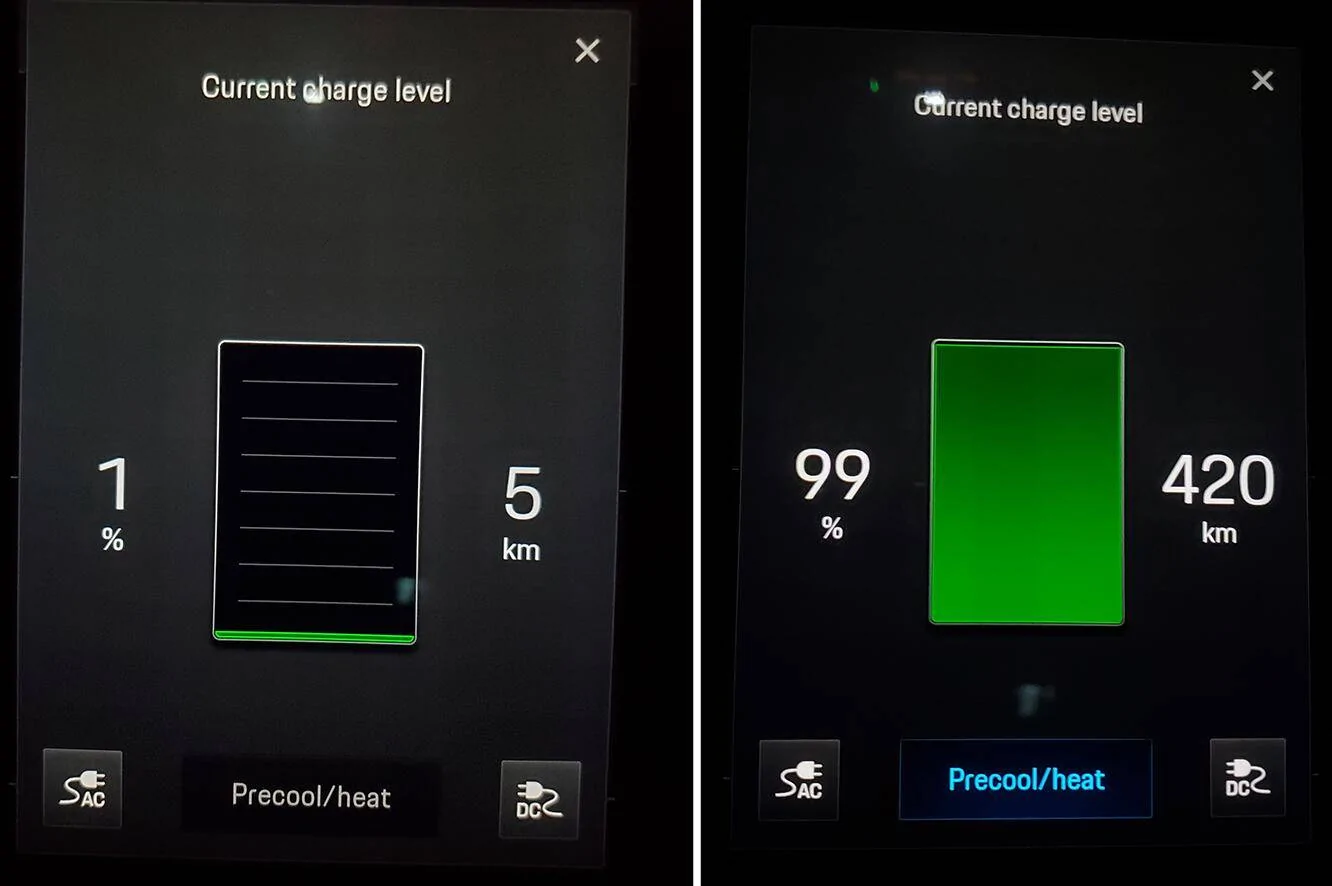

If you keep your consumption in a narrow range, the total range estimate is accurate down to 1 or 2 miles. Considering how on my MS90D the battery range melts away at low SOC, I find the Taycan BC amazing! My Taycan parks with 6% SOC and I am not even bothered to plug it in, cause I know I only have short school run the next morning.
Last night I charged to 99% and now I have 260mi of mega-city-driving range. :like:
