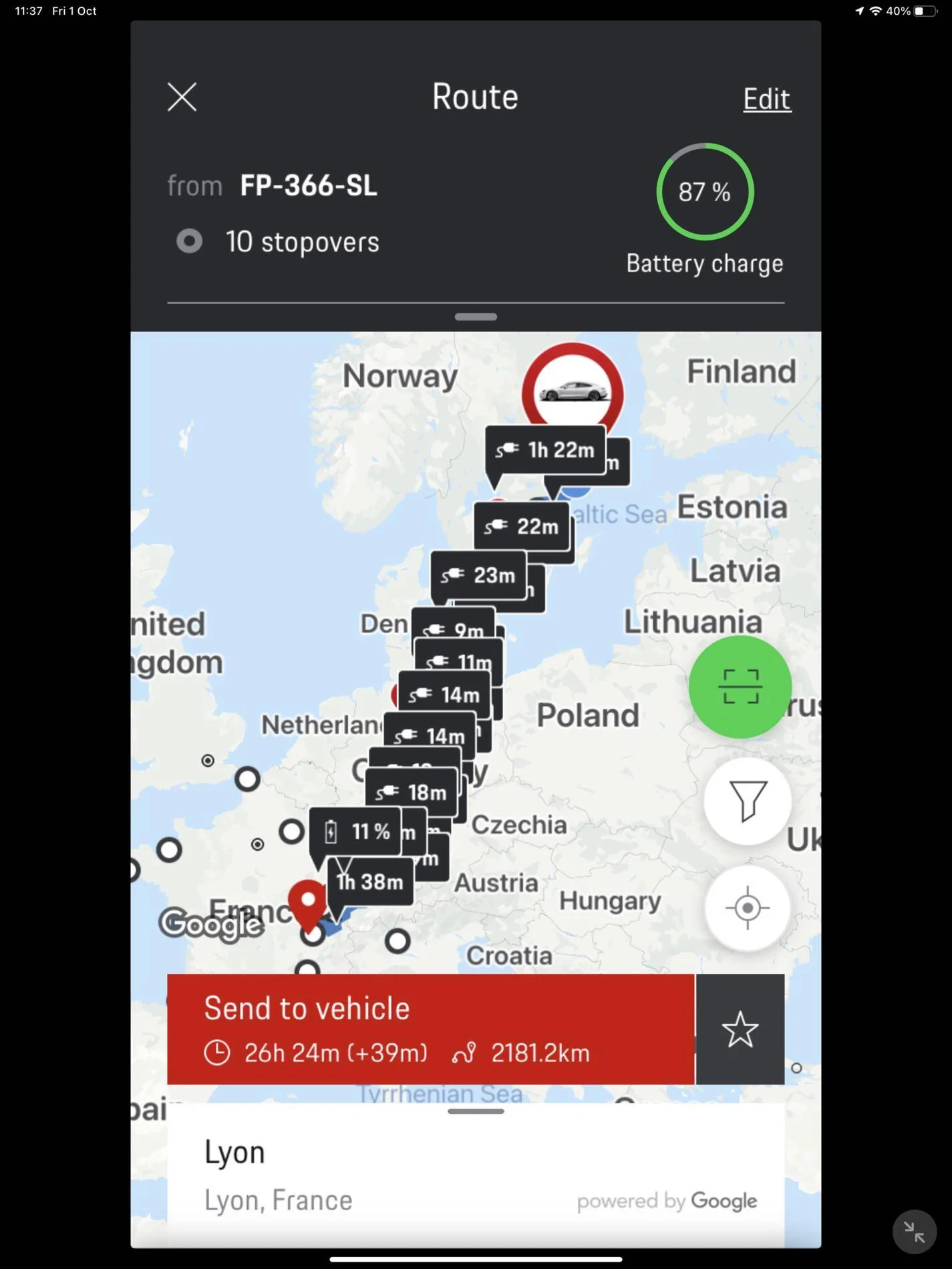

My wife was sceptical about travelling in the Taycan since we have had a number of not so good charging experiences with our Taycan. But agreed to make the trip in the Taycan, when I showed her all the alternatives I tried to plan in for charging stops in case of a charger mishap. We have a slight mobility issue.
I started out by trying to plan the trip with the Connect app, in order to be able to send the route to the car. Not so successful as can be seen in the photo below.
It was not possible to plan the route as we wanted to make.

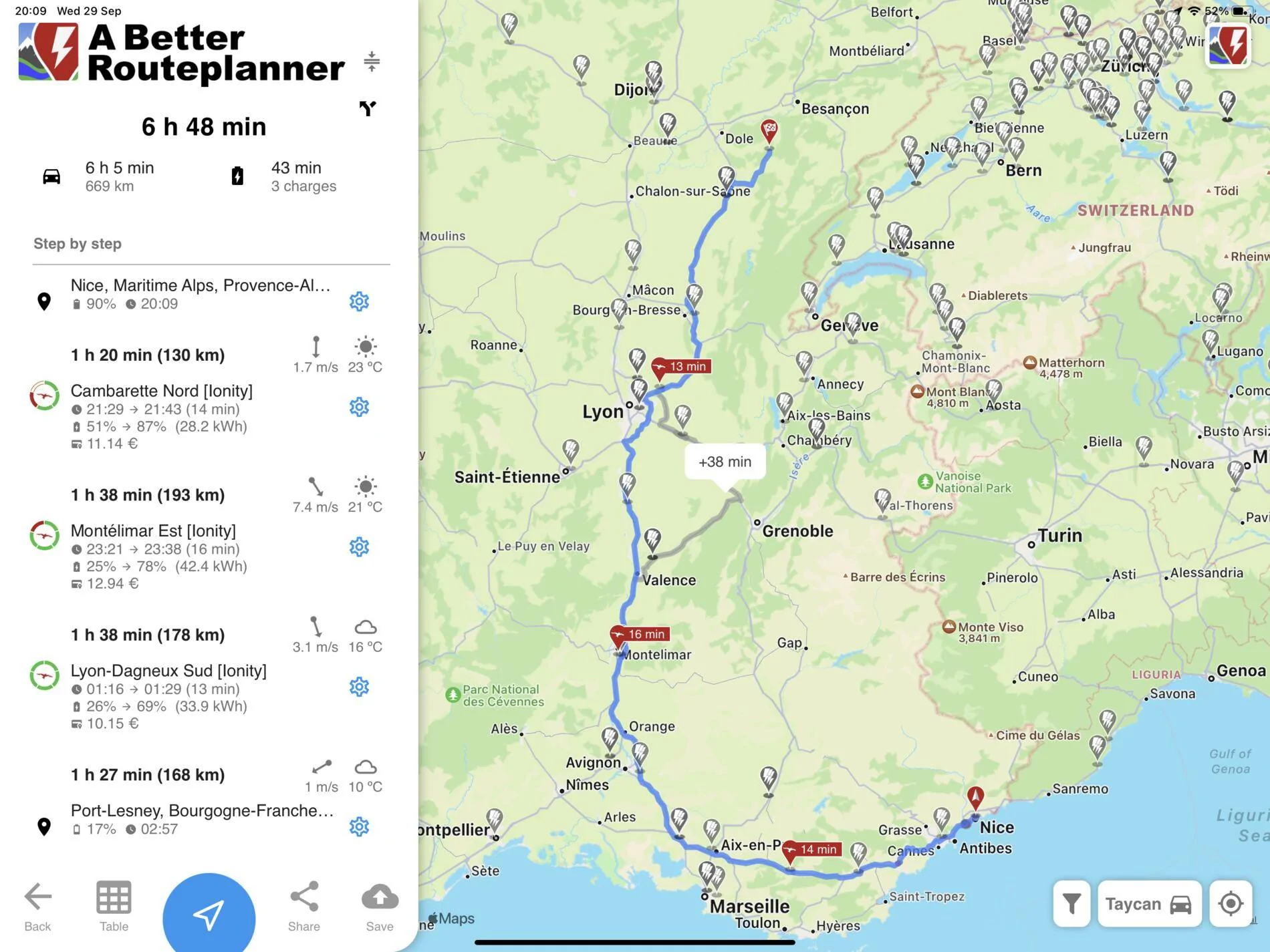

Day one - Nice to Port Lesney, France
The plan for day one was about 670 km. Mostly on French motorways where the speed limit is 130 km/h. It is not a flat drive but has altitudes between 0 and 500 meters at several places. ABRP planned for three stops as the Hotel has some Tesla destination chargers.
Seeing the advice from other contrbutors I added a fourth stop at an Ionity station close to the destination, in case the destination chargers would not be available or not work. So we added a stop ar Aire de Jura .
The Taycan added the same stops in the cars navigator when the hotel address was used. Checked the arrival SOC and suggested times vs ABRP and they were well aligned.
Some traffic on Route yo the first Ionity station and wit the cruise control set at 10% above the speed limit it worked fine. During the first leg I received two map updates. I guess this was due to the fact we had not recently been yo that area and the car probably updates the maps for the area you are entering. Rather then update the whole country or all Europe ar once. I did not use the voice navigation but saw the message flash up on the display and also in Notifications.
Charging at Ionity worked well, even if the Connect app for starting the session required a few attempts.

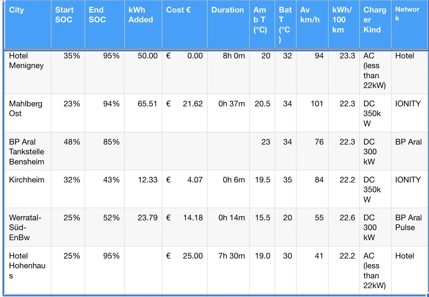

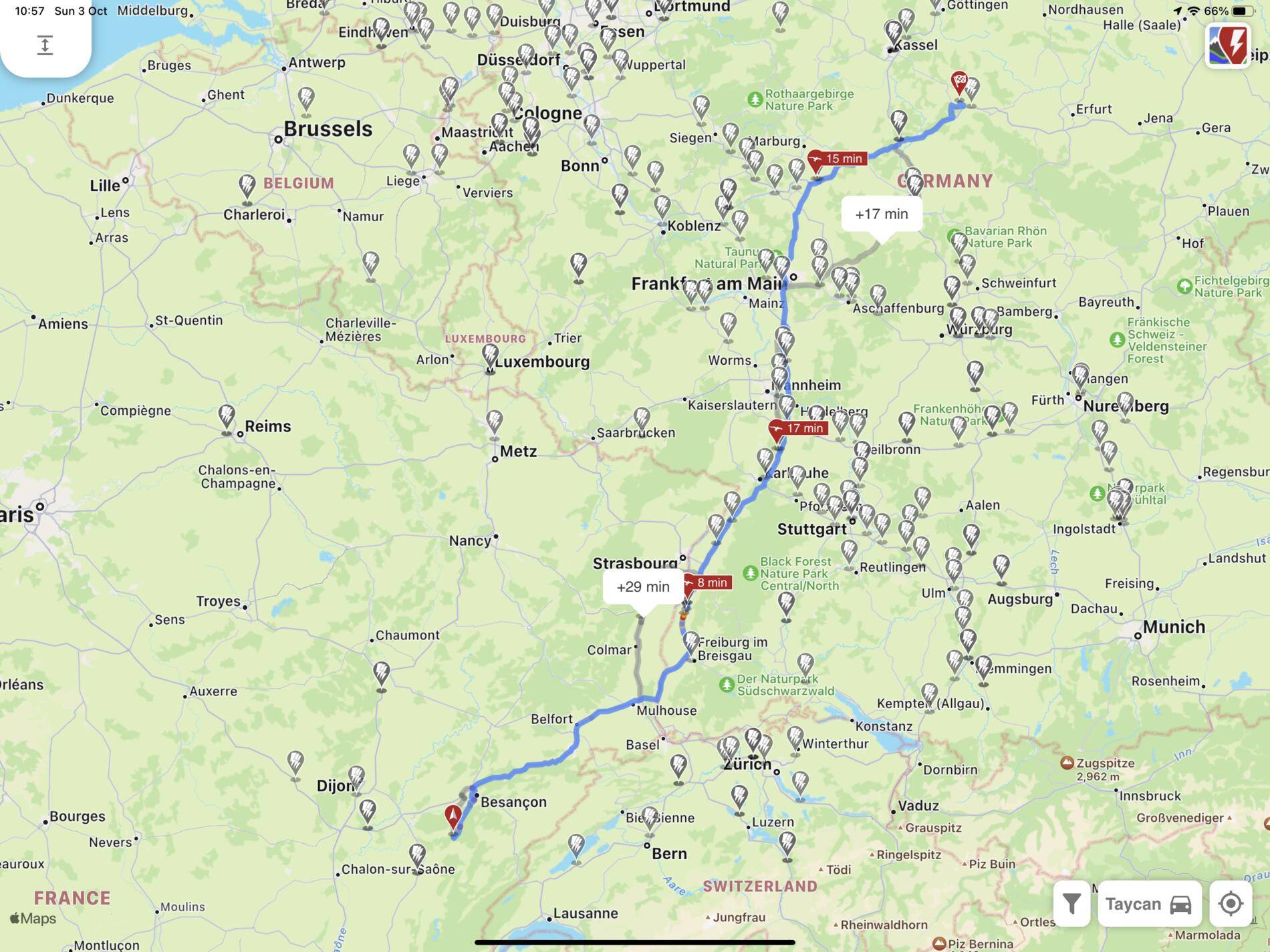

Day 2 - Port Lesney to Hotel Hohenhaus close to Eisenach
Second day was planned to be about 680 km. The Hotel had two Tesla Destination chargers so we charged overnight to 95%.
The above picture shows the difference on build outs of HPC in France (very sparse), Switzerland and Germany. France have a lot of 22 kW and 43 kW chargers but lack chargers above 150 kW.
The day did not start the best with the cars navigation system not having updated traffic information. It took us a route where the road has been closed for the last couple of weeks on the small roads leading to the motorways. From what I could see LTE worked fine and Internet radio played fine? No way to see the status of updates. The first stretch would be a longer one, about 265 km.
No problems at all to reach first charging stop with plenty of charge to spare.
Once in Germany we lost LTE connection and could not get the car to reconnect to the network. Tried two finger reset several times, but no improvement.
The issue with this was that our map updates where not delivered and also no traffic information. We were now in Stauland and the amount of traffic jams were unbelievable. The German Autobahn have No Speed Limit in some areas, but the overall average speed was much lower than in France.
Taycan drove fantastic though. When possible the speed went up to 200 km/h and the car is completely stablle and seems to be glued to the road. Felt extremely safe and planted at the high speed when possible and safe to do.

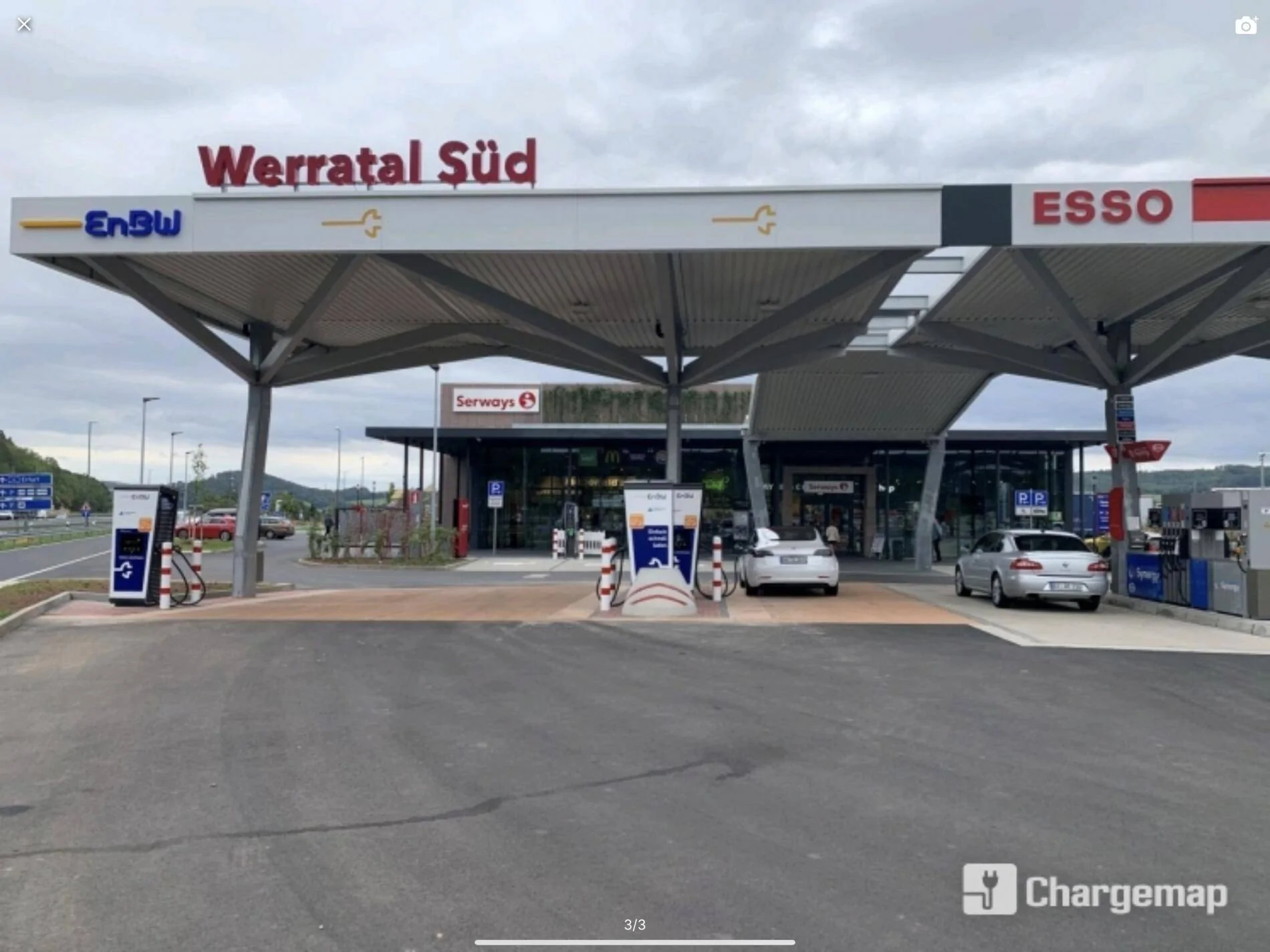

As can be viewed from the plan there are many different charging networks with HPC chargers at more than 300 kW, not just Ionity. We passed by many petrol stations that were marked as in the photo below.

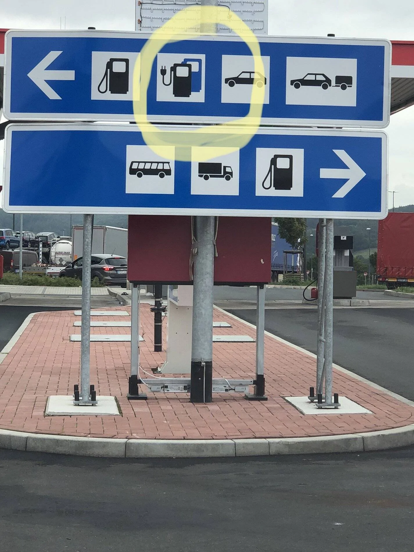

Same symbol as the car shows when getting low on charge. From what I understood they call these E-tankstelle. Then people directed you to a charger.
Some stations had a combined layout with both Petrol Pumps and Electron Pumps. The nice thing was that windscreen cleaning buckets were provided at many of the HPC.
Unfortunately I have dropped my phone when packing the car at home and my camera is completely broken as well as the screen, so some pictures are from Chargemap.

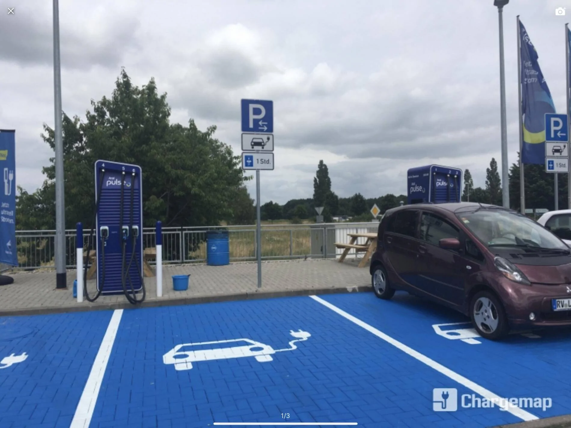

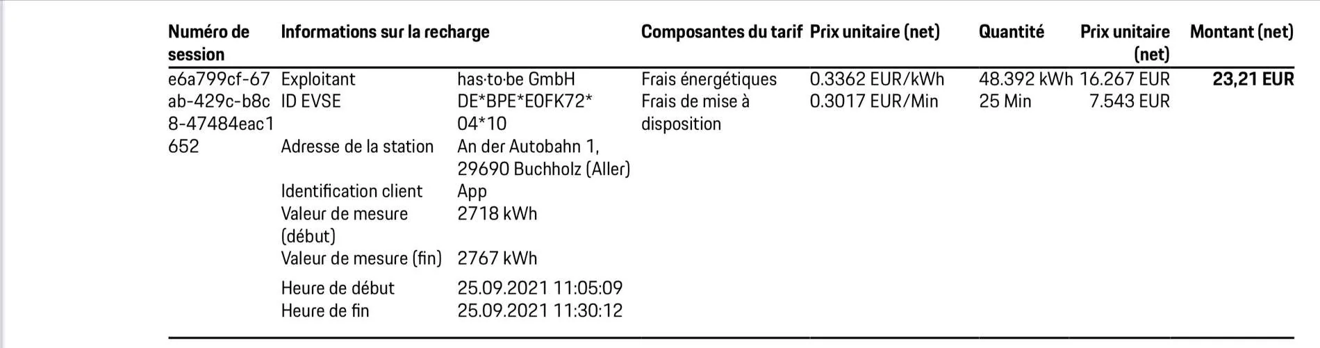

We charged at several of the BP/Aral Pulse stations and providers were EnBW, has to be GmbH, EWE Go etc, and all worked first attempt and with as much power as the car could take..
Outside of the Ionity network there is however a charge also time based and not just kWh based? I did not realise that at the time. I guess this is to discourage cars like BMW i3 and others that only charge at 50 kW, to use these stations.
Price show is ex VAT 20%. Still significantly cheaper than an ICE car.
Overall very impressed with the charging experience driving through Germany. Plenty of chargers, no waiting times and the chargers all worked and delivered the promised power.

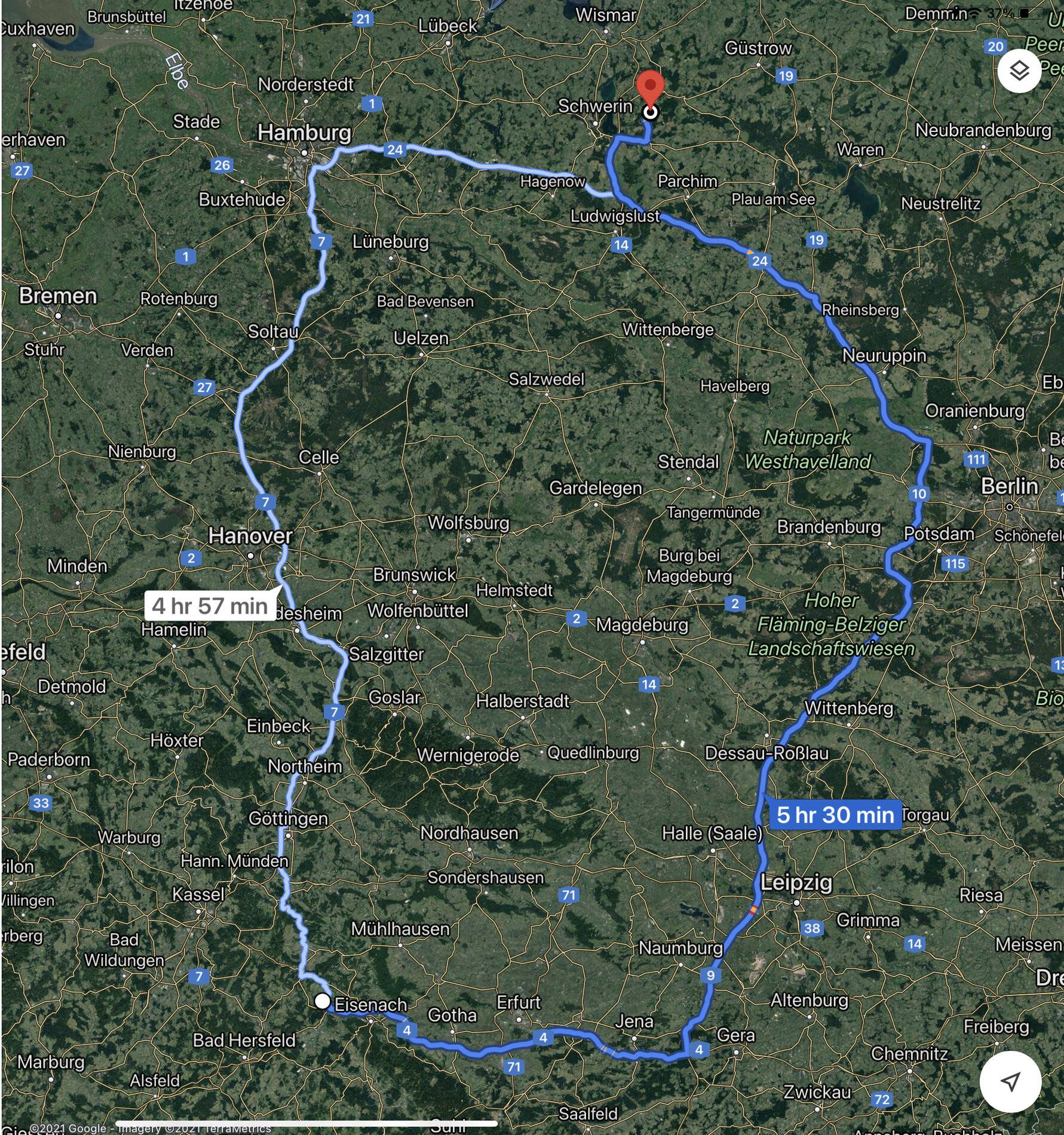

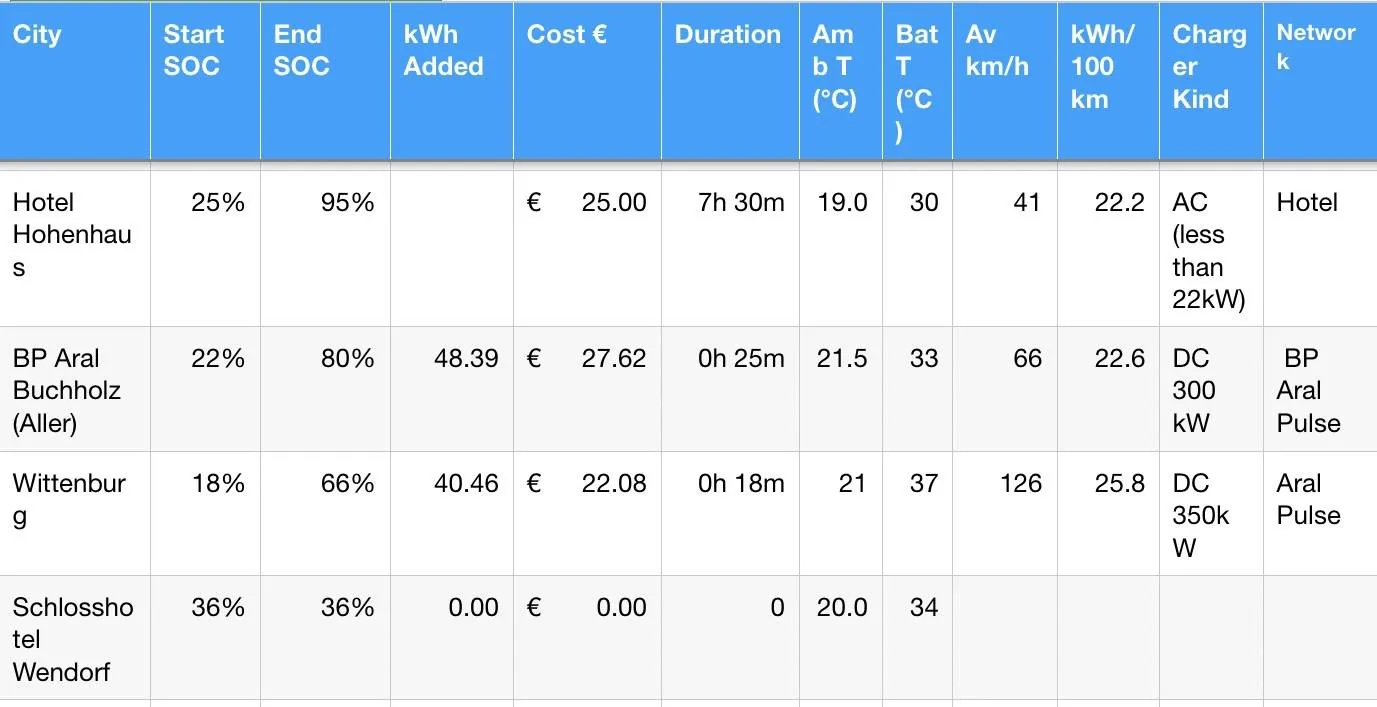

Day 3 - Hotel Hohenhaus to Schlosshotel Wendorf
This day the route was planned to pass by Leipzig, where Porsche produce the Macan and Panamera. They also have a Kundendienst and some track experience events here. There are pictures of lots of Porsche chargers shown here as well. Looked like a nice place to visit. Some friends also had advised to travel through what was the former Eastern Germany, rather than the normal route. The roads they said were much nicer and better. It was not the fastest route according to Google maps shown blow. The distance is about 550 km and should take some five and a half hours driving plus charging and biological breaks.
With a 95% charge from the hotels Tesla destination charger we set off. Shortly after this we received the ever annoying map updates, despite having driven around this area for a full day. And with the map update came the compulsory changed route planning with charging stops added. A voice message also announced that due to traffic situation and road closure, the route was changed and now we were heading for Hanover instead!!!???? We are not familiar with the roads in this part of Germany at all. But being in Grermany in a German car and a map system owned by a number of German car manufacturers (HERE) I decided to let the car navigate.
It was difficult to check in the navigator and also with Google maps what the real situation was so we choose to take the car navigation advice. Probably a BIG mistake.
Some 60 km along the Route and a new Map Update etc etc, it was announced “” Due to Traffic situation and Road closure it was not possible to navigate the route. No alternative route is recommended””. Very confusing message, should we really continue or turn once again?? It was Saturday and there seemed to be much less heavy goods traffic on the roads than in the week, so we decided to skip the car navigator and use Google maps via CarPlay. Google quickly established
a possible route. Seemed everybody else decided on the same route as well. And then the traffic from the Autobahn was diverted off the motorway and onto the same small country road. Cosy? STAU and very slow.
The first part of the trip took a long long time even if the average speed looked ok. But the car was switched off for a lot of time at total standstill and lunch etc.
The two charging stops went to plan and both chargers performed perfectly. The Pulse Chargers were very appreciated. No issue in connecting and starting the charge, and providing up to 300 kW power. Absolutely superb. As stated before there is also charge per minute at these chargers so it works out at 0.55 Euro per kWh against Ionity at 0.33 Euro.

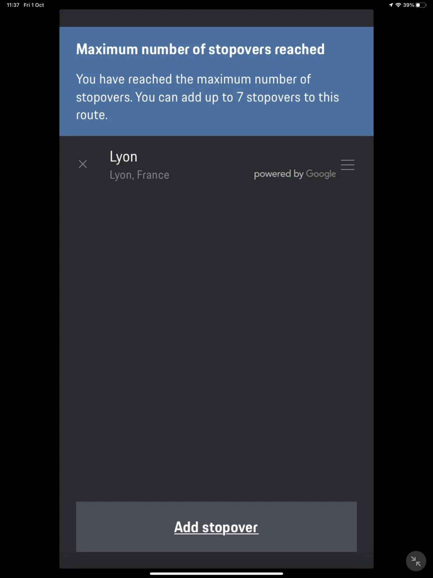

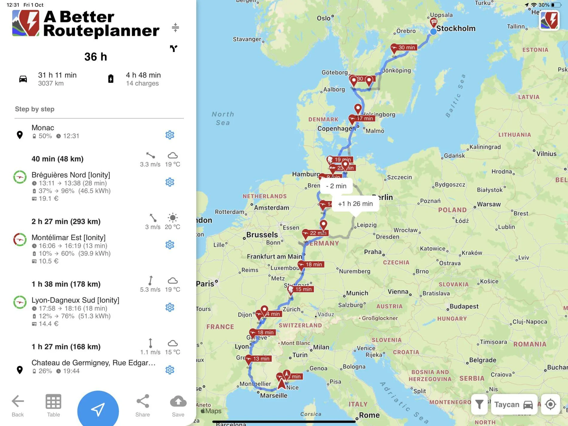

i have a 4S and we have a house in the uk and one in Meribel in France - a roughly 700 mile/1120km journey, generally on excellent French autoroutes.
i have not yet done this journey but i have tried to programme it into the car system. It rapidly became apparent that the in car system is woeful and better to use something like A Better Route Planner possibly in conjunction with the in car system by just putting in the next charge stop. I subsequently had the following conversation with the dealership:
“There is an Ionity charging station in France called L’isle-D’Abeau. Why wont the in car system pick up this Ionity station in France? I have tried multiple ways to get it to recognise the charge station or even the garage where it is – Its on the motorway but it does not.
Second when I programme Tatsfield to Meribel Village into the car system the best it can produce is a journey plan with some unacceptably long recharging stops en route and a total nearly 16 hour journey.
So i turned to A Better Route Planner for the same journey. [ ABRP map and Table given to the dealership]. Note that the total stops for top ups are 91 minutes which is less than one single stop given by the incar system. a journey of about 12 hours - 4 hours less than the in car system.
I have researched this quite a bit and come to the conclusion that the onboard nav planner is woefully bad. It almost beggars belief that Porsche can be responsible for something that is so third rate and doesn’t appear to recognise even its own linked charging stations eg Ionity. Unlike petrol cars planning for long journeys is key in evs and this just does not appear to be close to an acceptable standard”
no proper answer yet….i told them to consult Porsche UK…
