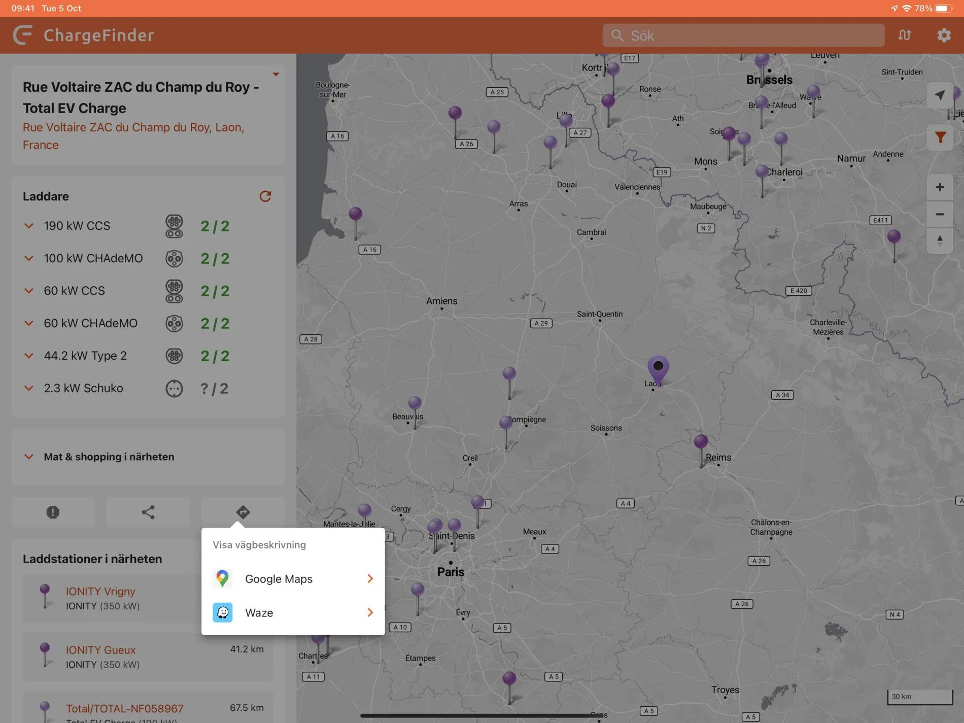

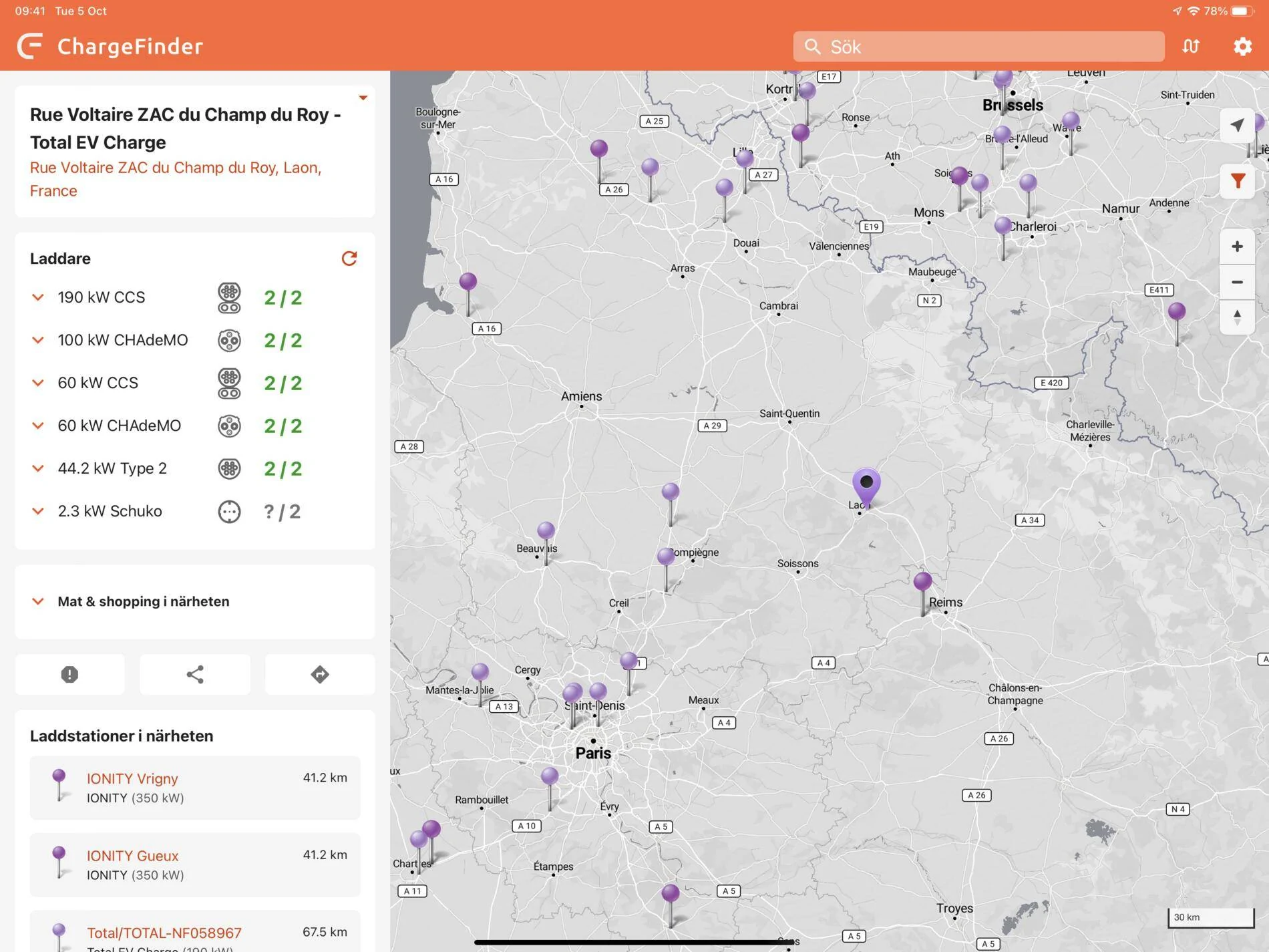

Getting used to working with a good search tool, like Charge Finder, PlugShare, Chargemap etc is essential.
I have found that Charge finder works excellent in Germany, Denmark and Sweden. It looks to work great in France too, but I have not tried it there. Charge Finder is easy to use and the best of it is that you by one click transfer the destination to Waze or Google Maps, which then can be used in the car via CarPlay! I lost the cars ability to precondition the battery, but on a long trip it works anyhow and it is not too cold now. Or just drive in Sport Plus mode, that will ondition the battery nicely.
Here are a few screens with the filter set at chargers with 100 to 250 kW! Sparse in France but plenty in Belgium.

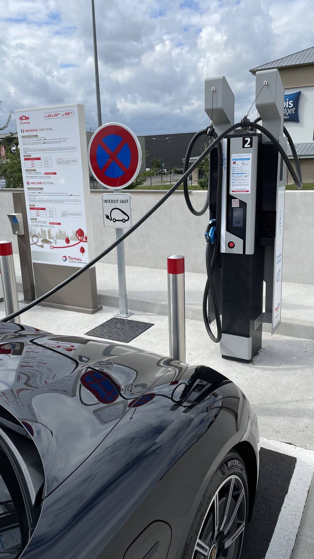

I had Porsche Charging Planner send me to 175 kW Total chargers on a earlier French roadtrip (with loaner Taycan) and they worked well. Usually two chargers – so not as good as Ionity – but I am happy to include Total in my French trip planning.

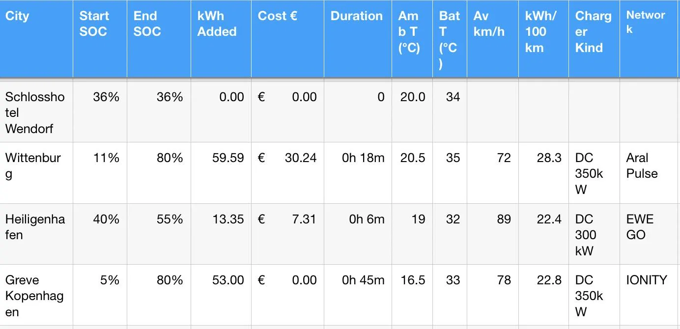

Day 4 Hotel Wendorf to Helsingör

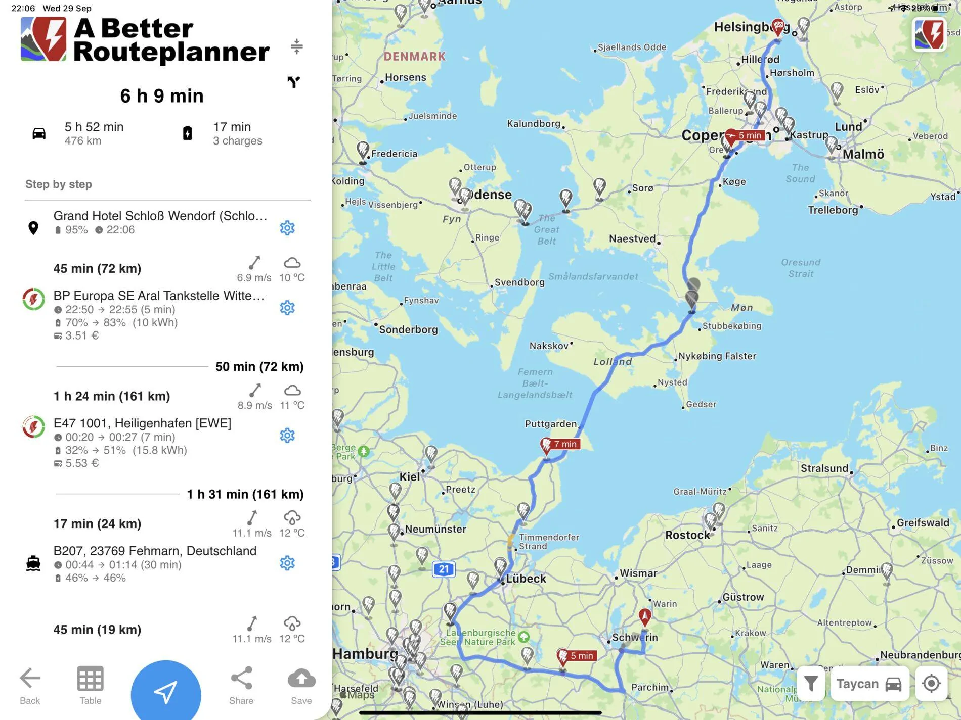

Since we could not get any charge at the Hotel, due to me not bringing the Brick PMCC, we planned to return to Wittenburg and charge up. There were a few more chargers on a more northern route but not from a known network, so did not feel right. They might well have worked but I could not find any info online.
The plan was then to take the ferry from Puttgarden to Rødby in Denmark. This ferries take ca 45 minutes and run very often. We charged a bit more at Heligenhafen on a fairly new installation it seemed, by EWE go. Two chargers with 4 connectors. Worked quickly with absolutely no issues. We aimed for the Ionity station at Greve just south of Vopenhagen for a longer charge. I had heard about this station from a number of friends that have used it as well as from the internet.
Destination and charging stops in the navigator checked before before taking off. However the obligatory Map update came twice en route, once in Germany and once in Denmark.

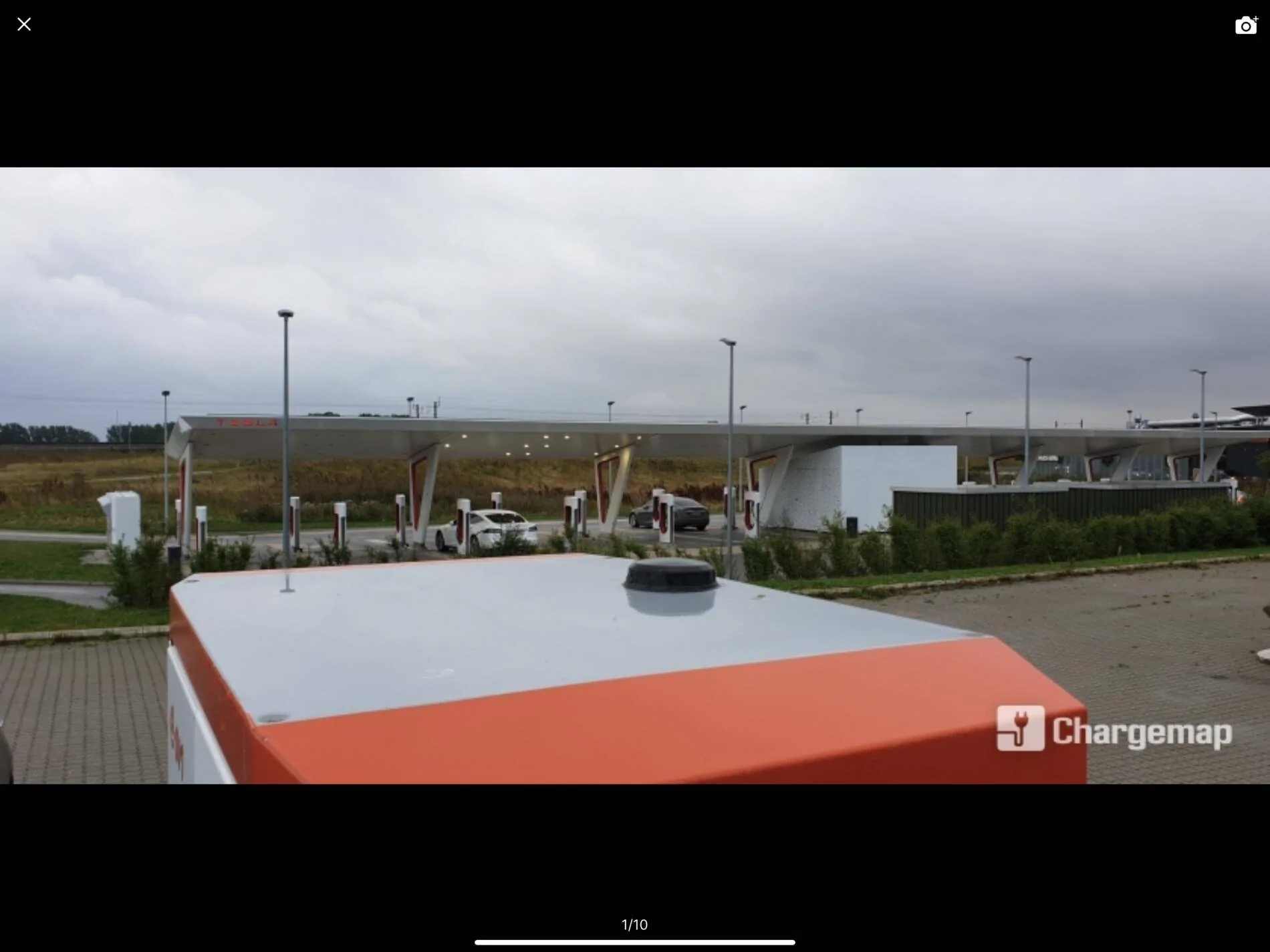

Driving towards Copenhagen on fairly quiet Sunday roads in Denmark, we followed the advice of the navigator. Turned off the motorway and followed the map. Could not find any Ionity stations, but found a huge Tesla charging stop.
Think there were some 26 Tesla Superchargers. Massive place.
A bit of concern now since we only had some 8% charge and 26 km range left.

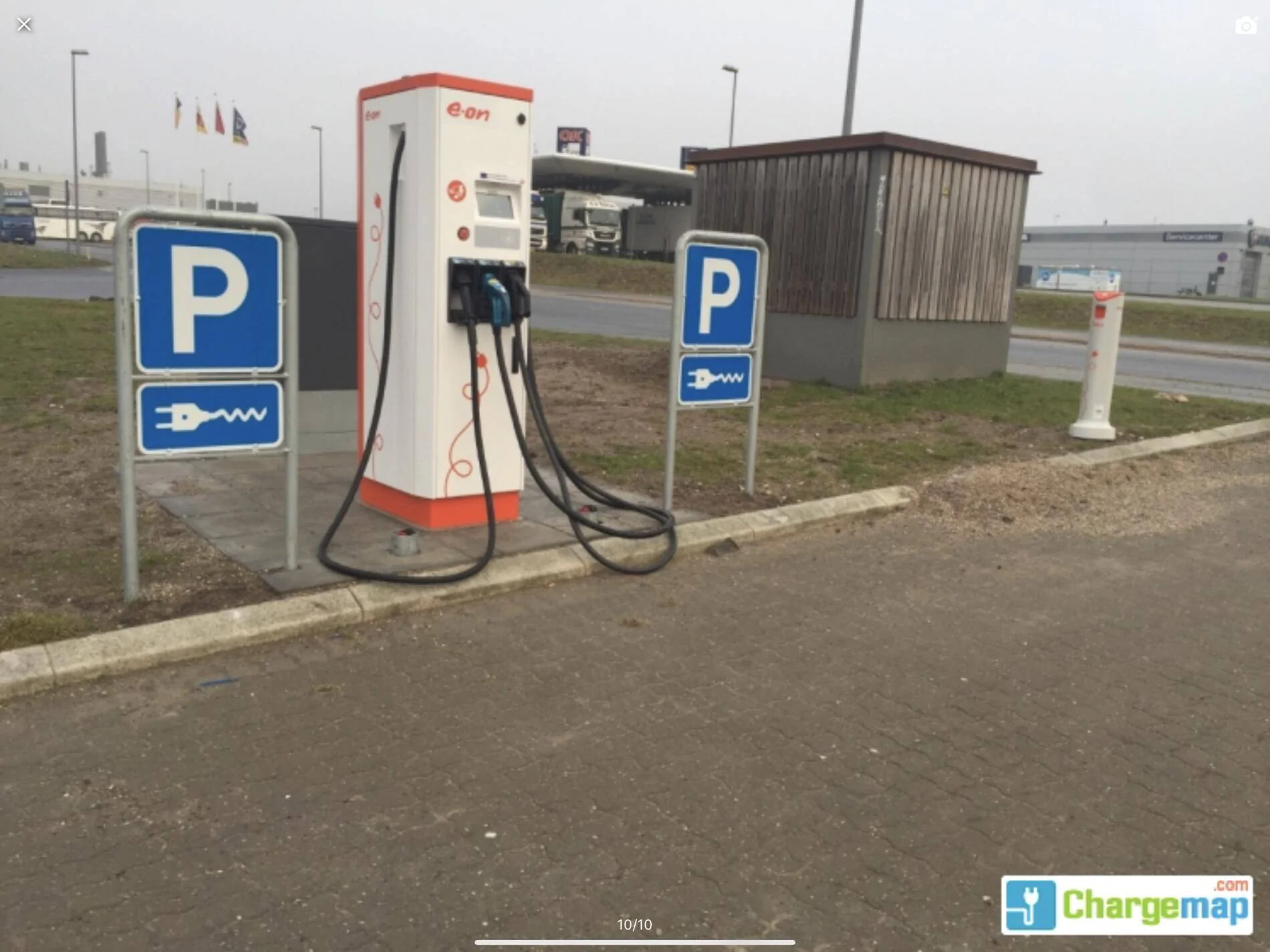

Driving around we then found the charger the car directed us to. An occupied single 50 kW charger. And a car that used CHAdeMO connector was charging and had some 25 minutes left.
The charger actually has three cables AC, CHAdeMO and CCS, but can only serve one car at a time.
Why oh why, can we not have a filter yo avoid slow chargers.
Surprise surprise, the navigator had actually changed my stop, which I should have noticed by checking in more detail. Programming in the correct Ionity charger, it showed we could make it. Traffic had started to build with people returning to Copenhagen, so speed would also be reduced. As long as there were no major stops we would be fine. The cars range indicator when navigating to a destination had so far been spot on, if not conservative.

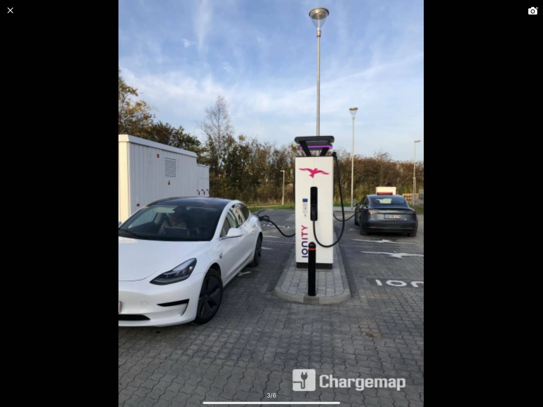

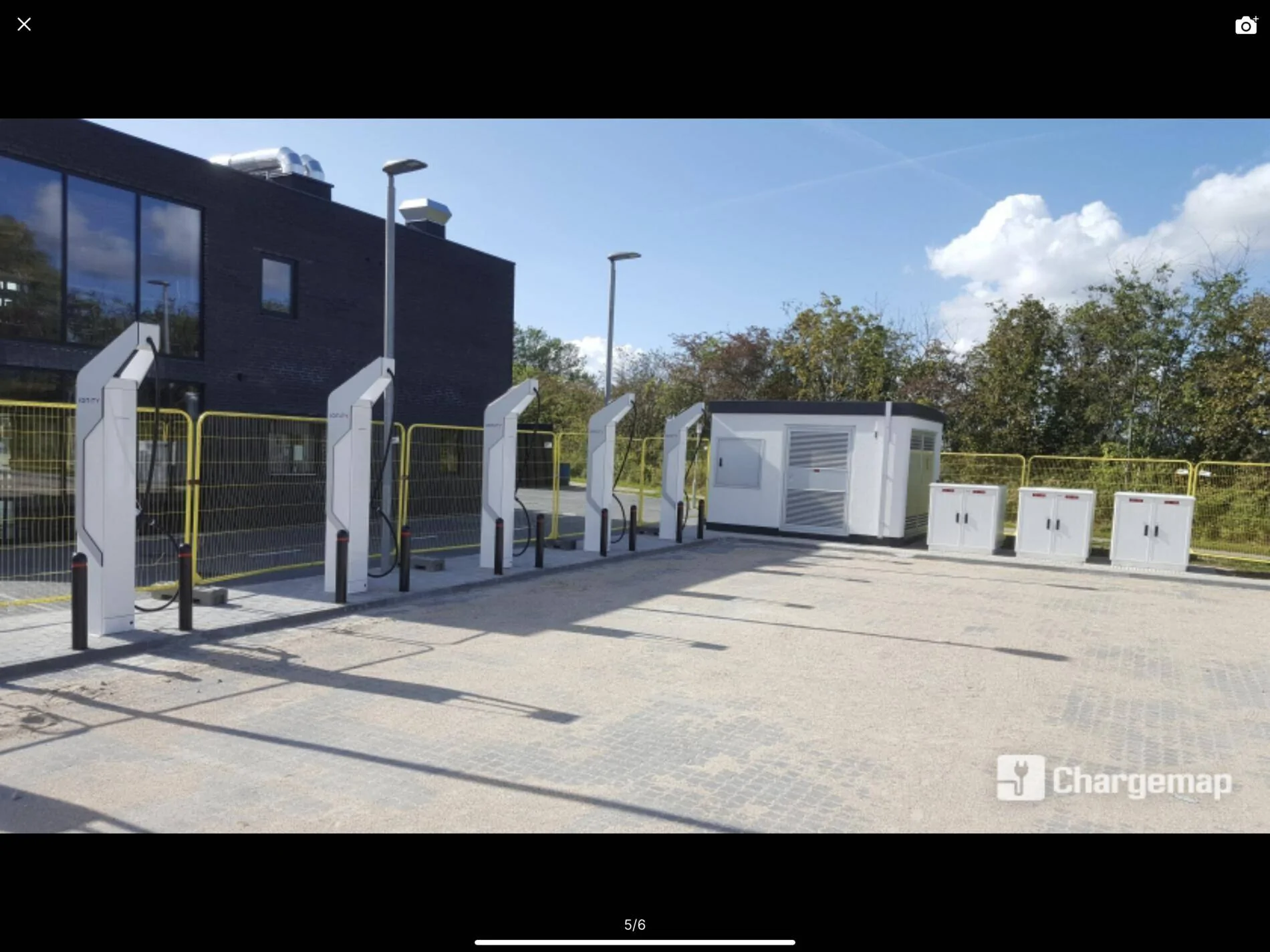

Ionity Greve was reached wit 5% charge left. The station has 6 new chargers and 4 older type chargers.
An Audi was charging at the new type and three of the older type chargers were occupied.
Connected to the charger two chargers down from the Audi and started charging. Two minutes charge and the red light. Restarted wit the same result! The driver of the Audi came over and told me he had changed when a spot became free to the old charger type. He would only get 3 kW else.
Long phone call with a very helpful staff at Ionity as we tried 4 more of the chargers. All with the same result. And there were no fault indication at Ionity helpline either. They reset one charger after the other but no success.
At this stage a Taxi had parked between the two free chargers of the old type and refused to move his car so I could reach a free station. Tried several times and when some danish people also asked him he got all upset and left throwing the main connector on the ground? That connector than also would not give any charge and now stress levels with my wife had increased. A
Ionity finally managed to restart the charger and we got all the juice we wanted. And no charge from Ionity either.
Two further cars arrived at the troubled new chargers, connected, hot the green light to shine, went for a burger and the red light showed. They were probably not too happy when they returned either.
This was our first and only mishap at a HPC on the whole trip. Something was not right there that day, but I have seen positive reports from the station later, so unusual for them I think.

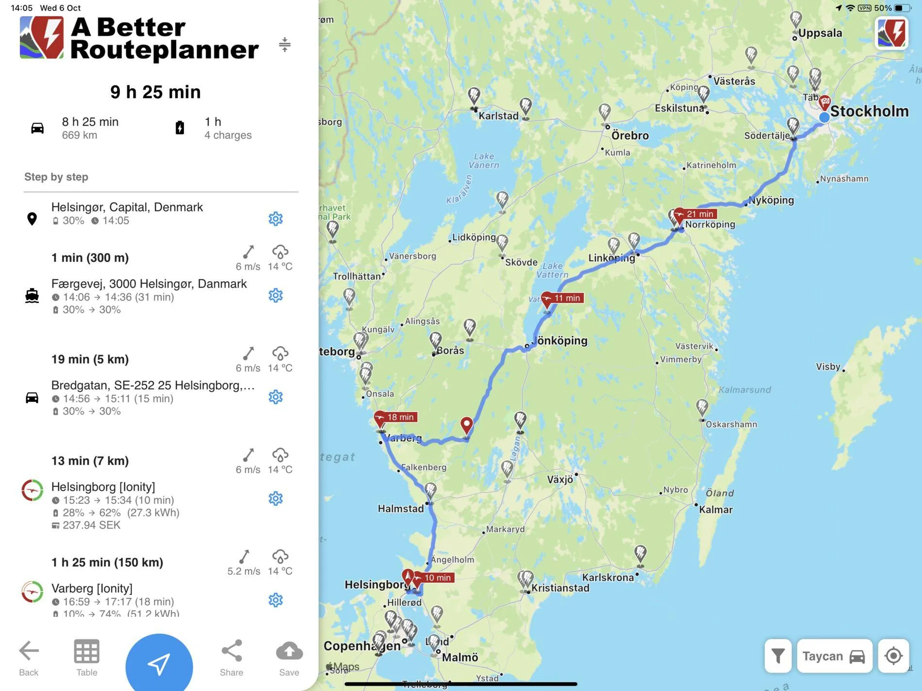

We aimed to arrive in Stockholm and this time made sue we programmed the destination to each Ionity station rather than the overall destination. I guess the car would have added necessary extra charging stops if required.
The charging stops all worked as well as we have become used to from Ionity. No problems or issues at all. We have used the Charging Card for most of the stops since that is much quicker and more practical than using the app.
I was a bit surprised by the location of the Ionity station north of Jönköping (Gränna). This was a Circle K, but not a very clean facility and only fast food. There was a closed restaurant in the same building.
Our final destination was at a 50 kW charger close to where we were staying and we needed to top up for use of the car in the evening. We easily found the charger in the navigators map and set it for the last leg.
On this leg we had the worst weather we have had on the trip. At times torrential rain and the temperature dropped to around 12 degrees C. Normally when we have done this stretch in an ICE car, the consumption has dropped significantly. In large part due to the lower speed limits in Sweden and few if any traffic jams. Not so with the Taycan. Our consumption increased quite a bit. I guess heater, window wipers, and headlights all contributed to the effect. And the road surface on the Swedish roads was much coarser than we had on all the journey. The car also had much increased road noise in the cabin, that normally is very quiet.
Our plan for the evening was slightly scuppered though as the car navigated us to our charging station. See below.
