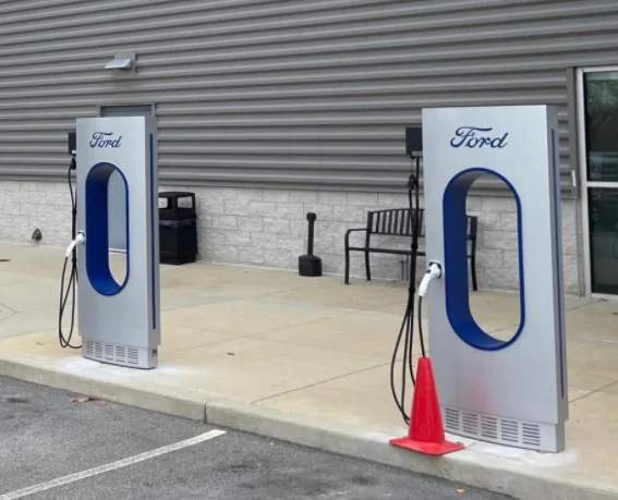

1- The traditional OEMs actively market their slow-ass DC speeds as "super fast charging". If you're not careful about following the industry, I think you can be forgiven for thinking your brand spanking new ID.4 probably has the newest and greatest tech. If they were honest, VW and Ford would put a clear spec on there, and also have a sticker on the charge port (ONLY 150KW). They could make this much better, but they are IMHO actively obfuscating.
2- Ford and others are advertising the weird bundling of multiple third party networks as their own pseudo network. (FordPass charging network). That's just disingenuous and adds to confusion. Then they build L2 chargers that look like tesla L3 chargers, etc. I mean, look at this:
Porsche Taycan Trip Report: Los Angeles (Beverly Hills) to SF Bay Area (San Mateo) Screen Shot 2021-11-27 at 9.44.08 AM
3- Their support numbers don't understand EVs - at all.
