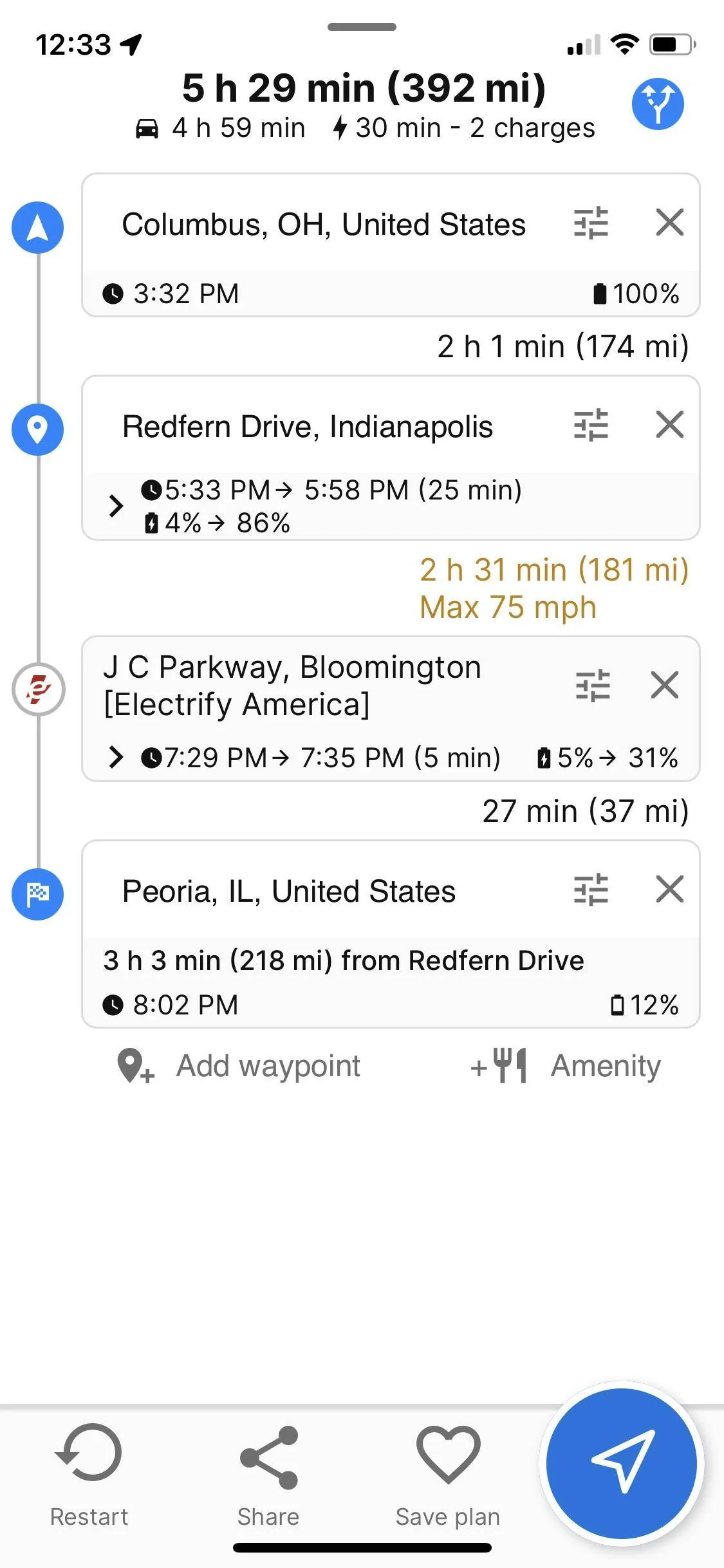

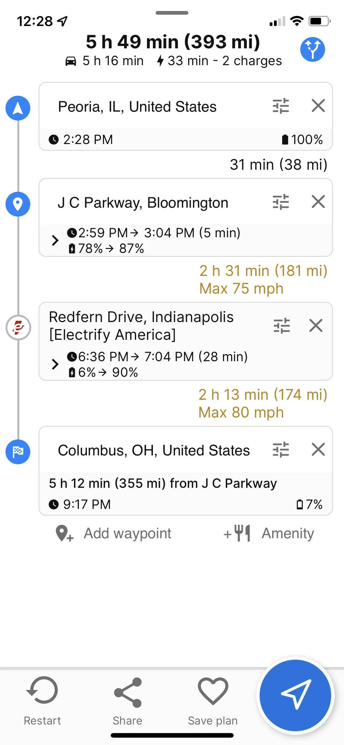

bsclywilly
Aug 13, 2021
625
1,048
San Jose
CT4
Was curious how your experience was so bad so I mapped your trip in ABRP based on your usage.
I bet you could make both trips easily under 6 hours. The problem is Porsche’s charging planner, nav, and PIRM are really bad at planning and mapping.
This look familiar for your outbound trip? I set the ref consumption at 275 and ref speed at 140%.
Porsche Taycan Trip Report: my first relative long distance trip - about 350 miles DD0F4AA1-314E-468A-AD26-3466092D6421
Using the same settings you should be able to get a return trip like below:
Porsche Taycan Trip Report: my first relative long distance trip - about 350 miles E2BE4CDF-49C5-4007-A33A-59EE0D938C3B
You do need to mind your speed on certain legs since there are big gaps between charging stations.
I find using Porsche nav just to keep tabs on arrival SoC is all it’s good for. Disable PIRM and charge planner. Also, if you do use the charge planner or PIRM make sure your target arrival SoC is set low enough, say 5% so it doesn’t try to route you unnecessarily.
