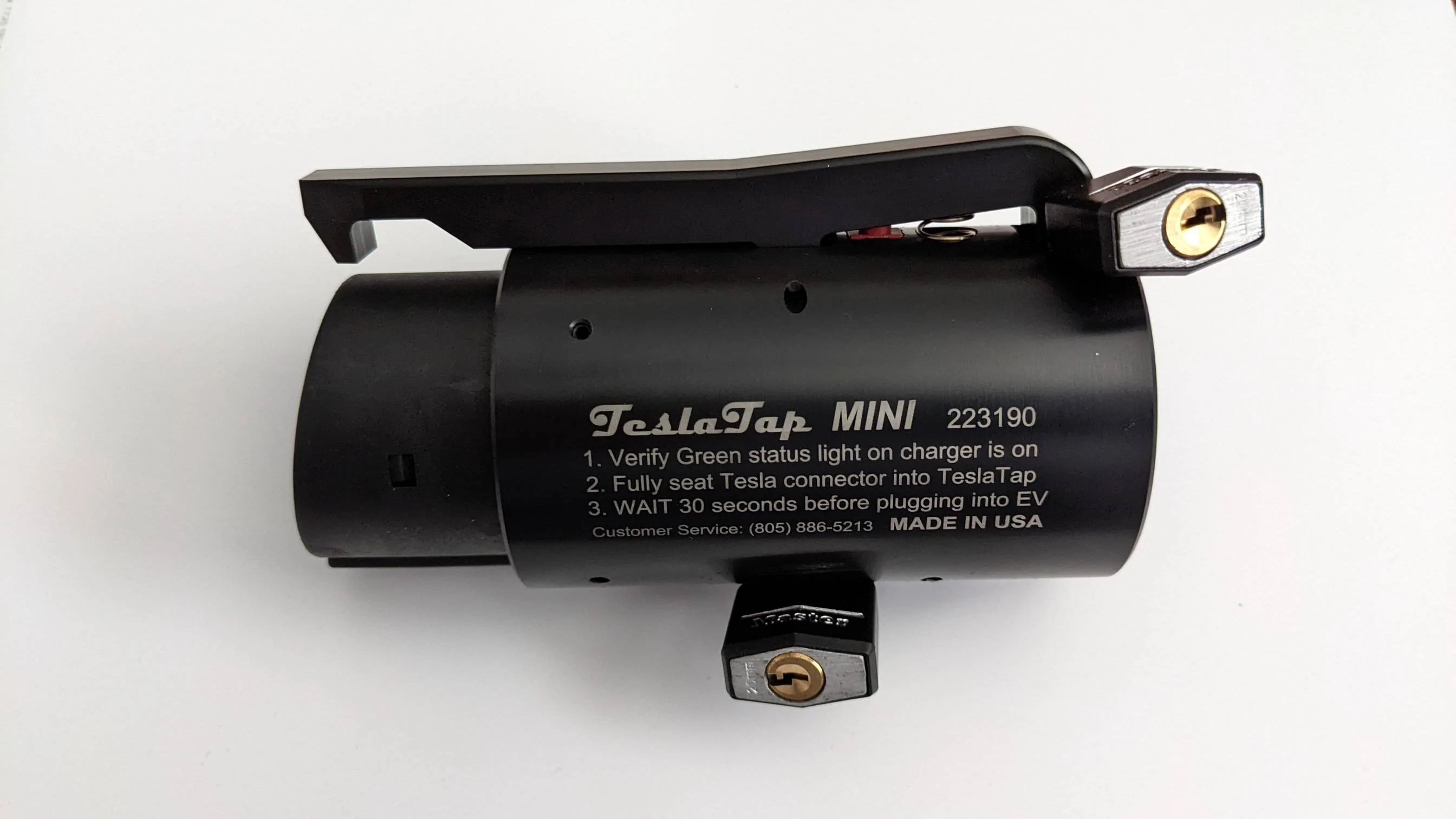

the standard Taycan comes with a 48 amp AC L2 onboard charger - if you use this at a Tesla Destination charger that can charge at 40 or 48 amps you may melt/overwhelm a the adapter if it’s only rated for 32 amp charging load…
personally I prefer the teslaTap 60 amp charger (80 amp if you have the optional north american 19.2 kW onboard charging options) and the design has a flexible cable which means it sticks out less when plugged into the car, is flexible, and does not have all this weight extending out from the vehicle which adds “ft/lbs” of torque to the weight of the charging cable…
if your using that adatper at a Hotel or business with a 60 amp Tesla Charger (there are lot of them) I’d monitor the adapter to make sure it does not overheat.

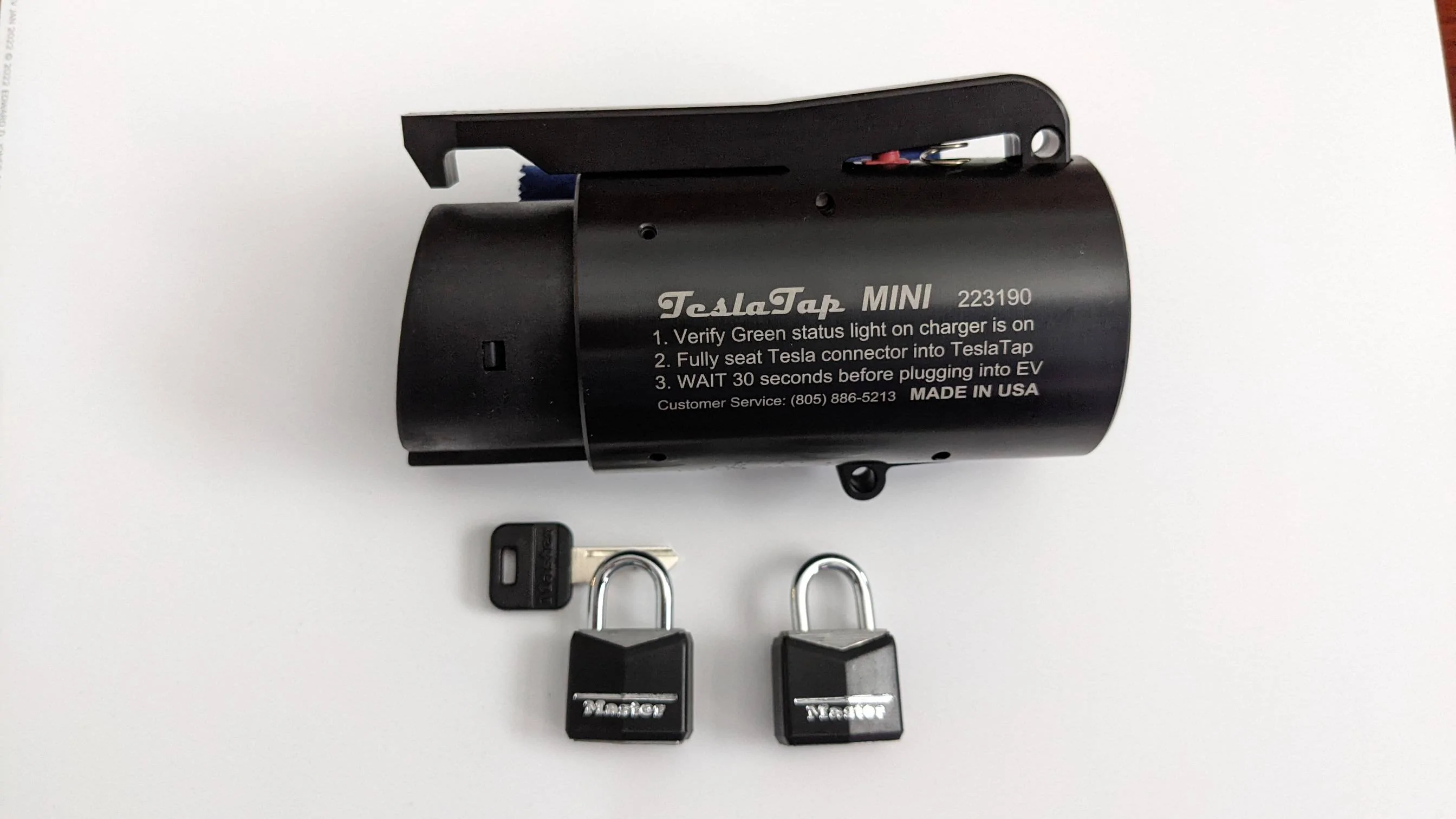

yes the Tesla MCC (Tesla Universal Mobile Charger gen2) that is standard with the Model Y is a 32 amp EVSE that plugs into NEMA 14-50 outlet - any TeslaTap with the Tesla UMC will charge your Taycan just fine.
if all you ever used was your Model Y's charger you do not need the 80 amp Tesla Tap (the Model Y UMC gen 2 is a 32 amp charger) - you get the 80 amp Tesla Tap so that when you encounter other Tesla Wall Chargers that may be 60/70/80 amp EVSE's you don't "melt" the TeslaTap while charging your Taycan.
You can charge your Taycan with a Tesla Mobile Charger (Gen1 or Gen2) or Tesla Wall Charger (gen1, gen2, gen3) with a TeslaTap - TeslaTap are _NOT_ for Tesla Superchargers and simply won't work -not to mention they don't even connect to the FastDC input pins on any CCS vehicle including the Taycan.
if you have a standard Taycan all you need is a 60 amp TeslaTap to handle the Taycan's maximum 11 kW load and not melt the TeslaTap…
if you have the optional 19.2 kW North American charging option you should have an 80 amp TeslaTap since if you encounter a 19.2 kW Tesla Wall Charger Gen1/Gen2 you'll need the extra beefy capacity of the 80 amp model to handle the charging load and not melt/short/fault during longer charging sessions.
NOTE: TeslaTaps are _NOT_ active adapters they are passive "pass-through devices" - a 32 amp TeslaTap does _NOT_ limit your charging session to 32 amps - the amp rating for a TeslaTap is an indication of how robust the the connectors/wire-gauge is inside the TeslaTap to handle greater powerflow/electrical-current during higher capacity charging session. You can use a 32 amp TeslaTap w/19.2 kW Tesla Wall Charger gen2 and a 19.2 kW Taycan and when you plug in the Taycan and the Wall charger will happily charge at 19.2 kW (80 amps) - but OMG - not so sure the 32 amp TeslaTap will last without melting/shorting/faulting with actual potential fire risk and potential damage to your charging port when the plastic on the TeslaTap melts due to overheating…TeslaTap's are a mostly passive adatper that simply lets the power flow from one side of the adapter to the other - given the amount of power that can flow it's important to puchase a Tap that is beefy/robust enough to handle your Taycan's maximum power flow (48 amps for standard Taycan, 80 amps for a 19.2 kW Taycan)
TeslaTap does NOT control the charging session - it's simply "patches" the wires between the two separate connector shapes so that the Taycan can "talk" to the Tesla EVSE and vice versa - the TeslaTap lets a 19.2kW/80amp Taycan "talk" to a 19.2kW/80amp Tesla gen2 Wall Charger - and if the Taycan and Tesla charger agree 80 amps is a good idea - they will then happily begin pushing 80amps of power over your 32 amp TeslaTap - it will actually most likely and physically "melt" after more than 30 minutes of this type of electrical load and is actually physically dangerous because once it starts melting it could cause an electrical short and potentially a fire (although the EVSE should cut out the power flow once connections start to get flaky but who knows what will fail first when stuff like this starts happening).
TeslaTap works great with any non-supercharger Tesla EVSE (charger) - just get one beefy enough not to melt based on your Taycan's charging abilities - either 60/48 amps or 100/80 amps. That way it won't melt when you're charging at some random Tesla Destination Charger like Seascape Resort in Aptos, CA that actually provides 19.2 kW Tesla Gen1 Wall Chargers to their customers.
NOTE: TeslaTaps are _NOT_ active adapters they are passive "pass-through devices" - a 32 amp TeslaTap does _NOT_ limit your charging session to 32 amps - the amp rating for a TeslaTap is an indication of how robust the the connectors/wire-gauge is inside the TeslaTap to handle greater powerflow/electrical-current during higher capacity charging session. You can use a 32 amp TeslaTap w/19.2 kW Tesla Wall Charger gen2 and a 19.2 kW Taycan and when you plug in the Taycan and the Wall charger will happily charge at 19.2 kW (80 amps) - but OMG - not so sure the 32 amp TeslaTap will last without melting/shorting/faulting with actual potential fire risk and potential damage to your charging port when the plastic on the TeslaTap melts due to overheating…TeslaTap's are a mostly passive adatper that simply lets the power flow from one side to the other - given the amount of power that can flow it's important to puchase a Tap that is beefy/robust enough to handle your Taycan's maximum power flow (48 amps for standard Taycan, 80 amps for a 19.2 kW Taycan)

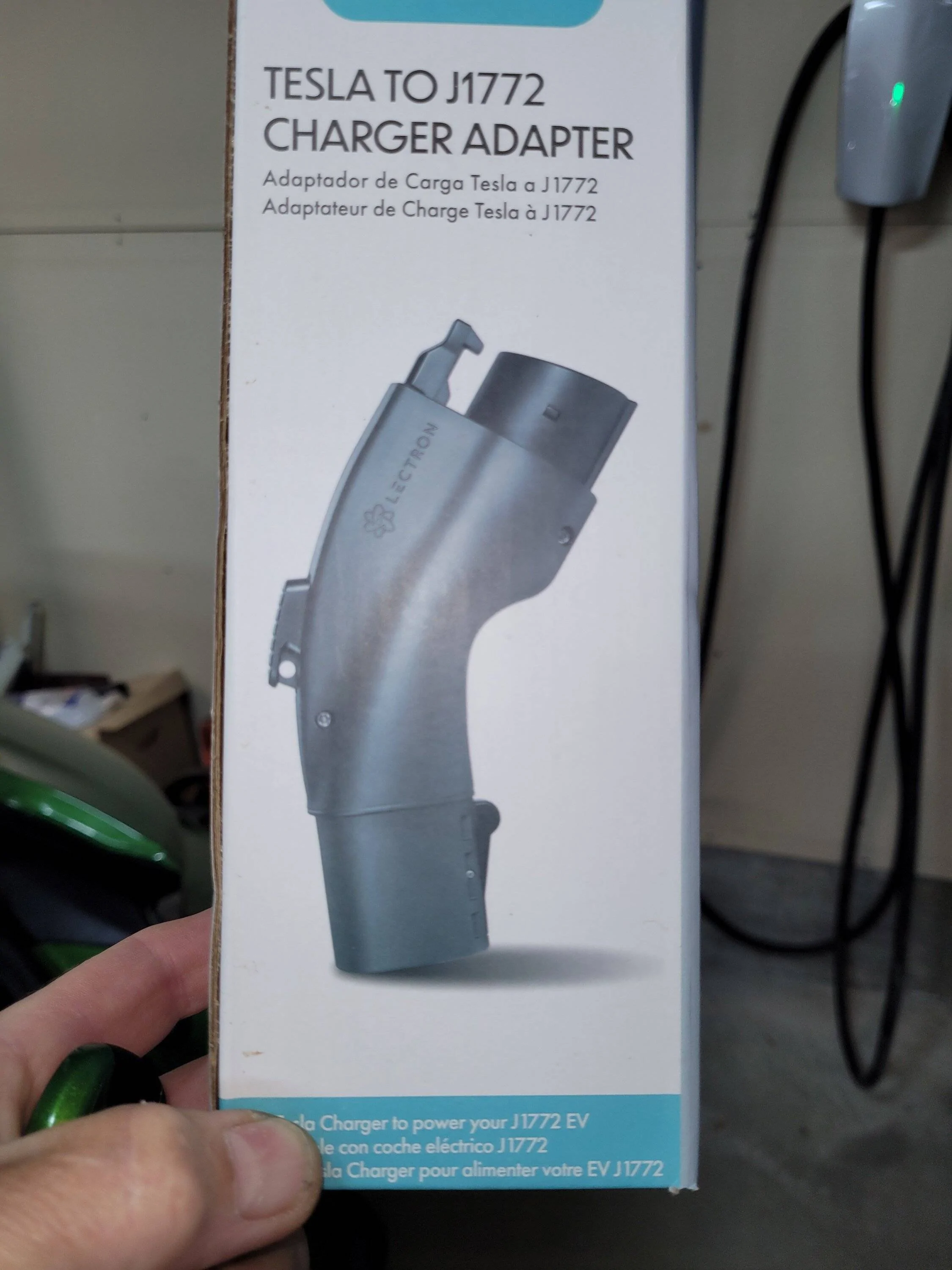

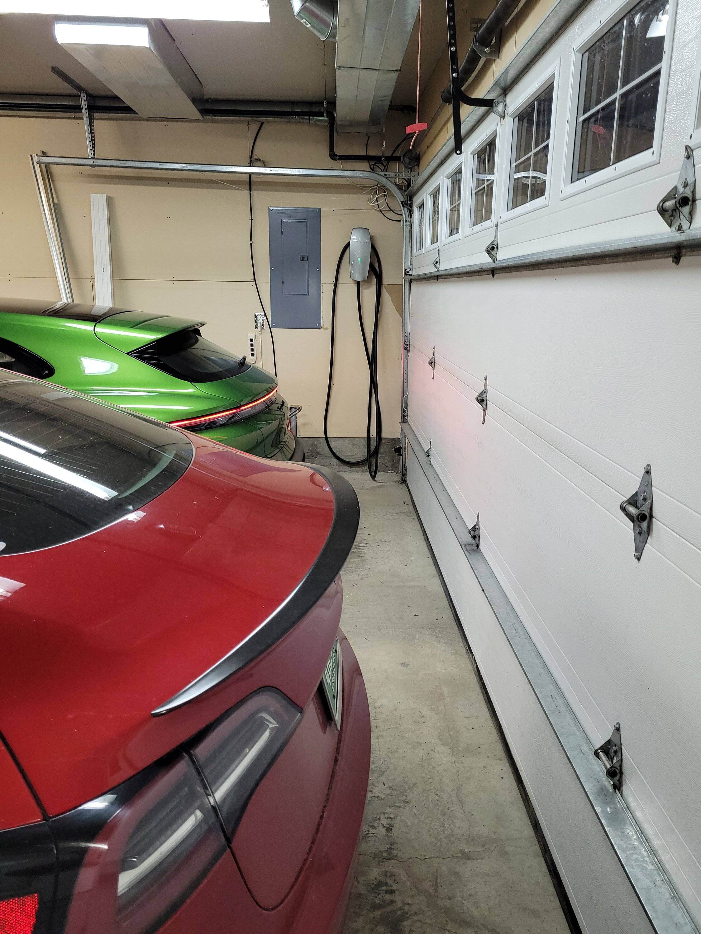

I have a Tesla M3P and Tesla charge cable installed on 70 AMP breaker. As previously described my Taycan will charge at 11 KW. The Lectron Tesla to J1772 for 48Amp charging on amazon is at a good price. https://a.co/d/f0UUHjq
Most Tesla destination chargers are free at this point.
