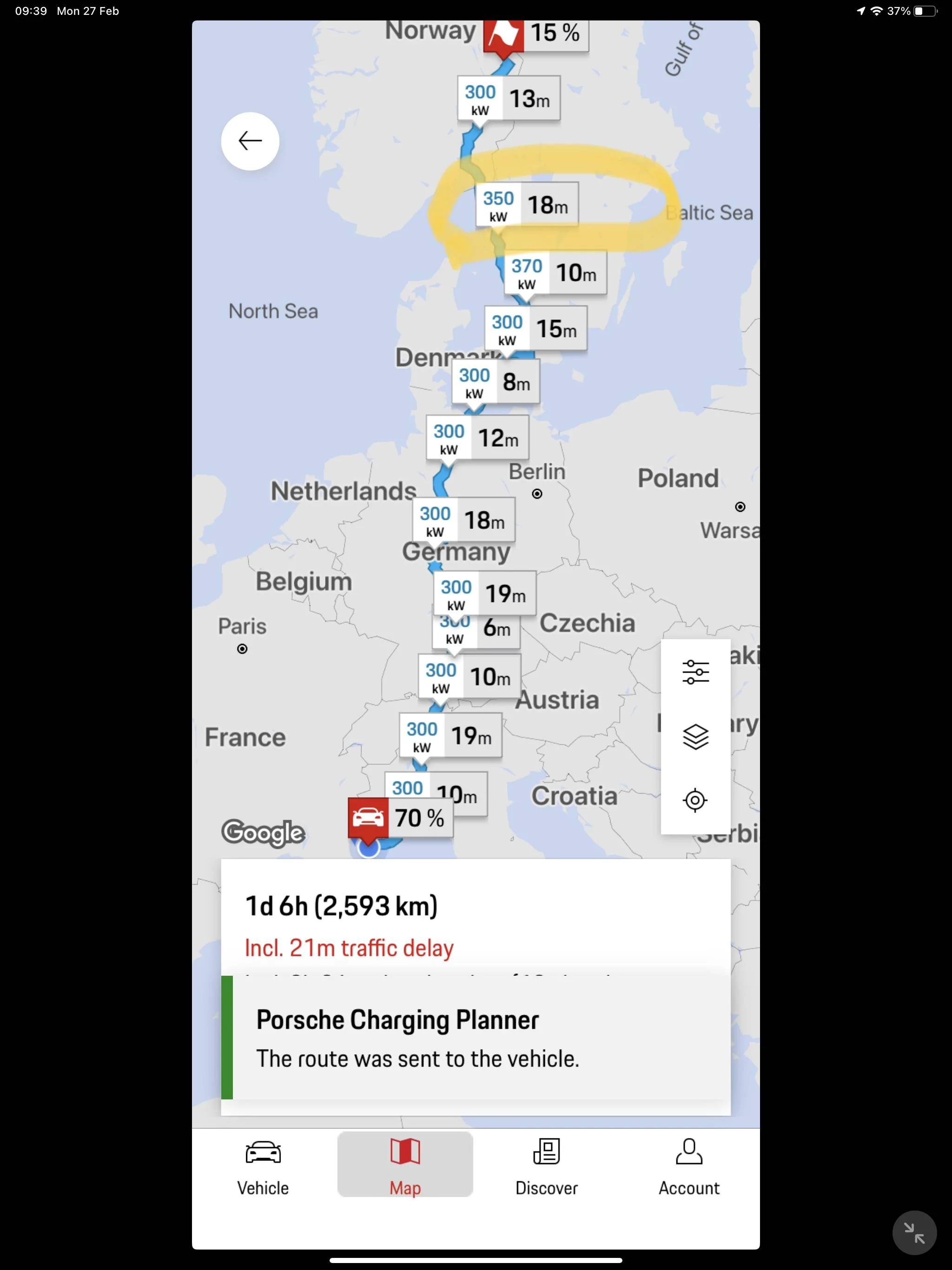

The plan was to plot a route from Nice Airport, France, to Trysil Ski Center, Norway, using the My Porsche app. And /or the Charging Planner in the car. Sounds easy to do, but it became a complete mess of a plan.
Here is how I tried to do it.

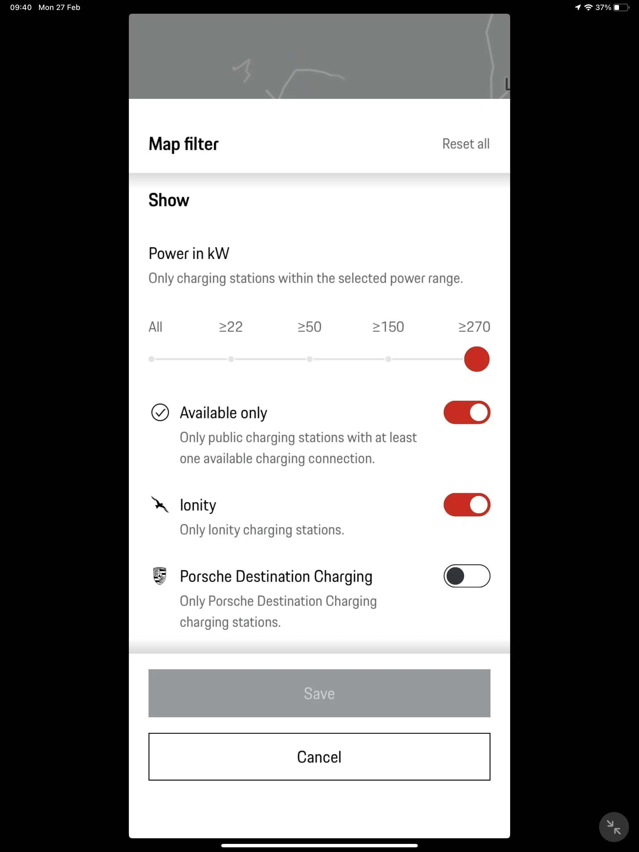

The map section of the My Porsche I app was set to only consider chargers above 250 kW and use Ionity only! I know that the route has plenty of Ionity stations available from my own experience.
Porsche Taycan Trying to prove that Planning a long Road Trip in a Taycan is very easy 8C2BBD44-3E06-421B-A678-0AC51181E8B9
I let the app plan the route as normal. To my big surprise I noted that only one (1!!) Ionity station had been included in the overall plan. One station out of 12 charging stops. The charger is highlighted in the picture below
Plus that I knew from experience that the car would not even reach the first stop and in reality, would replan and send me to a 50 kW charger once starting to drive! And that lone charger is mostly off line or occupied. Have done that exercise already!
Porsche Taycan Trying to prove that Planning a long Road Trip in a Taycan is very easy 4B0D9B62-F12B-443D-BA28-B4C913ADCE1E
Porsche Taycan Trying to prove that Planning a long Road Trip in a Taycan is very easy 2DEABC41-228D-43FA-8003-18A4EAE03208
The plan skipped the Ionity chargers at the bottom of the picture as well as the charger south of Milano?
The apps plan would mean stopovers at some stations where there was 1 (one ) or 2 (Two) charge plugs listed. With two plugs and 300 kW indicated. It would most likely be a shared power arrangement. Chargers with two cables at one station like the Alpitronic ( which is a very good and mostly reliable charger btw). Each cable then gives only 150 kW which I have experienced at some of those. Still powerful for the Taycan, but they do not always deliver that rate, which means a longer stop. And secondly all the chargers chosen in the apps plan, would have a much higher kWh price PLUS a per minute charge than Ionity. The result would be more than double the cost for charging on this trip!
The network names, in some cases, looked like belonging to some very local organisations. I think it is great that more local communities are trying to make it easier for EV owner in general. However they do not always seem to be connected, so difficult to check if they are free. Would they even work with the Porsche Charging services by app or card? Or work at all?? How is maintenance provided for them?? We have seen the difference between European experiences and US Electrify America experiences.
I very much doubt that the apps plan would have worked at all.

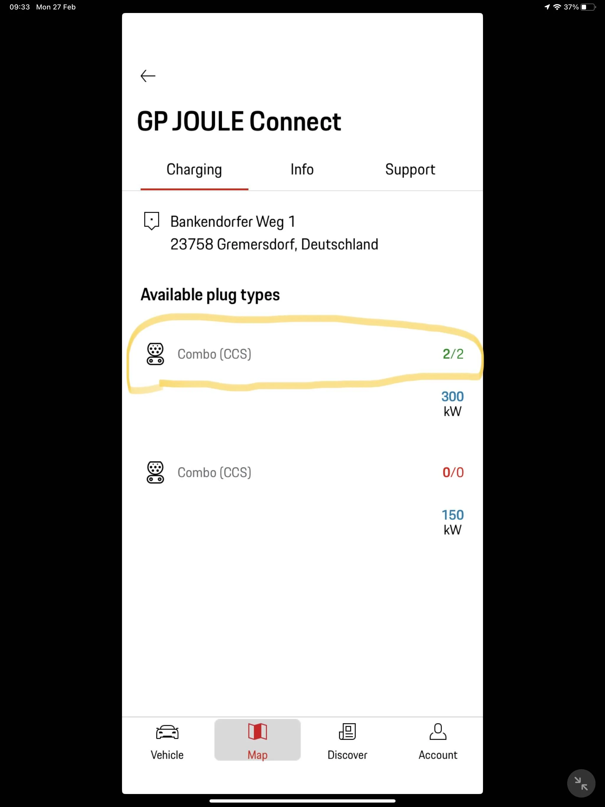

This is normally a very good and reliable charger, but many stations have shared connections like in the picture. And then the power is limited.
Porsche Taycan Trying to prove that Planning a long Road Trip in a Taycan is very easy 957EBCB9-1331-4245-BD1E-7F1AB76C4443
And only having two connectors is a high risk strategy. It can be off line or occupied.

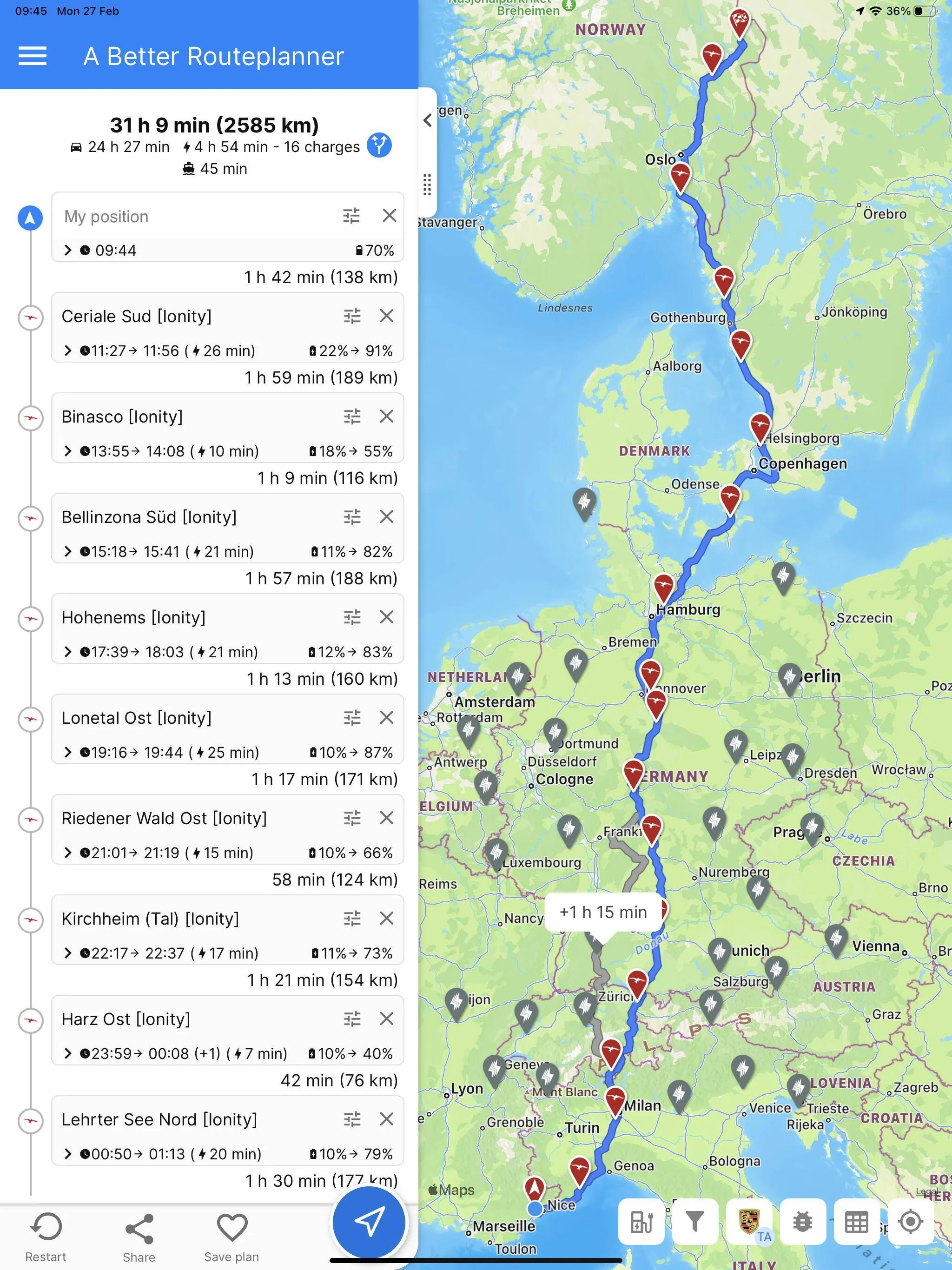

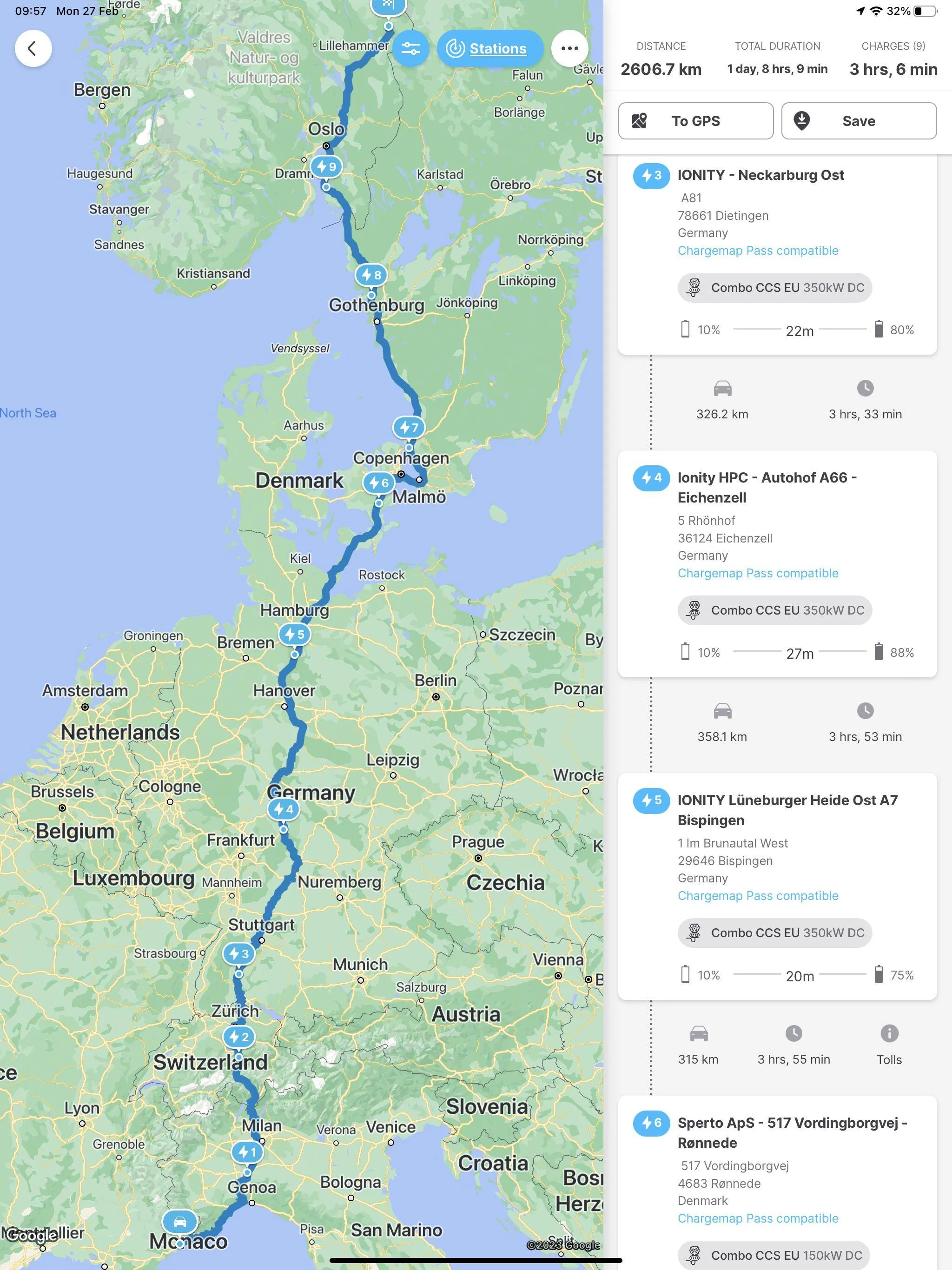

To check the plan I then tried two other charging planners. ABRP and Chargemap, to see how they would plan the route. The actual route was exactly the same by all three planners. And both ABRP as well as Chargemap included nearly exclusively Ionity stations as requested. The costs would be considerably higher using the Chargemap card, than the Ionity pricing for Porsche. Chargemap charge between 0.96 Euro to 1.14 Euro per kWH at Ionity stations. They do not have the preferential rate that Porsche owners get. The Porsche Charging Service costs about 0.35 Euro per kWh.
With ABRP you can also get a summary of the costs for the trip, which was missing in Chargemap and also in the Porsche Charging Planner unfortunately. Both these planners showed a much more realistic plan, even if the Chargemap planner would plan for some stretches up to 340 km between stops. And that is not going to be realistic in winter driving in my car. Maybe not even in summer time?
ABRP plan

Chargemap plan

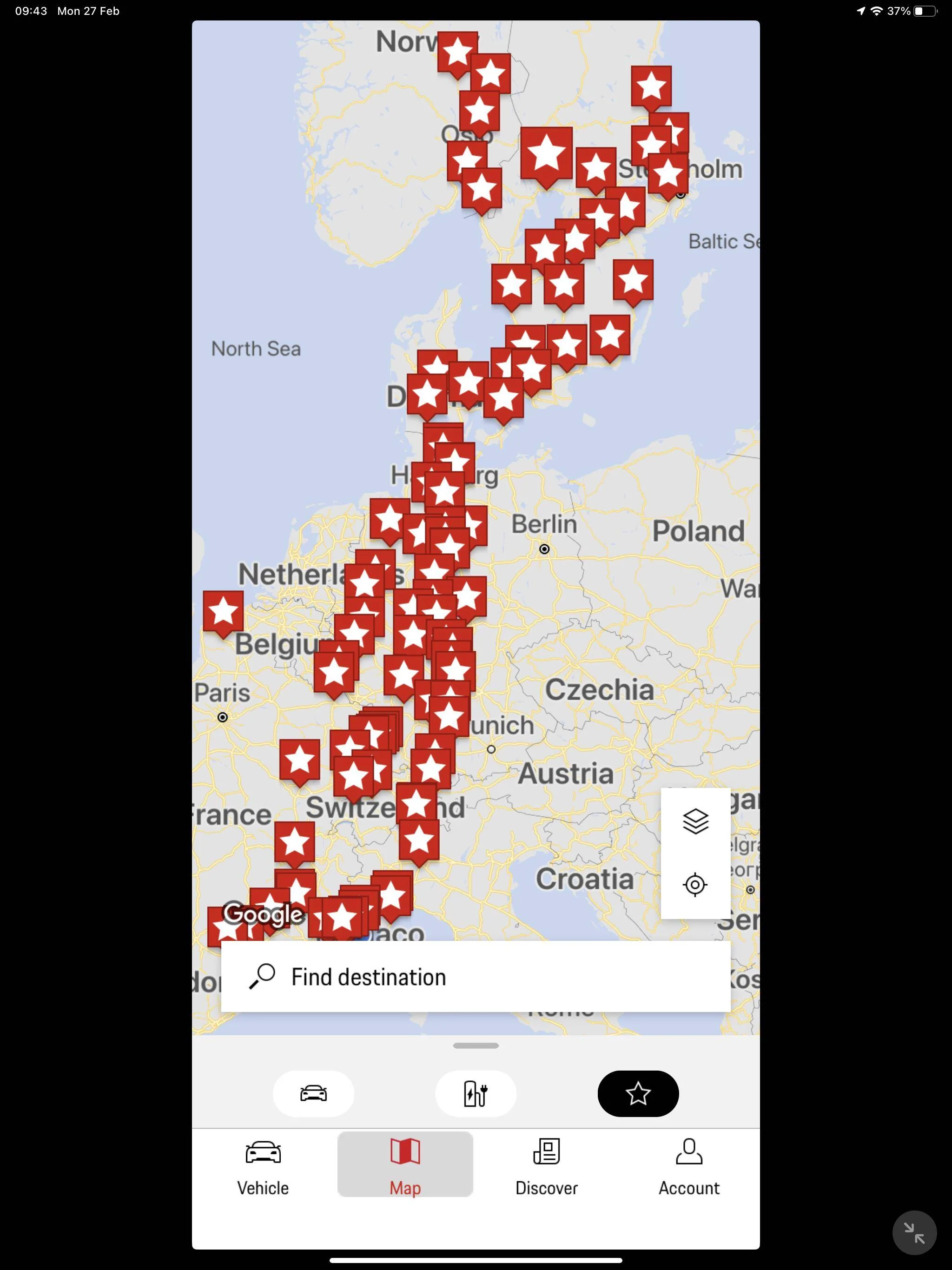

Ionity as Favourites in app and car
I have set up the Charging Planner in the app and the car to include the Ionity stations for the route as favourites! They will the all be shown as a star in both the app and the PCM. This is very useful to have, when driving on a trip as you are likely to receive multiple map updates, with the result that the trip will be replannned.
Porsche Taycan Trying to prove that Planning a long Road Trip in a Taycan is very easy 3C591854-ED4F-498D-9EF9-B98889709BED
Picture of app display
Porsche Taycan Trying to prove that Planning a long Road Trip in a Taycan is very easy DD999DF5-0DE5-438C-9ED2-B1C6997E64A5
As can be seen there are many stars on route and each star represents an Ionity station.

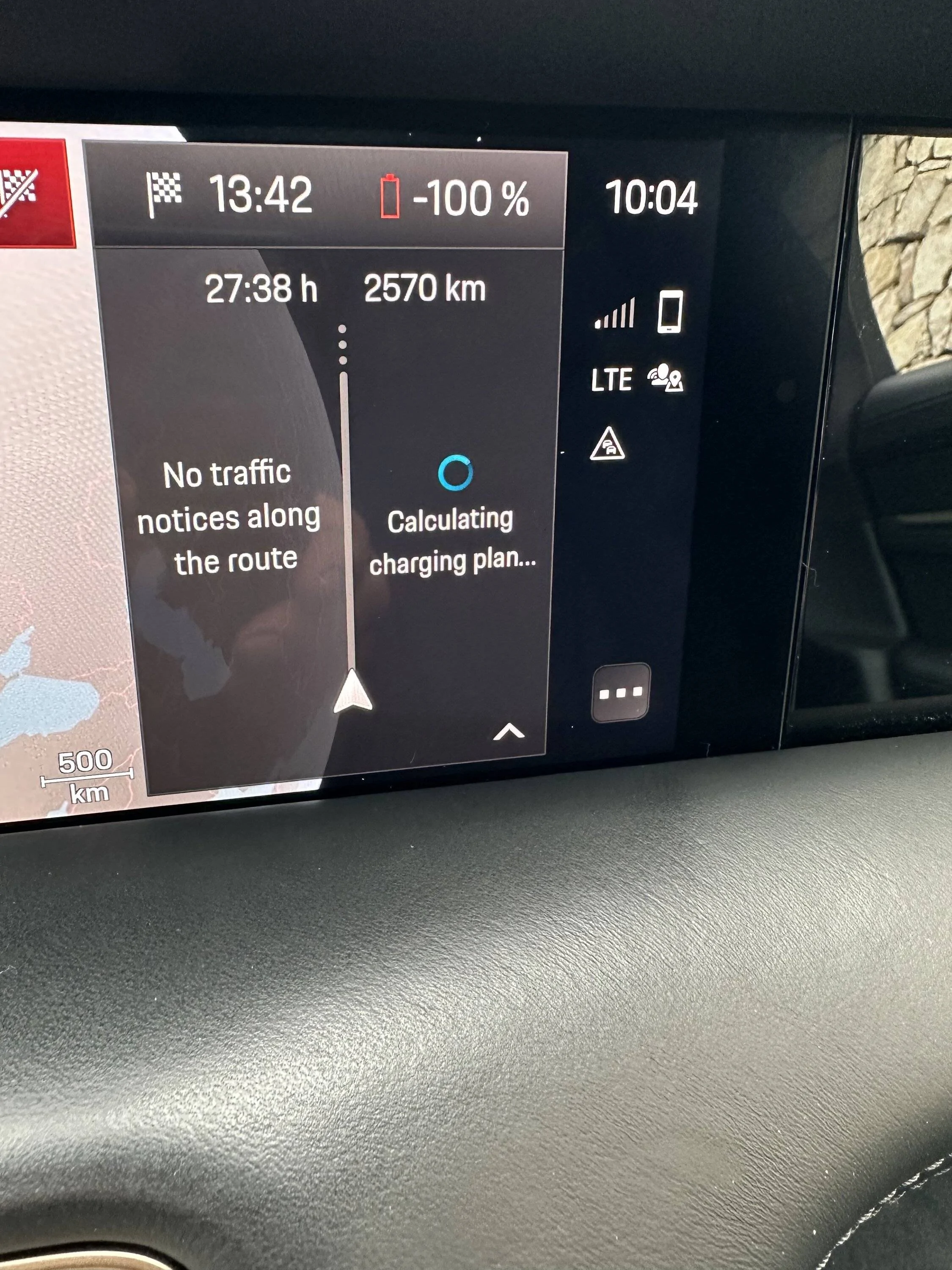

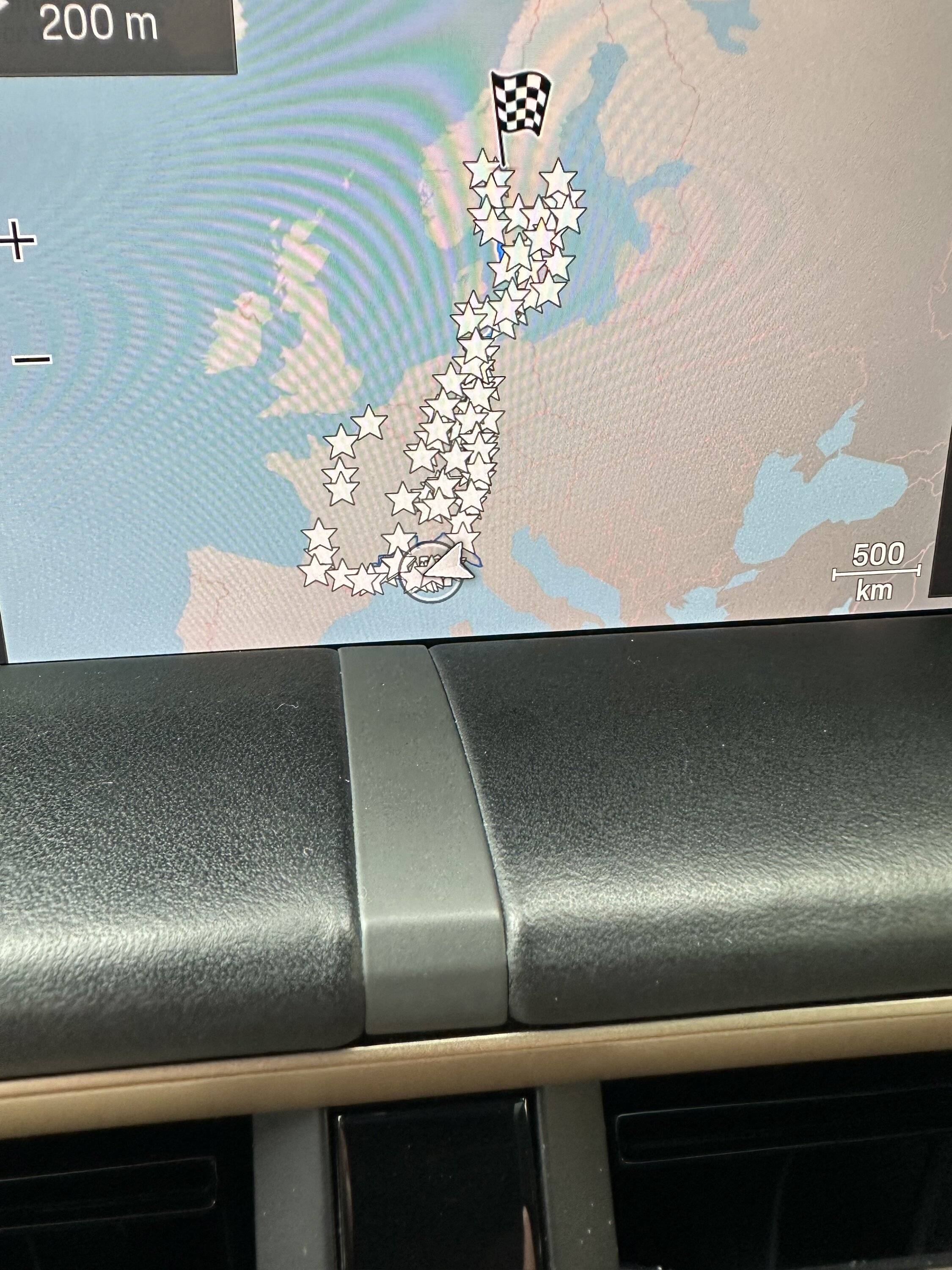

Plan in the car

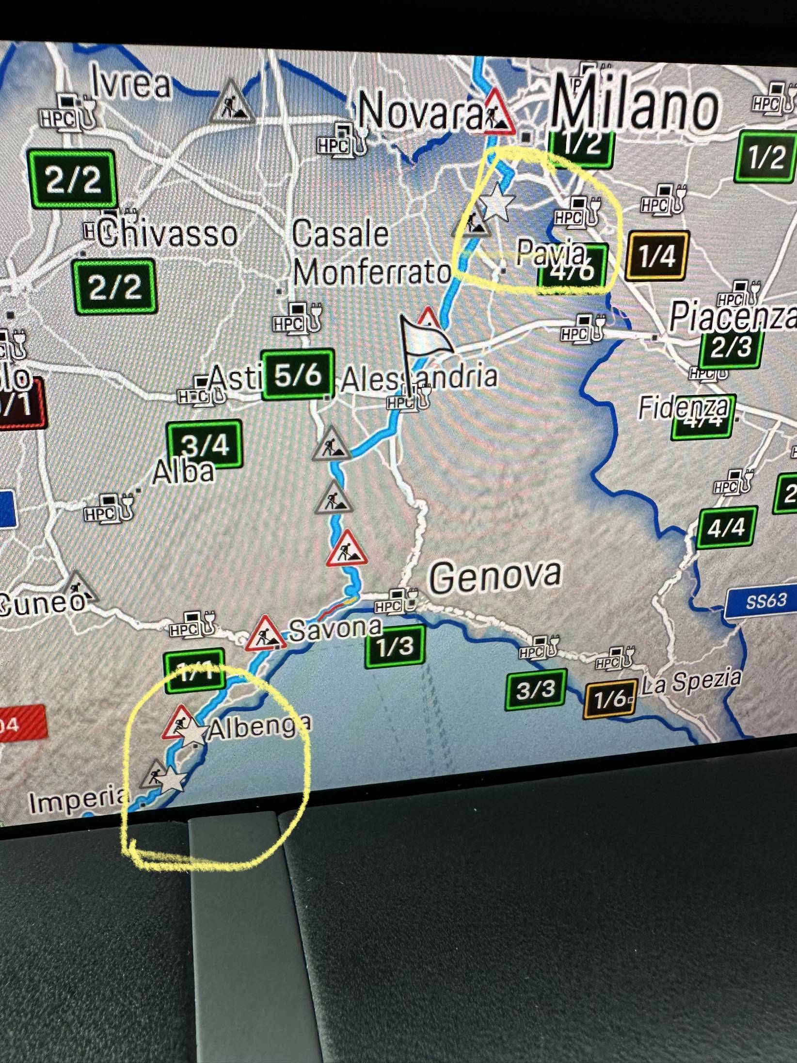

After sending the route from the app to the car, I set the car to only use HPC above 250 kW and wanted the car to plan the route to the destination. The Planner took some time but did present the route after a while together with charging stops.
Porsche Taycan Trying to prove that Planning a long Road Trip in a Taycan is very easy AD48CA75-F075-46B9-951E-527197850A79
Unacceptable result of the Porsche Charging Planner!

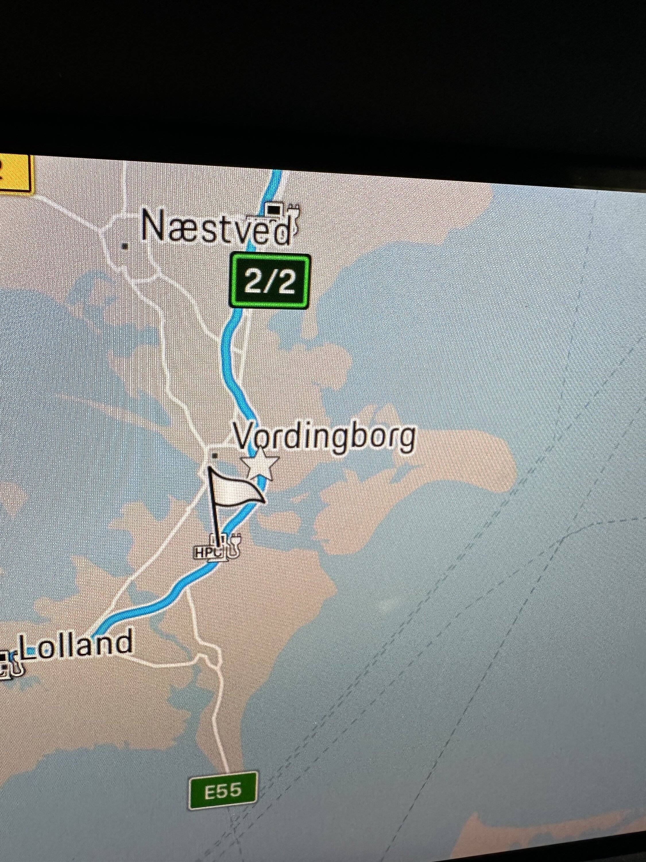

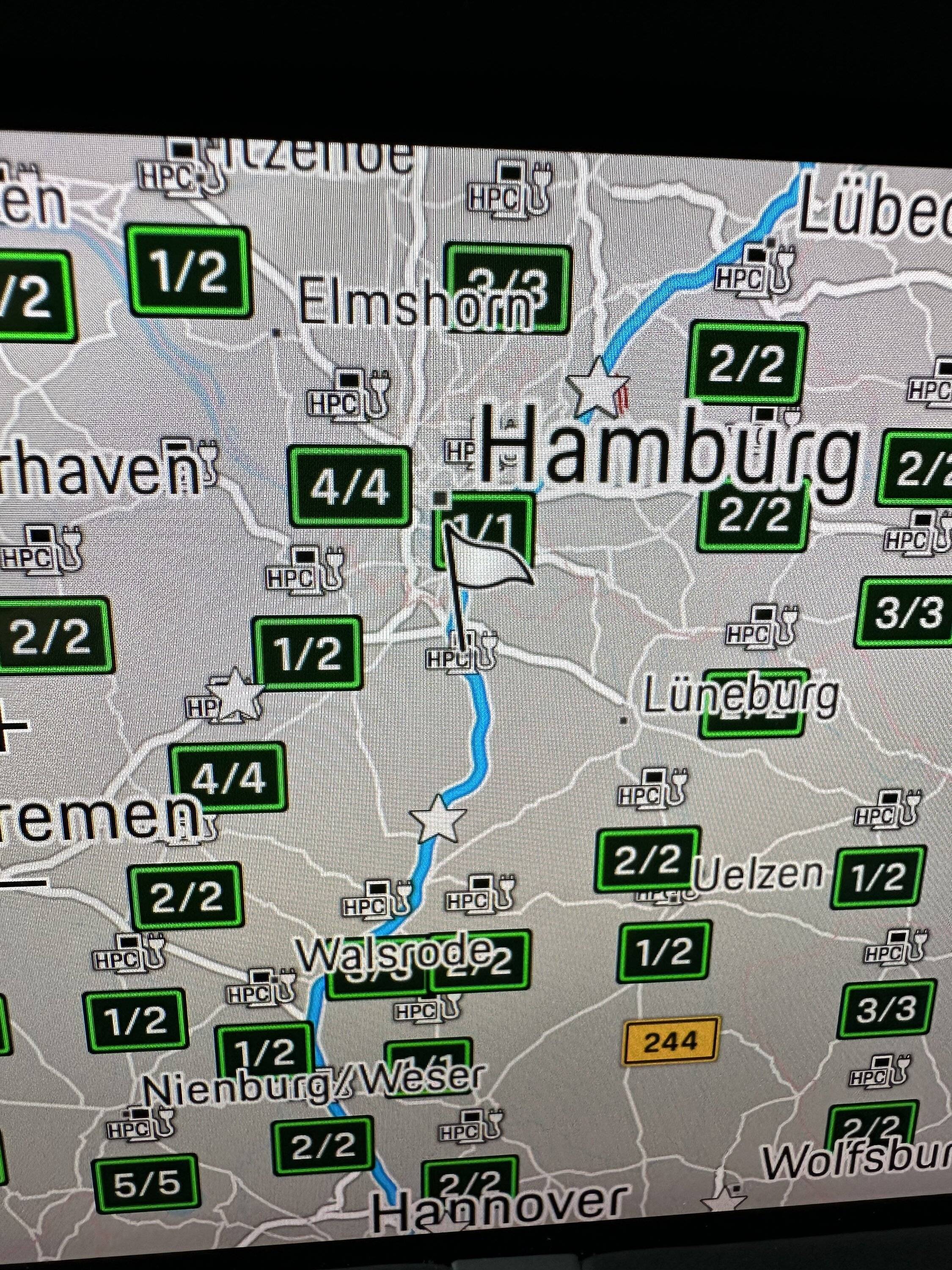

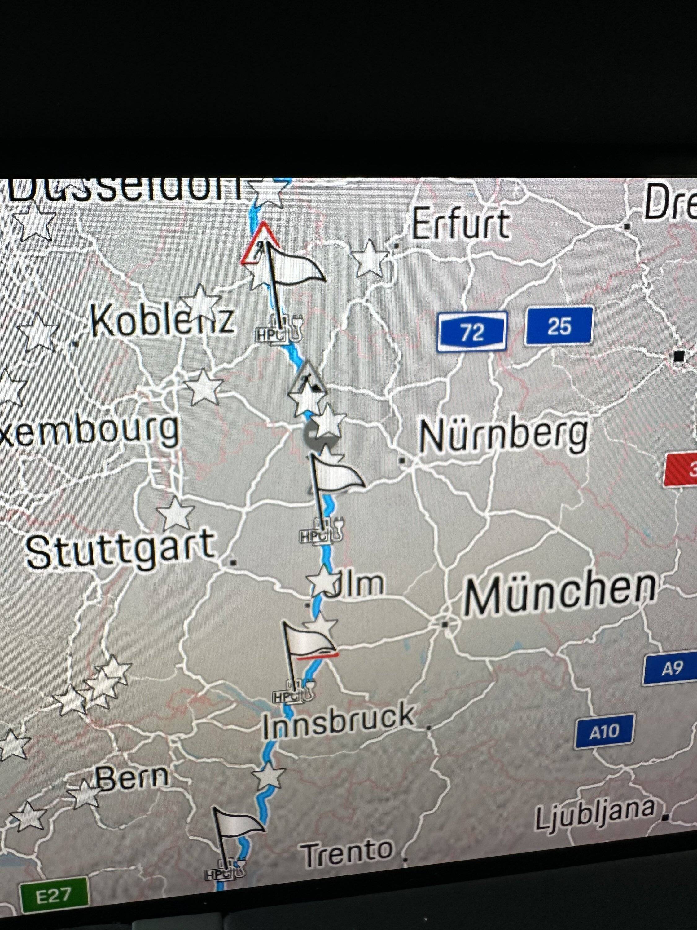

However it seems to be programmed to AVOID all the Ionity stations on route. It choose some obscure stations with 1 or 2 chargers shown in some cases. Networks that I never have seen or heard about again. And this occurred with Ionity stations in close proximity to such a Charging Planner stop!
Porsche Taycan Trying to prove that Planning a long Road Trip in a Taycan is very easy 1FF1EED0-2D77-44C7-8732-46EAF9906409
Porsche Taycan Trying to prove that Planning a long Road Trip in a Taycan is very easy 4A10A153-AE4C-4A97-8A23-6E7BF0250D0F
The flags in the photos show the planned stops at charging stations, while the white stars show location of nearby Ionity stations
