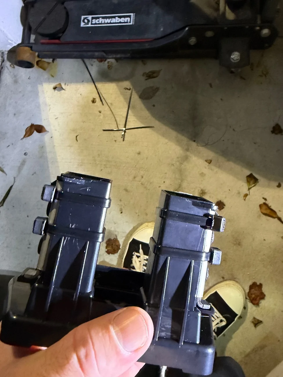

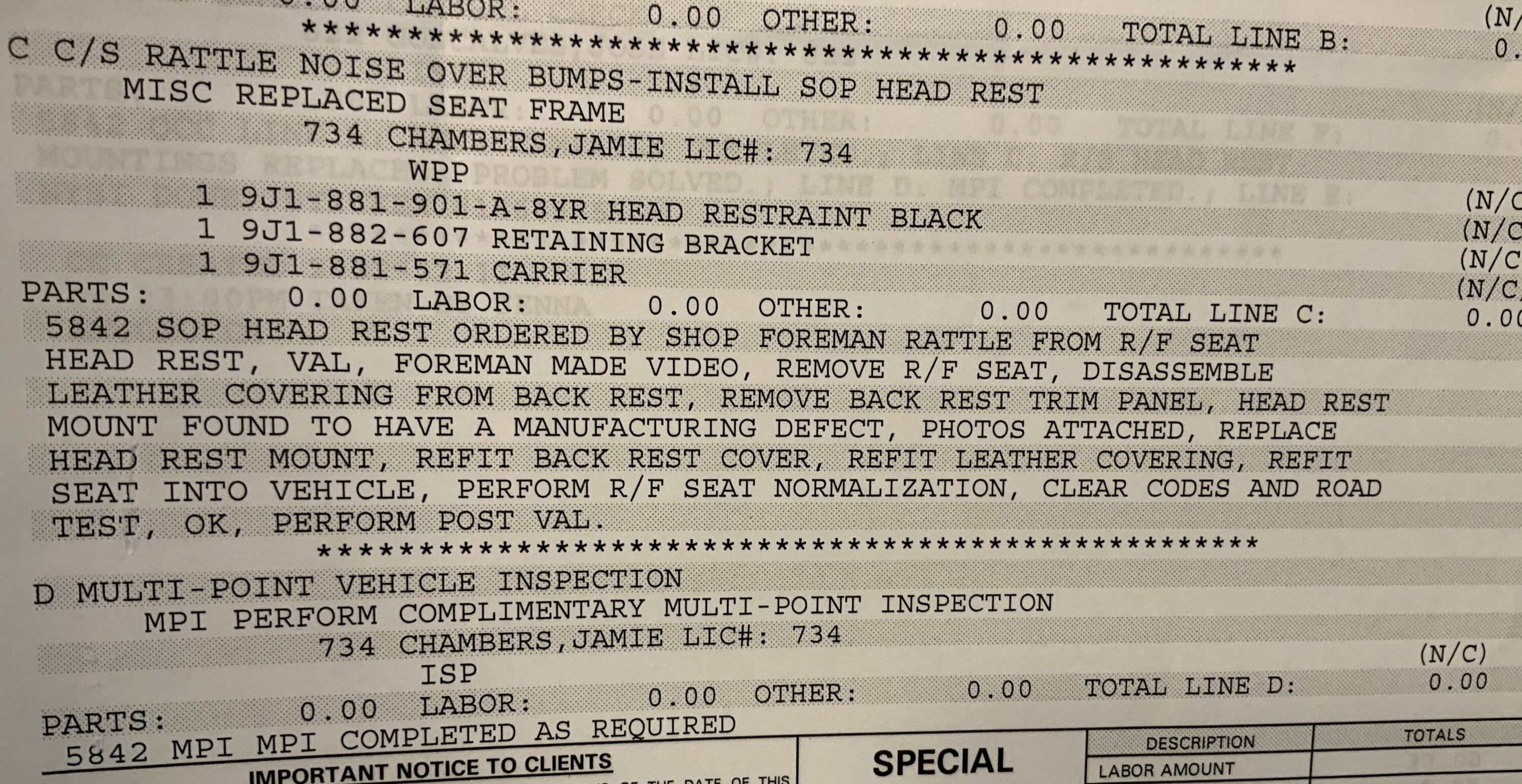

While I was having my update installed, I had service look at the passenger seat rattle (14-way seat). To my slight surprise, they reported that there is a TSB for the rattle in the headrest and have ordered parts! Looking forward to having it fixed. Will update eventually...

I will add that, in addition to requiring parts from Germany, the repair will require them to remove the seat and send it to an upholstery firm to install the fix. Hoping it won't take too long...

Sorry, when I picked the car up, the Service Advisor who was there (a different one) didn’t know about a TSB, and the receipt shows that the original SA simply ordered a part and did not attach it to a TSB. So I totally forgot to report the TSB number to the forum since there apparently was not one.
Porsche Taycan TSB for Headrest Rattle IMG_0927
