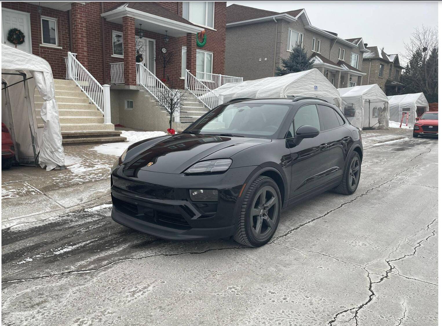

I was on the Macan EV forum today and saw for the first time what they do in Canada to keep their cars not snowed in, which I think is pretty genius if you park your car outside.
Zip up temporary car tents!
n
That's a great idea.....I wonder why they have not taken off in the US.?
