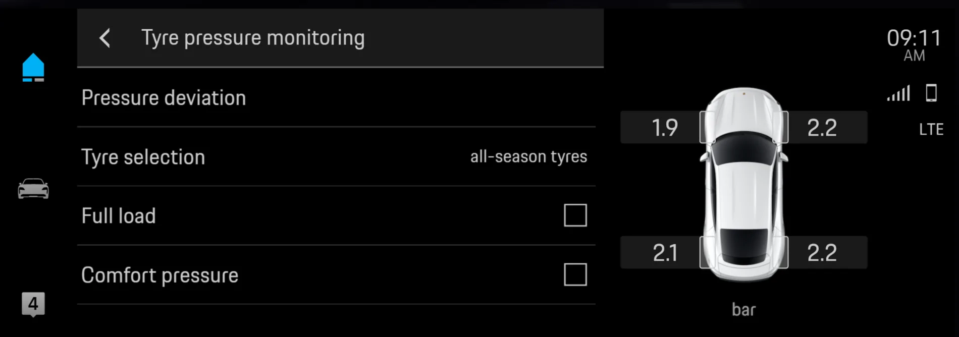

Din You ever get this sorter Daniel?
It certainly is a bit surprise to suddenly loose so much pressure in your tyres. No idea about this.
The info about 61 psi must relate to some emergency spare wheels, which we do not have. No normal tyre should need that.
Is it correct that you have 20 inch summer tyres that you want to set?
If you play around with the PCM simulator as in this link, you can set the type of tyre you have fitted , summer, winter, all season. I can also set different dimension in my car such as 20 inch or 21 inch, but that does not seem to be on the simulator.
https://your-digital-co-pilot.com/en.
It also shows how you can set the Units such as miles or km as well as pressure bar or psi if you want to change.
Remember that all recommended pressure settings are specified at 20 degrees C. If it gets colder the pressure will be less in the display etc.
Once you have selected the correct wheel size and tyre as well as the full load or normal load, you will se the pressure deviation in the display. Look at the pressure display and press the right thumb wheel and you can scroll to pressure deviation.
I would trust that deviation page and adjust my tyre pressure accordingly so that it shows 0 psi (bar). The TPMS should take into account the actual tyre temperature, which the sensor sends, but the car does not display. The System then takes temperature etc into account and displays the deviation.
My 2020 manual does not give any pressure recommendation so the dealer guru advised me to do as above. And it seems to work fine, The tyres are evenly worn over 15000 km driven.
Hope it helps.

Have you checked what wheels / tyres are set in the PCM (Settings, Vehicle Settings, Car, Tyre Pressure Monitoring) so that the TPMS communicates correctly?
I always go with the door sticker and follow the typical load there - Porsche Good To Know App (if not already reviewed) should be an authoritative reference point too.
