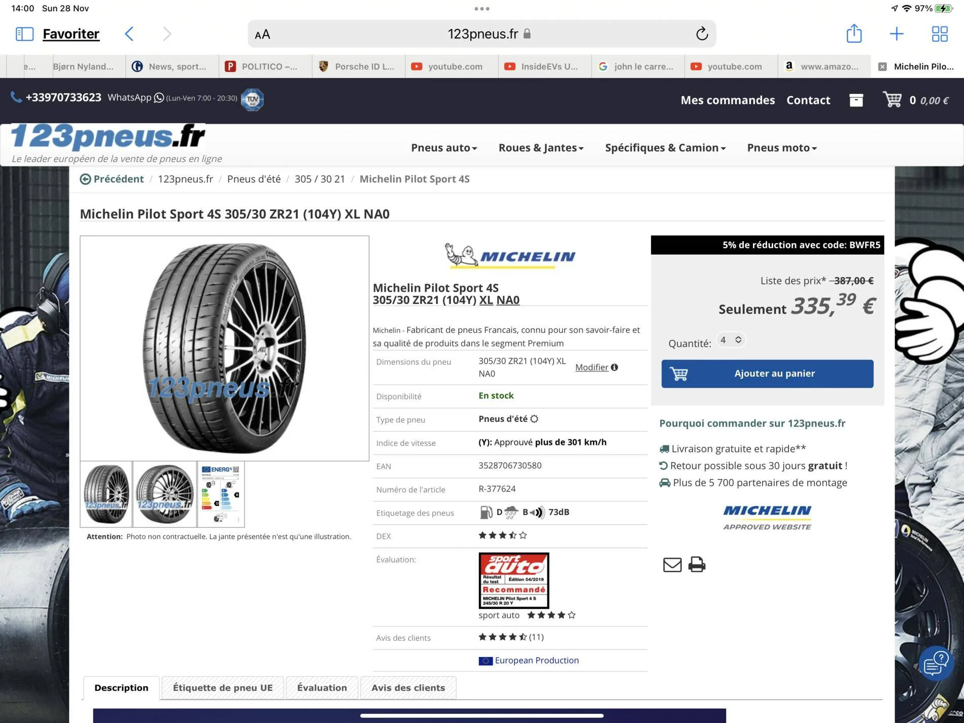

I think another road trip is coming up for you? At least here in France the 21 inch seem available.
Not in NF0 which is the Taycan variant. You'll want to get the correct version due to the additional weight of an EV – the NF0's having reinforced sidewalls.
Interestingly there is no Pilot Sport 4S that is rated NF0 for the Taycan – only the older Pilot Sport 4 – regardless of size.
