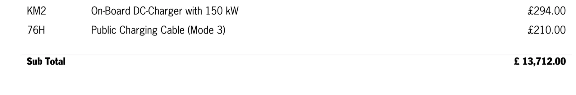

In the end I went with the 150kw option (it's a must have imo) and the standard 'public charging cable'? which I use with our home charger.

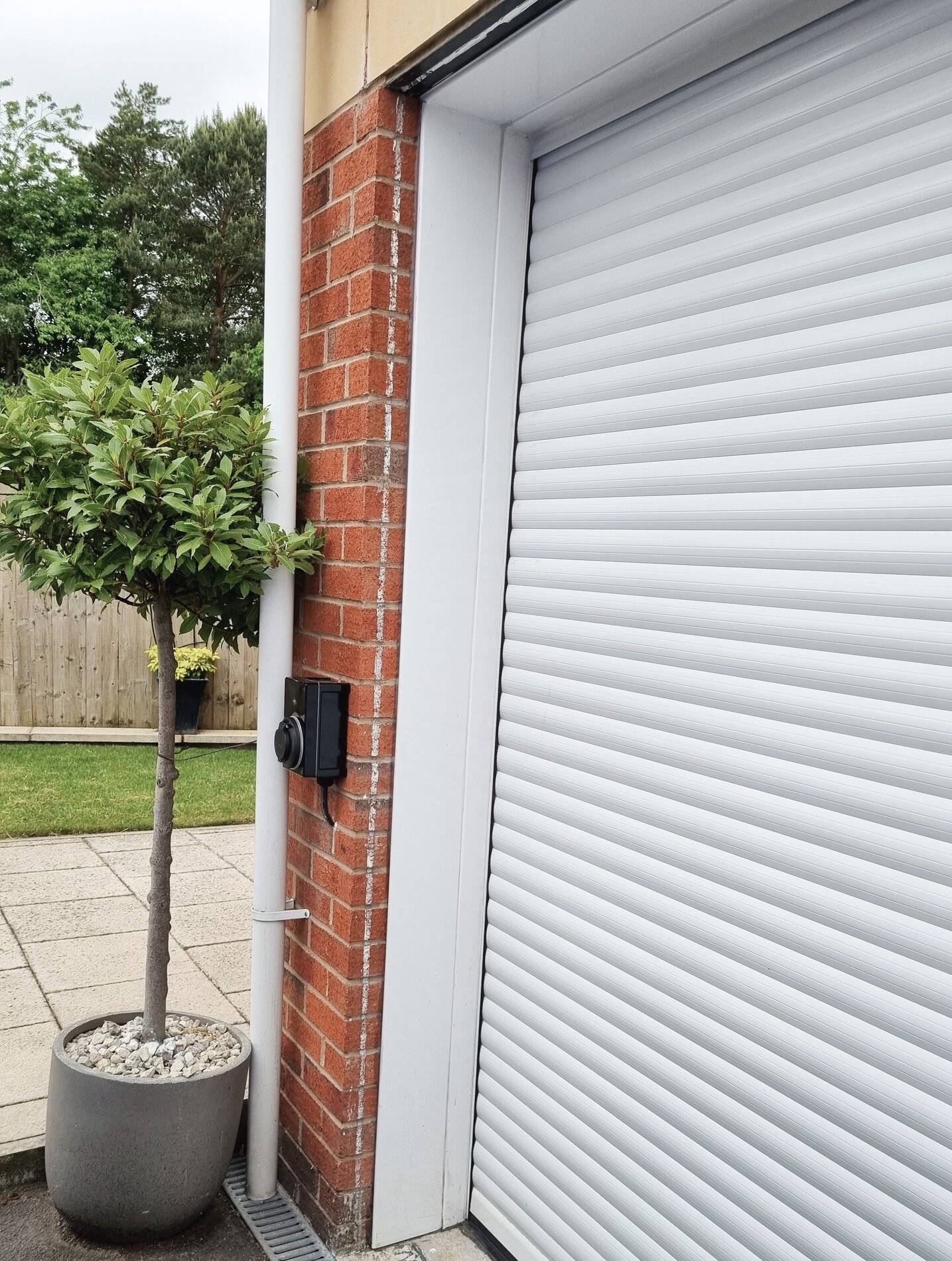

I bought a separate discrete untethered charger (pic: Sync EV) - but only because the Standard Porsche charger wasn't ideal for our home set up. Garage is a gym and mounting the charger wouldn't have worked.
But if you can mount the Porsche charger, it may be better as it is specifically designed to work with the car.
Thanks. WIll go for the 150KW option. Do you also have the "type 2 mode 3" cable as an extra for AC public charging?
No, I only went with the two options in pic.
I keep the cable in the frunk and just attach it to the home charger when I need a charge.
Personally, I prefer the untethered home charger as I wanted it as discreet as possible and don't find it too much hassle plugging both ends in.
