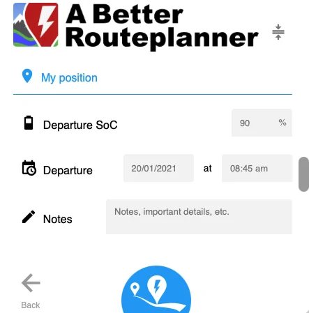

How does the route planner app know your cars current SOC to be able to calculate the minimum SOC when you arrive at the charger?
Click ont he GEAR next to the "Starting Point" and it brings up this menu (see below). You can enter your Departure SoC so that it knows how much charge you intend to leave with from your origin.

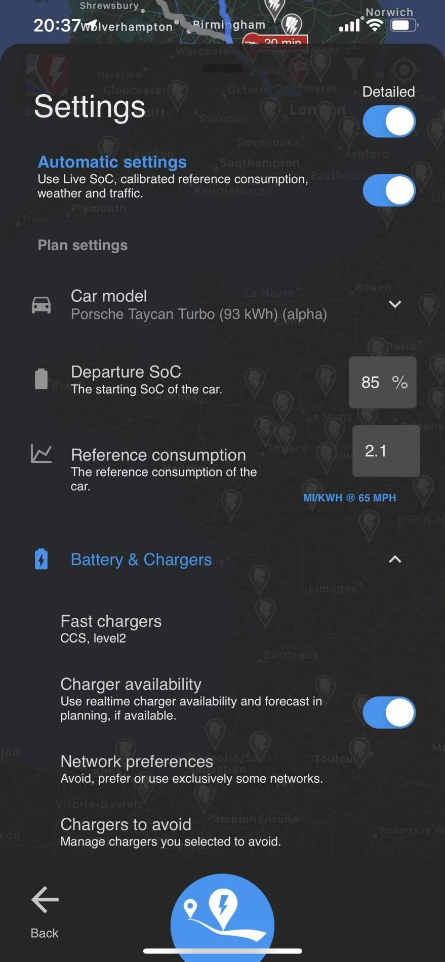

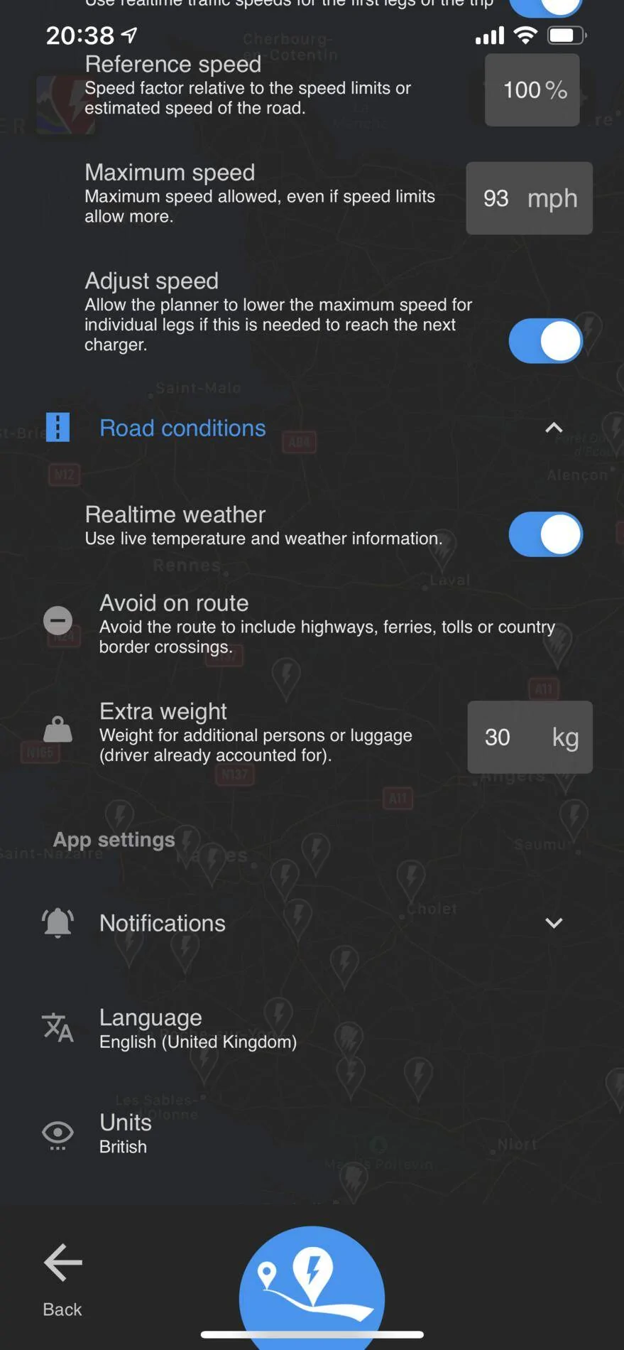

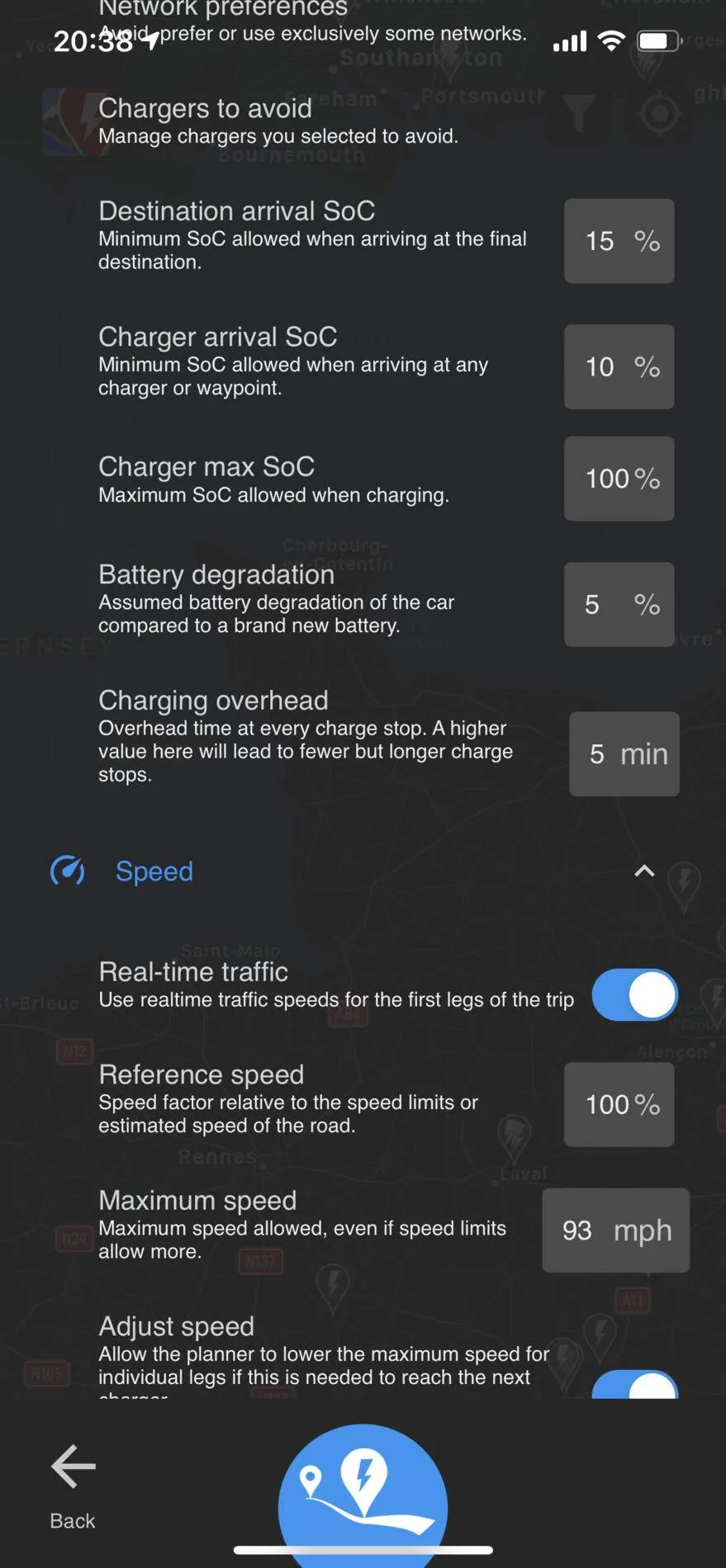

my settings are quite detailed. See below.

Looks like the app has been designed by somebody with a brain!
Very detailed and thanks for the screenshots

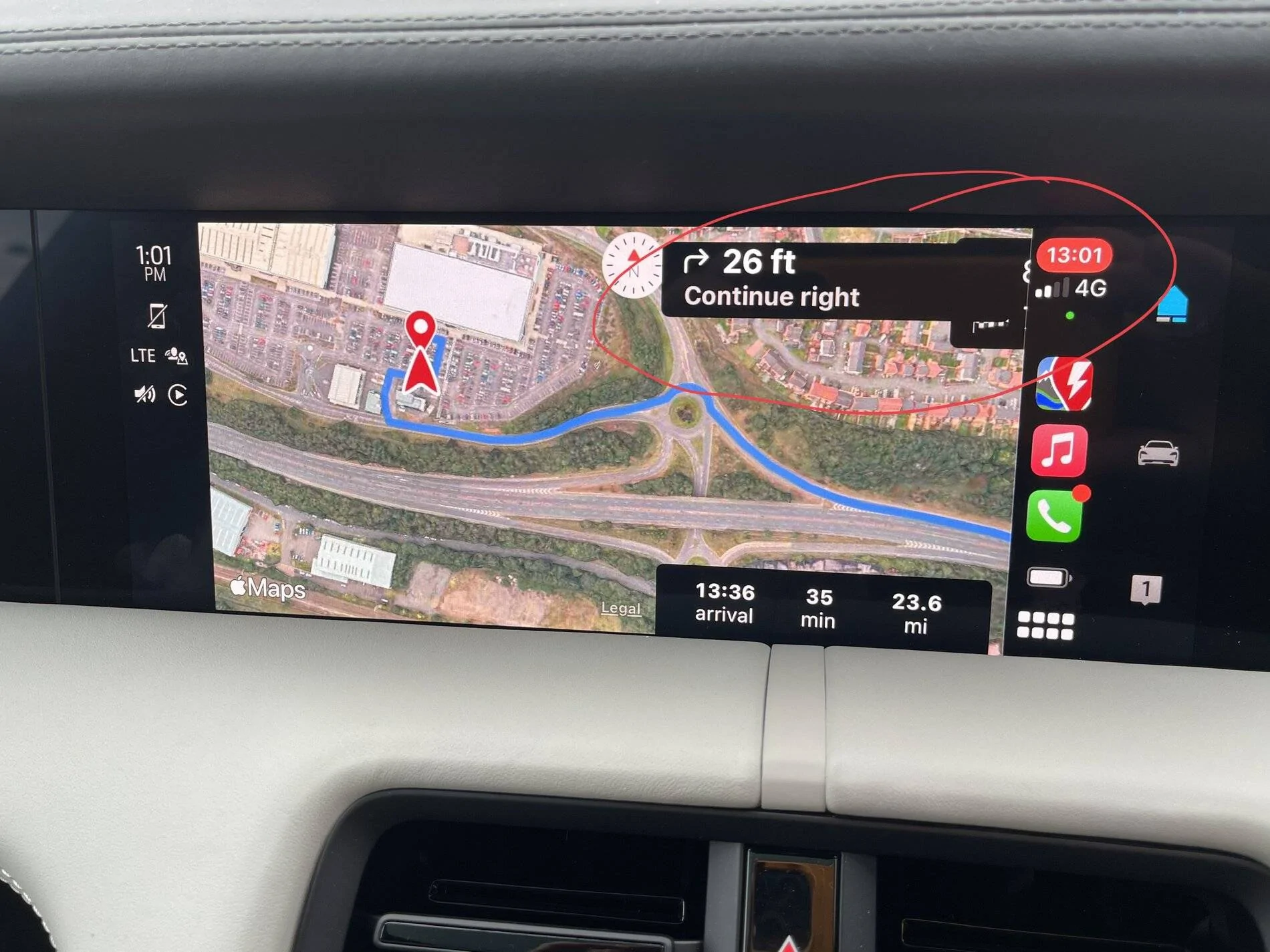

Yes the ABRP app is good once you set the parameters. The best thing is that it also now is available in the car via CarPlay. Have not tried it yet but it does show on the main nav screen just like all other CarPlay apps. Good start and from this I guess they will integrate further.

I have noticed that the map needs some adjustment to make it fully usable. See attached.
I’ve not used it in anger yet, but as you say.. it’s definitely a step in the right direction.
