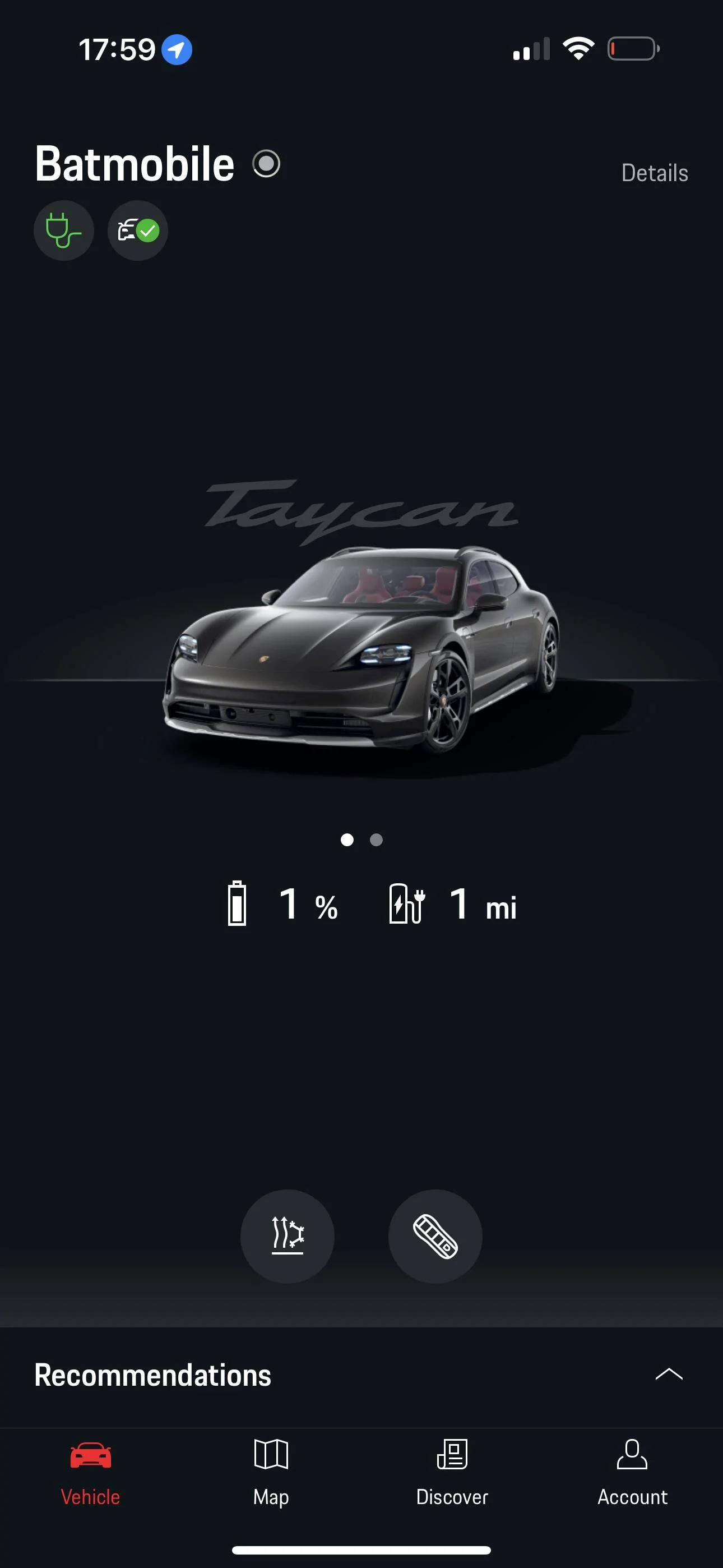

Was day from hell when I tried. First I was the 3rd car to arrive in seconds of each other. First Lady charged to 100%, second guy charged for twenty minutes. When it was my turn finally the bloody thing didn’t work. Not via shell app, shell card nada. Spoke to support and tried everything and it just failed. I only needed to charge for two minutes to be able to get home!!! Had to wing it on countryside roads hypermiling it and managed to get home 1% with 1mile range…let’s just say I’m not doing that again!
Following day went to IONITY round the corner and no issues so it wasn’t my car
