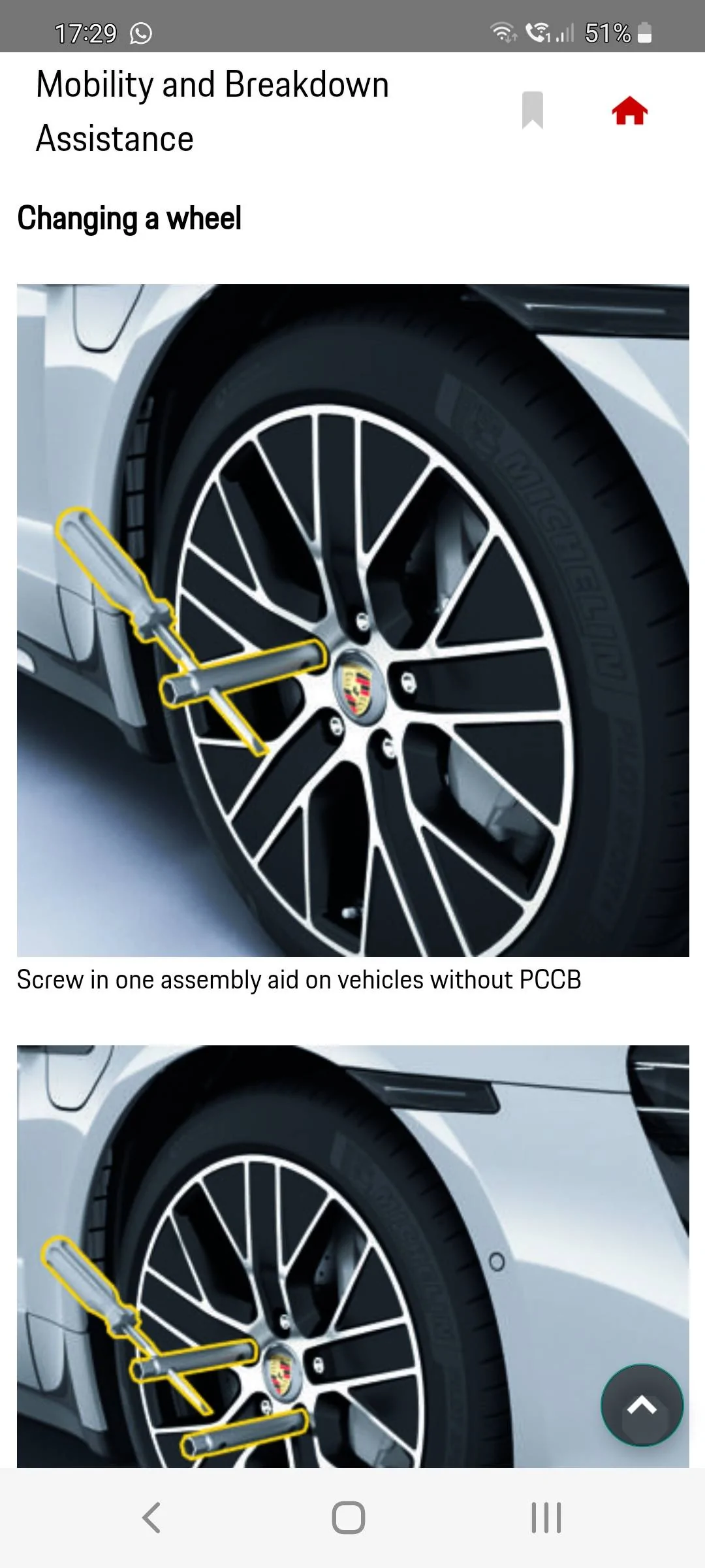

What about the 'assembly aid' as shown in the GTK app?
Porsche Taycan UK - wheel removal tools etc? Screenshot_20220208-172944_Porsche Good to know

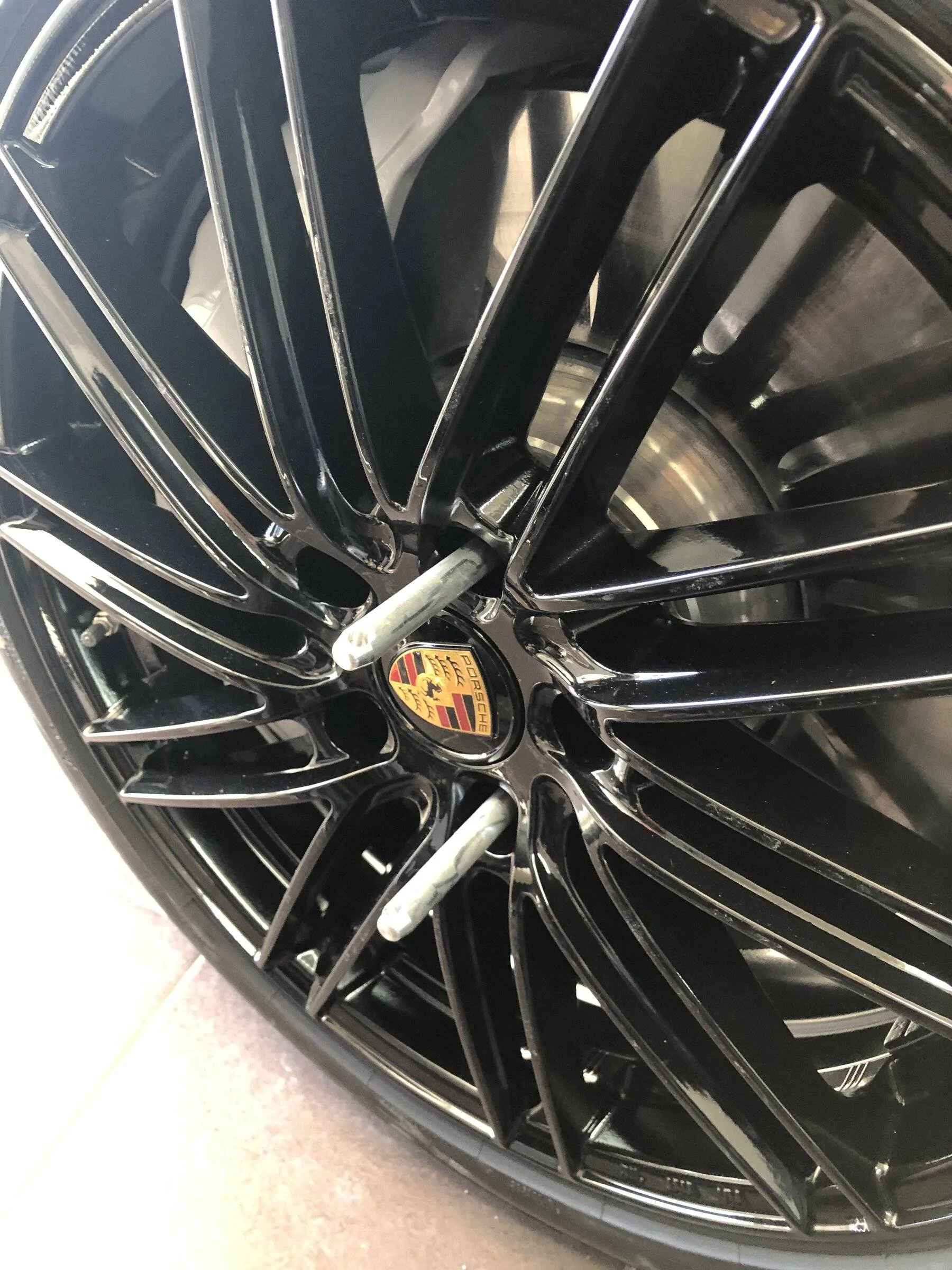

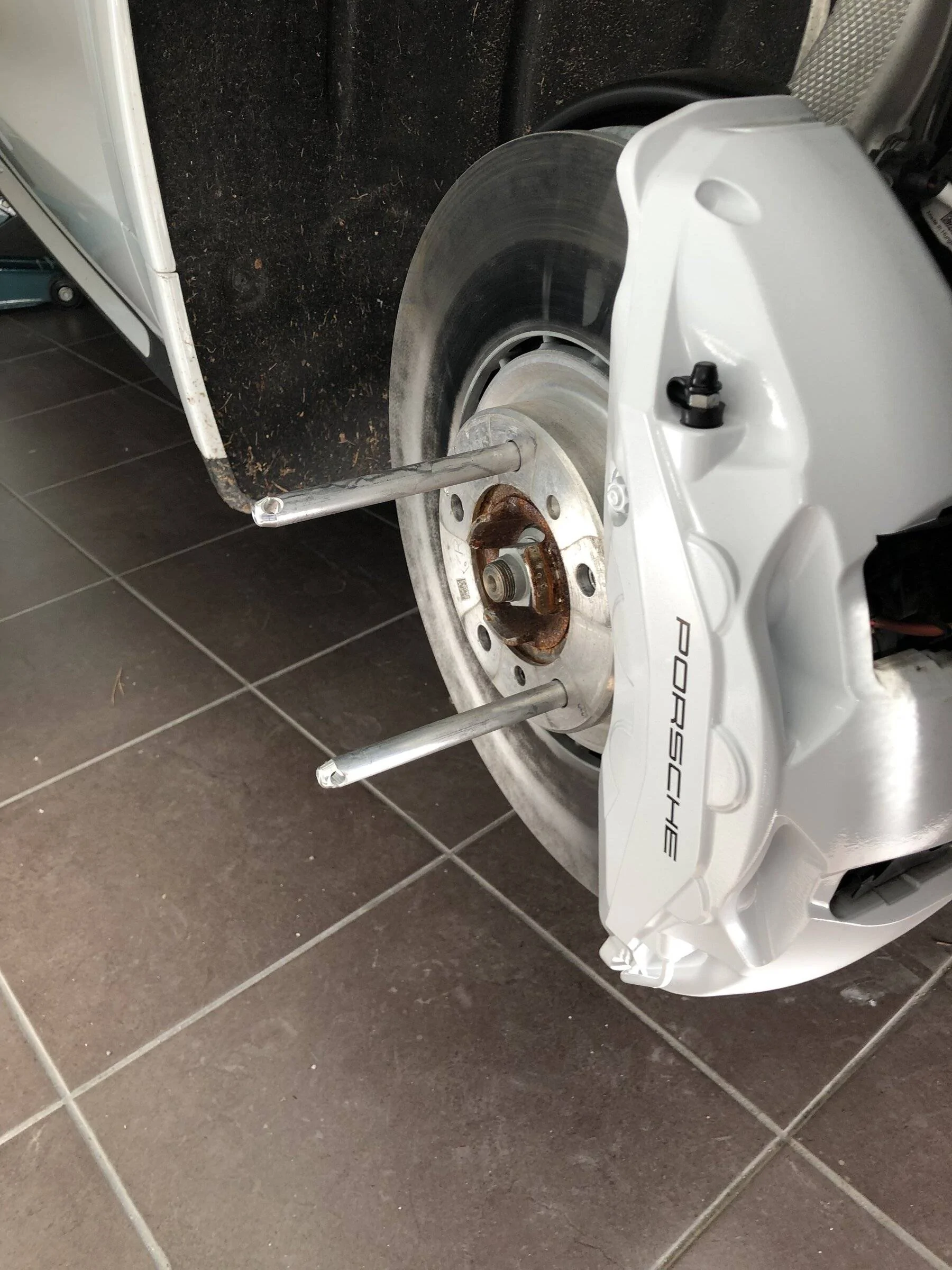

There are a few Wheel guiding pins that helps align the 21 inch wheels very well. They are quite tight to put on the car else with the large brakes and you do not want to scratch your rims or damage your discs.
https://www.design911.co.uk/fu/prod7429/Wheel-Mounting-Tool-for-Porsche/
But why they are shown in the GtK app is a gret question. You need a jack to lift the car in the first place??

If you ever want to change wheels or clean the wheels thoroughly I can highly recommend the pins.

I see....so the 'assembly aids' are also an aftermarket part.
It's bizarre that the manual and GTK app refer to these (as well as a jack, Compressor and puncture foam) and none of them are standard in the UK.
