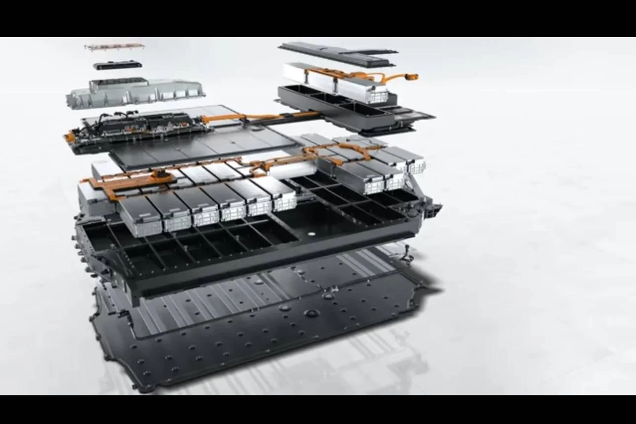

I think it refers to underbody guard in this:
Porsche Taycan Underbody Protection Panel damaged. Batteries and coolant lines need inspection.  $72.5K replacement & labor cost. Dealership is Tom Wood in Indiana HV Battery 1693693263937

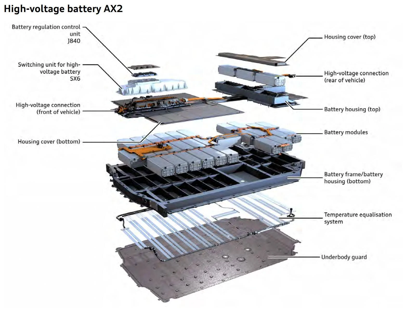

It's the tray above the protection plate as shown here
Now I'm confused. I thought the tray containing the battery, with the 'temperature equalisation system - the bit Porsche say is damaged) above the protection plate was not available as a separate item. I can't find it anywhere online (some sites say it's discontinued). I had presumed it came with a new battery.
Are we talking about the same thing?
Correct - it's the underside of the HV tray so the whole thing has to be replaced

The parts list on page 33 at https://www.taycanforum.com/forum/t...ship-is-tom-wood-in-indiana.20407/post-317144
shows that the battery and the "tray" with the cooling system are one $36k part. I believe this is just a conversational misnomer, and the "HV tray" with cooling system and "battery" are referring to the same assembly, which from the beginning of this unfortunate story has been clearly identified as being available only as a single part ("the HV battery").
