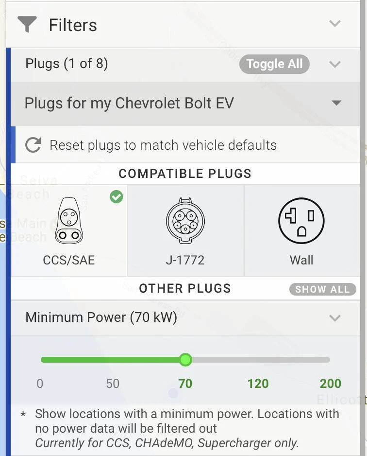

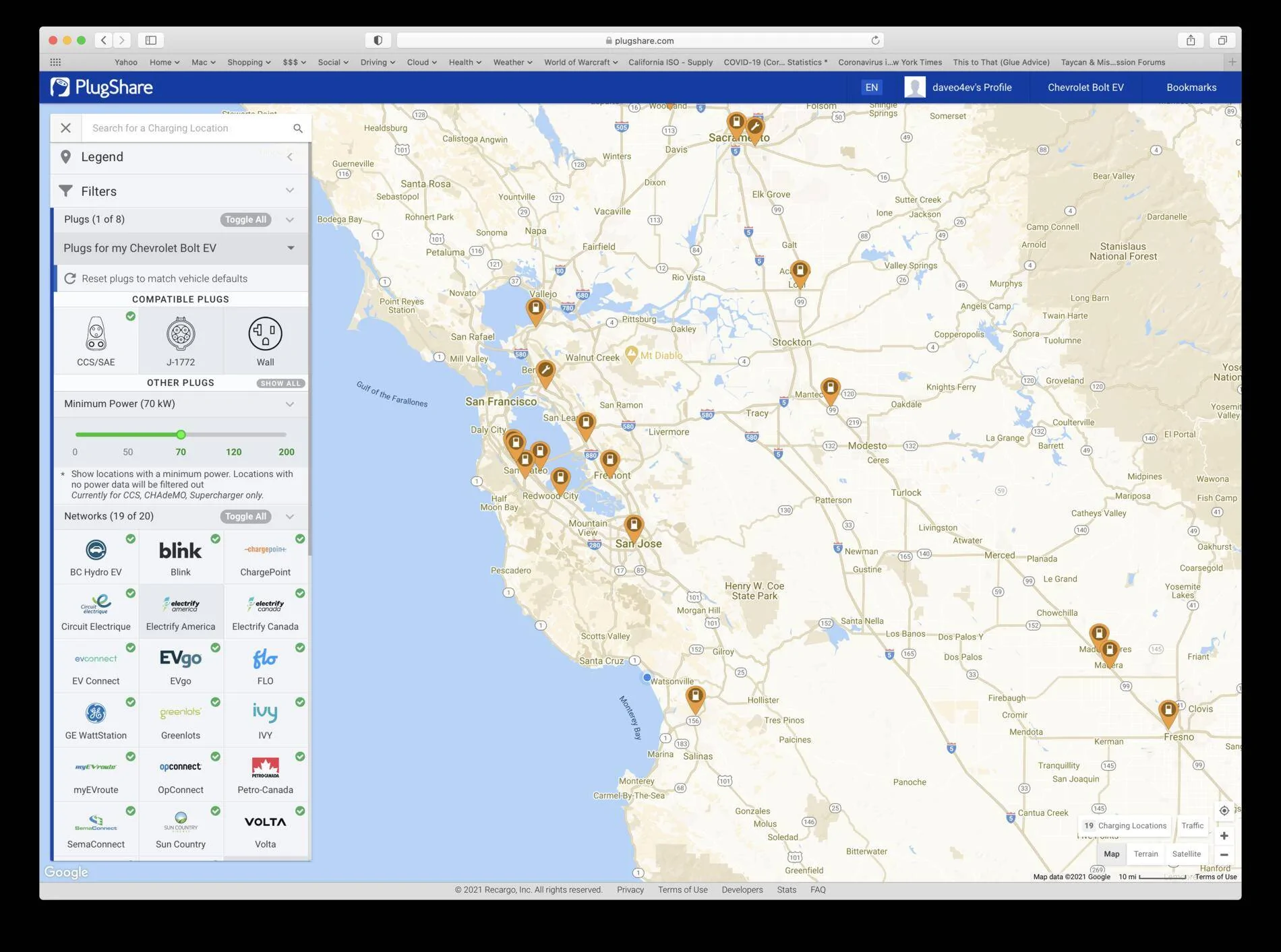

So in order to stop discussing this "in theory" I decided to embark on a quest to find a 400V FastDC charger that is greater than 50 kW - and then visit this charger and observe first hand what my charging speed was during a charging session.
In order to do this I turned to the trusty "plug-share" application and setup up a charging station filter as seen below:
Porsche Taycan [US] - attempts @ real world testing for 400V > 50 kW - adventures continue - data is shared here! Screen Shot 2021-02-13 at 2.47.55 PM
I turned "off" ElectrifyAmerica because I don't know if they have or don't have non-800V charging stations - so I focused on any charging stations that were CCS/SAE - 70 kW or great - and not Electrify America.
that filter yielded this set of chargers in my area:

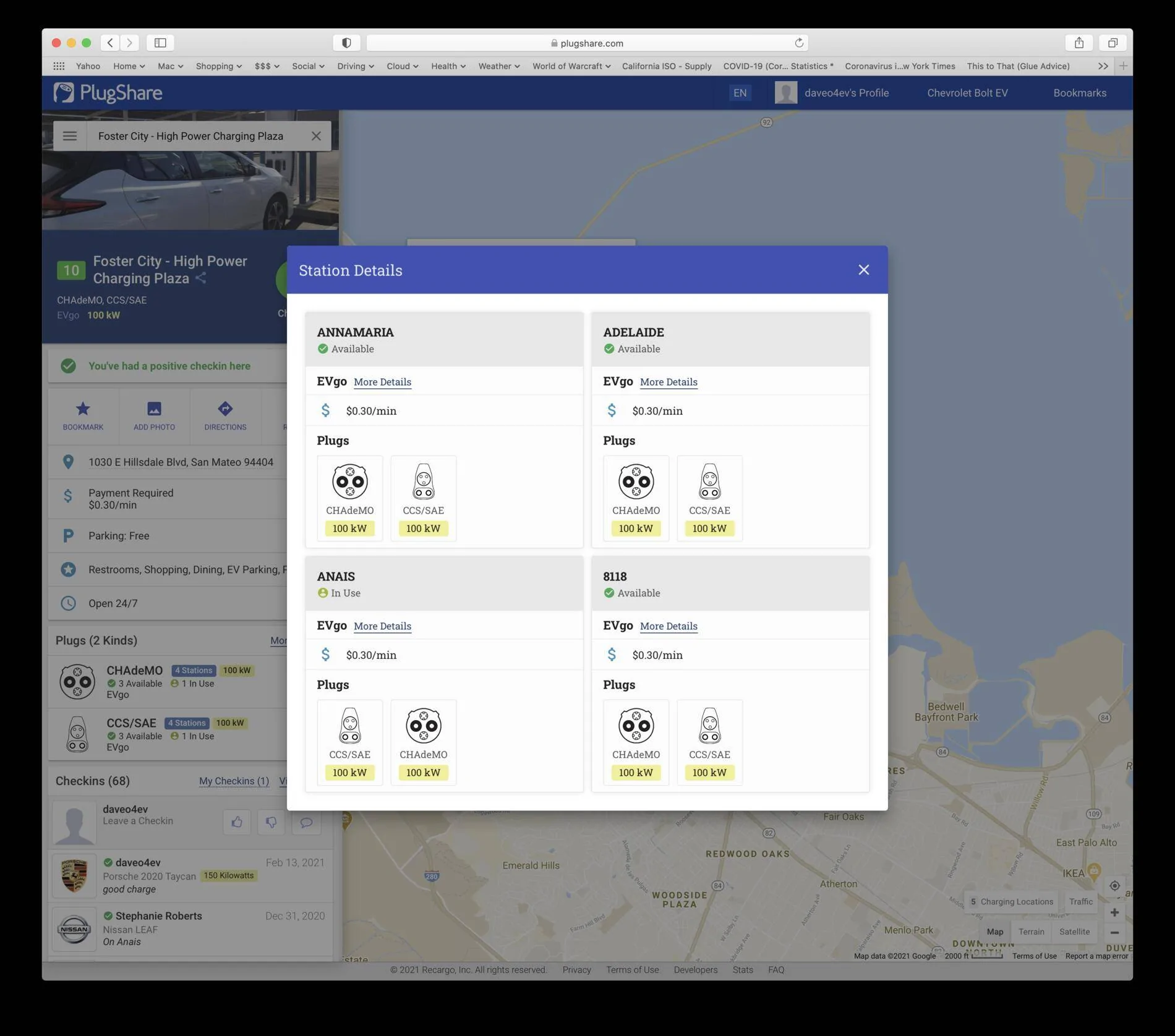

I then reviewed the list and selected a charger that was likely to be useful for this test. I wanted to travel far enough from Santa Cruz such that my SOC would be down to allow a maximum charge rate, but I didn't want a "real road trip" - I also wanted to drive to a location that had more than one > 50 kW charger incase I encountered congestion or equipment difficulties. I eventually chose this quite nice EVGo station in Foster City…
Porsche Taycan [US] - attempts @ real world testing for 400V > 50 kW - adventures continue - data is shared here! Screen Shot 2021-02-13 at 2.55.46 PM
I felt there was a good chance EVGo stations are not 800V - and both the EVGo application and Plugshare reported the stations were more than 50 kW.
At this point we encounter one very interesting fact on this little question - none of the EV charging data sets (Porsche,NAV PlugShare, EVGo) could agree on the "maximum" charge rate for this particular station.
  • Porsche In-Car Nav: lists this station as 30 kW​
  • EVGo's own App: lists this station as 80 kW​
  • Plug-Share: Lists these stations as 100 kW​
so right off the bat - it's very unclear what the maximum charge rate is at these stations at this location - the only way to tell for sure is to actually "visit" the station.

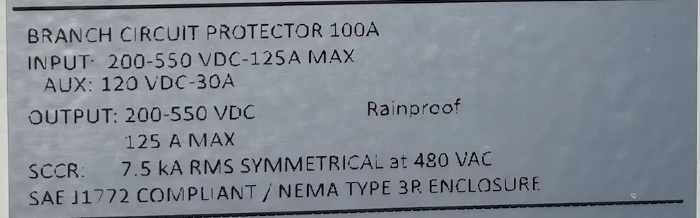

1st off the station is _NOT_ an 800V station - the power sticker on the side of the station lists DC output in the range of 200-550 VDC

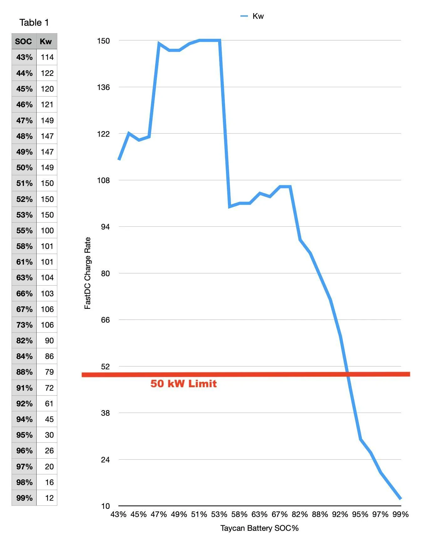

below is the raw data and a chart tracking the charging session from 43% SOC to 99% SOC
Porsche Taycan [US] - attempts @ real world testing for 400V > 50 kW - adventures continue - data is shared here! Screen Shot 2021-02-13 at 3.14.44 PM
as you can see the Taycan is a rock star for sustained non-tapered charging rate - and doesn't drop below the 50 kW charging rate until around the 93% SOC - so for 50% of the SOC (93% - 43% where we started) the charge rate is above the 50 kW rate - that means for charging from 0% to 93% you _WILL_ benefit from the >50 kW option should you encounter one of these chargers in the wild.
the entire session was a clean 45 minutes - and delivered 52 kWh in 45 min - that an adjusted average rate of charge of 70 kW
at the maximum rate of 50 kW the same session would've take 60+ minutes or 33% longer…if we had been charging from a lower SOC (say 10%) the higher sustained rate from 10% to 43% would've made a significant difference in charging stop time saved…
to me the data pretty clearly indicates this is a win for a easy $460 option in terms of time saved.

what are my thoughts:
  • there are stations "in the wild" that are >50 kW and not 800V - without this option you can't use those stations at their full capacity
    • this experiment proved that
  • the Taycan dropped from 150 kW to 100 kW at 55% SOC - I don't know if that was the car/battery or the charging station - there is no way to tell
    • I'm going to agree with @andrewket and guess it was the station and not the Taycan
  • it's pretty clear to me _NO ONE_ actually knows the actual maximum charging rate - this station was supposed to be 80 kW according to EVgo but I got 150 kW for a significant potation of the session
    • who's to say "maximum rated 50 kW" stations can't go faster - if you don't have the upgraded hardware you'll never know how fast you could've charged
    • also I think as stations continue to get installed there will continue to be a "mix" of 400/500V stations and 800/900V stations - I don't think it's reasonable to assume all new/future installs are going to be 800V
  • I obtained 52 kWh or 56% SOC in 45 minutes - that is a rate of 1.25% SOC per minute of charge - we can extrapolate that the 5% to 43% run would be 30 minutes - I'm going to call it 25 minutes cause there will be less tapering at the lower SOC's
    • that's a total estimated charging session from 5% to 99% of 45 + 25 or 70 minutes - 1 h 10 min to charge a Taycan from 5% to 99% - that's really quite good
    • if you didn't have the upgrade the estimated time at a maximum rate of 50 kW would 104 minutes - or 1 h 44 minutes
    • the slower option would take an extra 34 minutes of "waiting" for your car to finish charging.

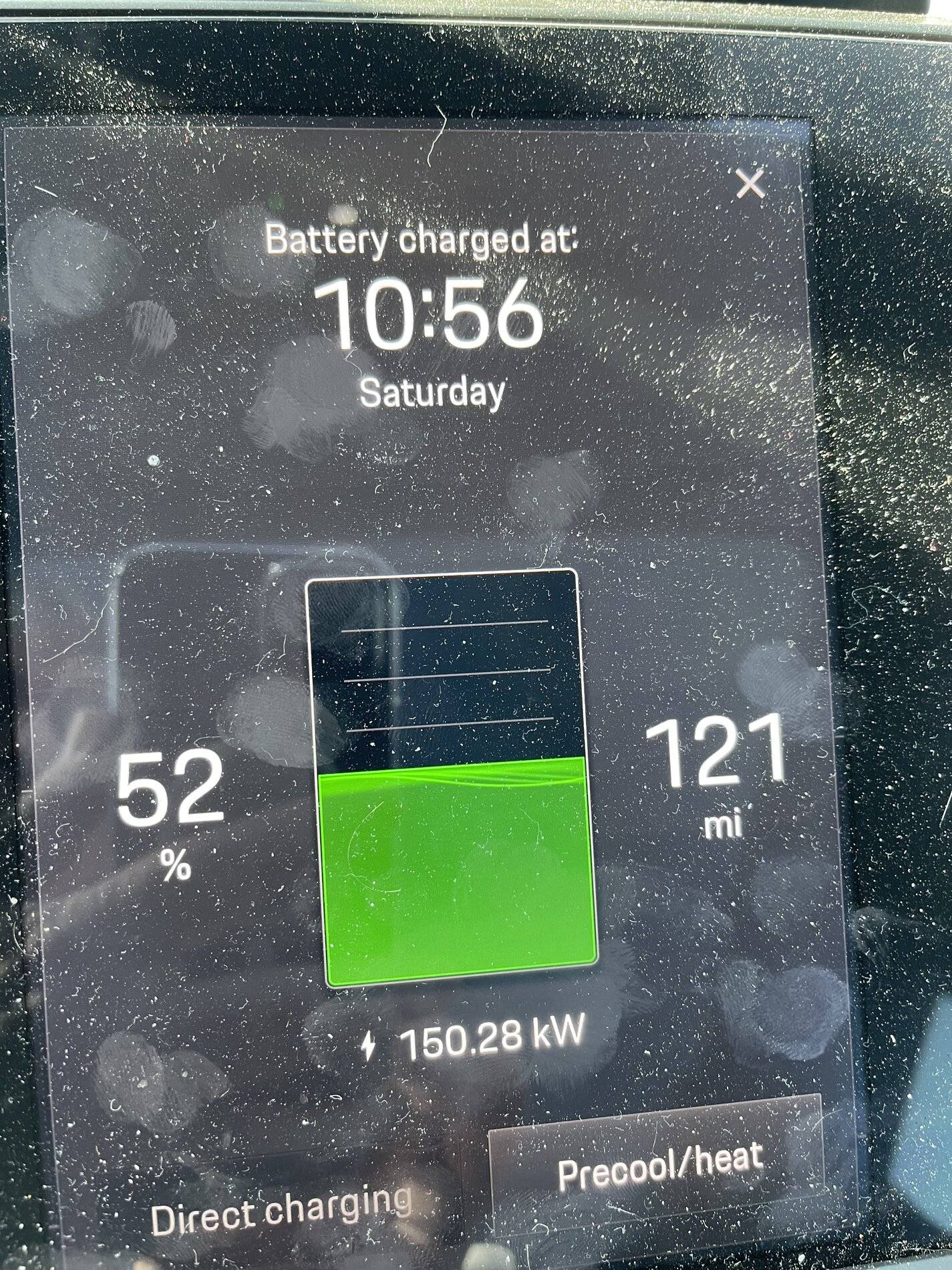

what really caught my attention today is that my Taycan charged at 150 kW at an 80 kW maximum charge station today in Foster City - and honestly I think these maximum rate chargers are fuzzy math - I'm going to test some 50 kW stations next to see if they are really limited to 50 kW - my bet is they are not - and they can pump out more like 60 to 70 kW - again exceeding the specified maximum - Kinda like how the Taycan is limited to 9.6 kW in the US- but really it's not - it's 11 kW in the US cause it's the same 11 kw AC/DC converter Porsche ships to the rest of the world…

if you visit the foster city location
1030 E Hillsdale Blvd, San Mateo 94404
I used the charger named "Annalise"
4 stalls - all were unoccupied - when I started - a Nissan Leaf plugged in about at the 90% SOC point during my session
it was 10 Amish in the morning - air temp was 57F, battery temp was 82F at the start of the session…sunny partly cloudy.

The spec tag that you showed clearly stated 125 Amp Max up to 550 volts, even at that voltage which I do not believe Taycan DC-DC converter would even use you would only have 68 KW Max. I do not understand how you got the 150 KW that you show on your screen from a charger with that kind of tag.
I'm very familiar with the 125 amp Big boy Chargers that evgo uses, I have charged at dozens of them with my Chevy Bolt. There I get about 48kW, as the voltage is lower.
I know! right! and even when it dropped - it dropped to 100 kW! I really wondering about all this.

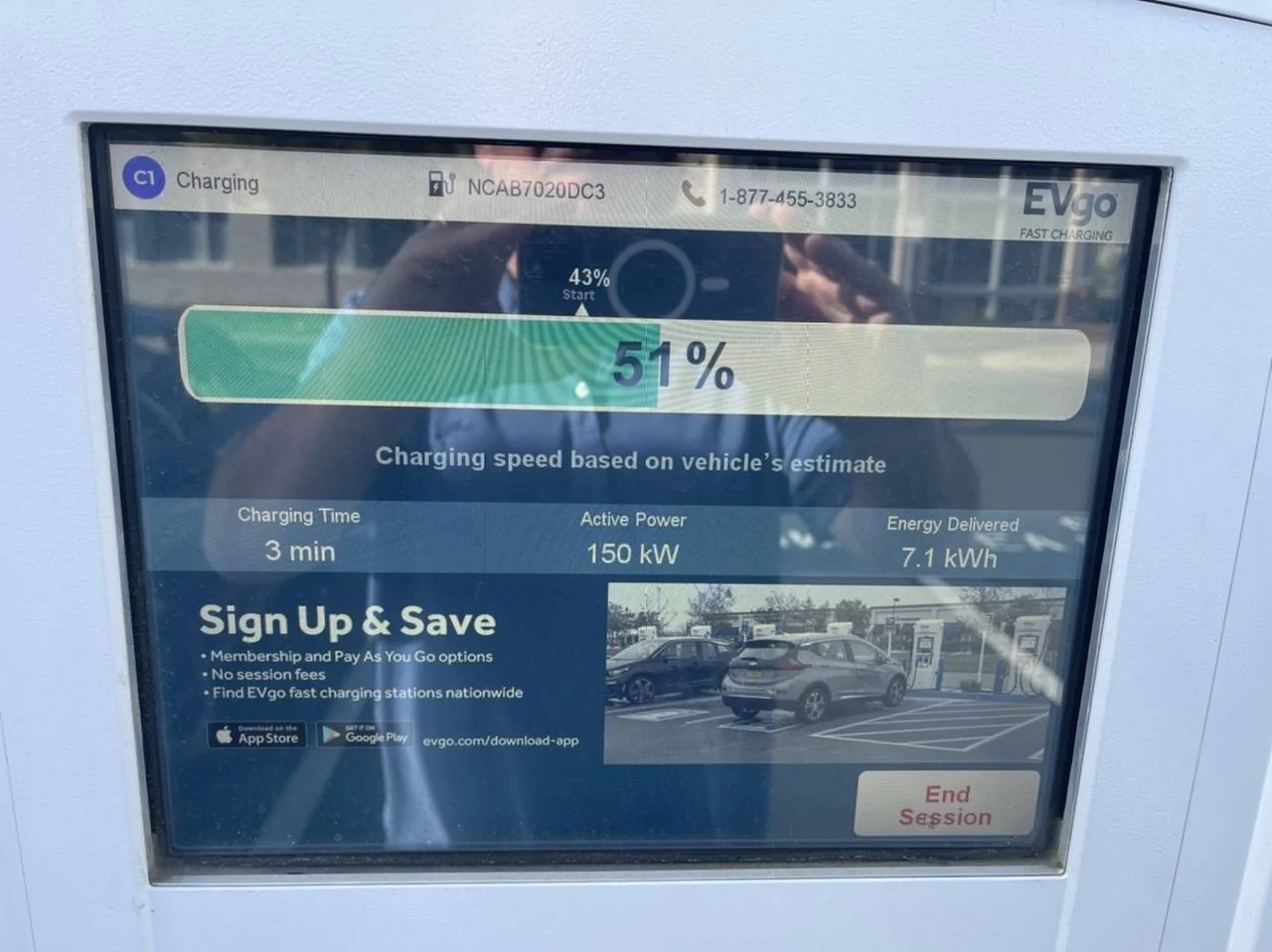

here’s a pic from the charger’s perspective showing 150 kW 3 min into the session - and already up to 51% from 43% when I started…at this point in the charge session 7.1 kWh had been delivered - that’s an average charge rate of 142 kW in that 3 minutes - the station immediately provided a very very high charge rate.
the fact that there is so much uncertainty re: charger voltage/max kw has led me to add the option and just forget about it. though still curious to see what charging rates @ron_b sees at the same or similar station!
