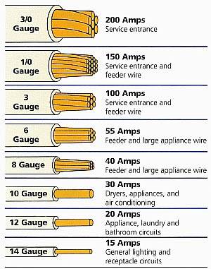

Most people these days are running a set of 6 (or sometimes 8) gauge wires to their garage for EV charging.
I installed my EVSE in 2015 and the one thing I wish I had done is run 3 gauge THHN wires. Had I done that, I would be set for a world where we have two EVs in a home being charged at the same time. I have a Taycan and a Tesla and while its rare to need to charge both at the same time, once or twice a year I need to do this.
Keep in mind the bulk of the installation cost is running the wires. Moving from 6 gauge to 3 gauge THHN will cost more but will be more "future proof". The numbers:
8 gauge NMB can supply up to 32 amps for one car (80% of 40 amps for 8 gauge NMB)
6 gauge NMB can supply up to 40 amps for one car (80% of 55 amps for 6 gauge NMB)
3 gauge THHN can supply up to 90 amps, or about 40 amps each for two cars (80% of 115 amps for 3 gauge THHN)
When you go fatter than 6 gauge, you'll most likely want (need) a sub panel in the garage. You can run 14-50 connectors from the sub panel to supply power for the EVSE's. Or you can direct connect the EVSE's to the sub panel.
