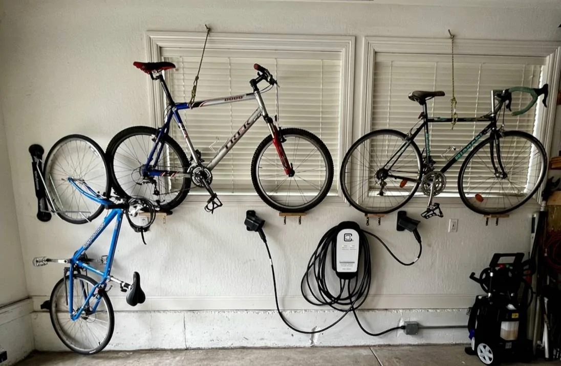

FWIW, I'm happy with the Clippercreek HCS-D50 -
40 Amp Dual Charging Station, Level 2, 240V, 25-foot cable, Hardwired
It was simple to install hardwired to a 50 amp breaker.
The 25' cables are pliant, easily manipulated, and long enough to comfortably reach two vehicles in the garage.
The "dual" feature works "all by itself," piping e's to either vehicle as needed
My home is 5 minutes from a 150 KWh fast charger - so when I'm short of time and charge, I'm able to add ~5mi/minute close to home. Otherwise, the 40 amp charge rage for home use is totally adequate.

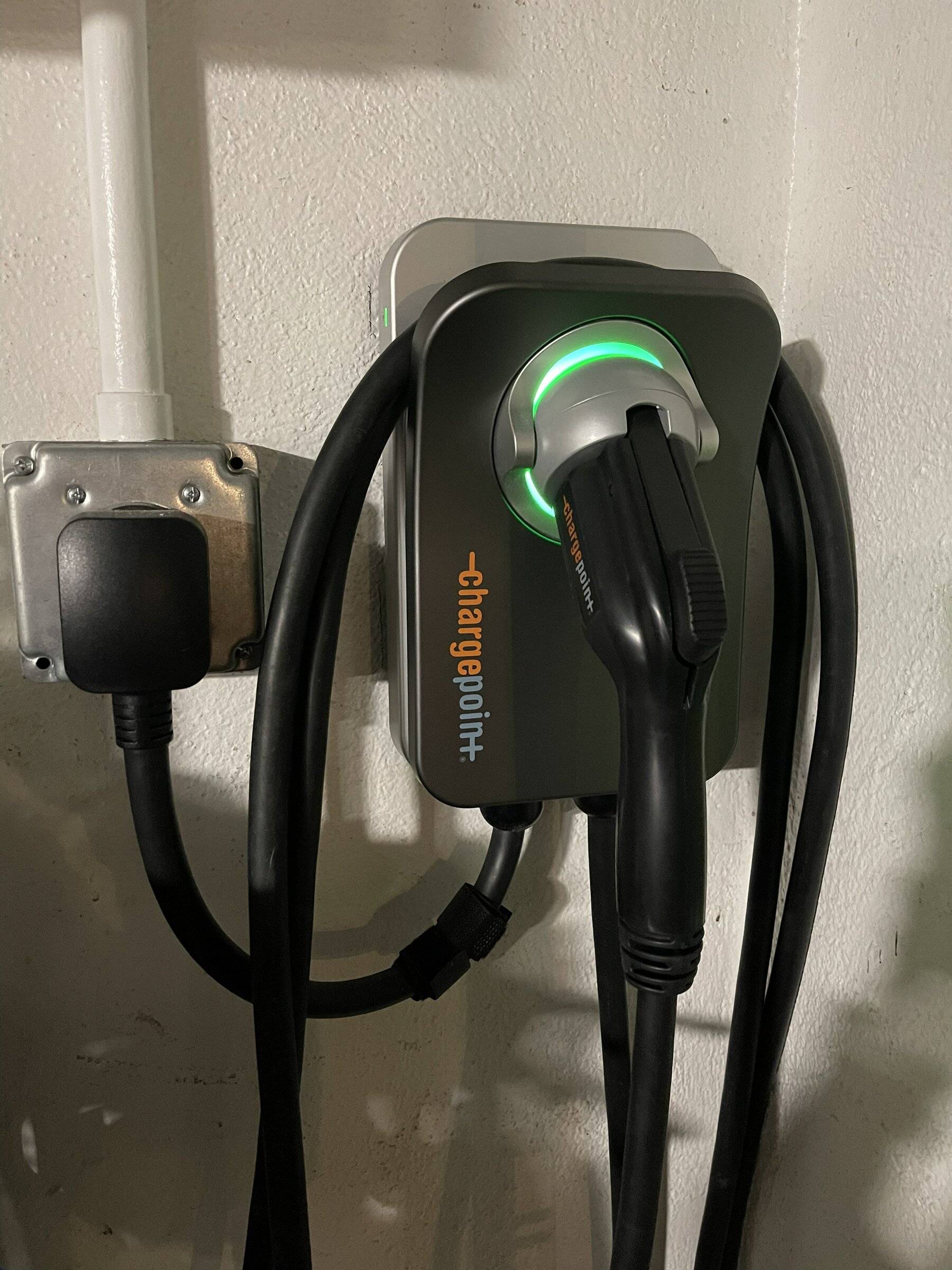

Love my ChargePoint HomeFlex (Daveo4Ev's info in a post and some other users here helped make my decision).
