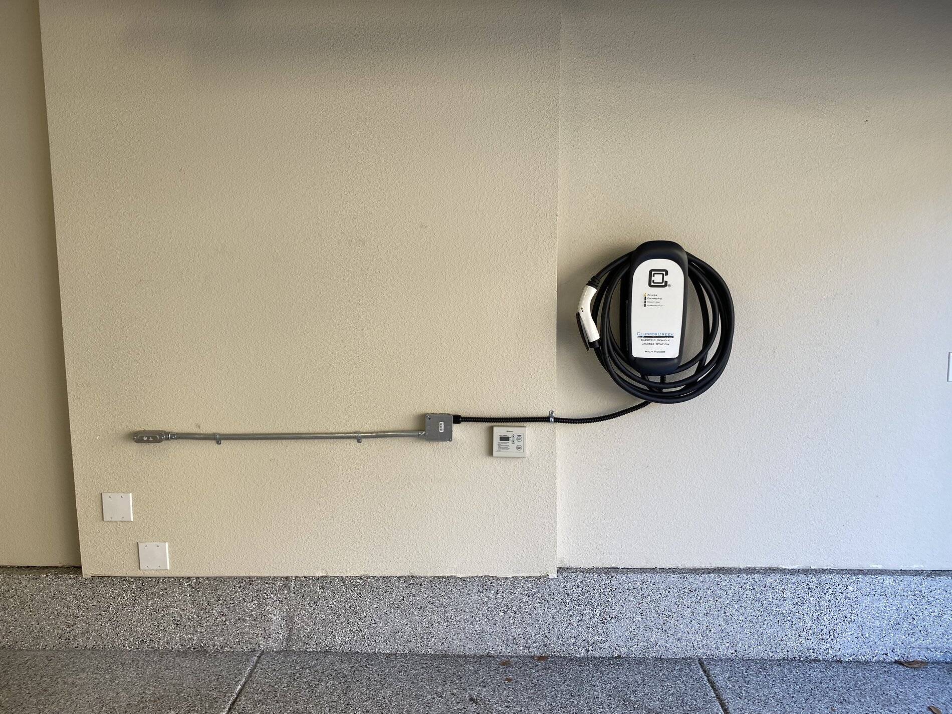

Thanks to this thread I ended up with the right charger for my needs. Didn’t end up clicking the 19.2kw option which actually would have only costed me another $3000 incl the updated charger, but frankly I don’t need those 3-4 hours of quicker charger since my daily use is < 20 miles.
Ended up with the 11kw charging option instead:
