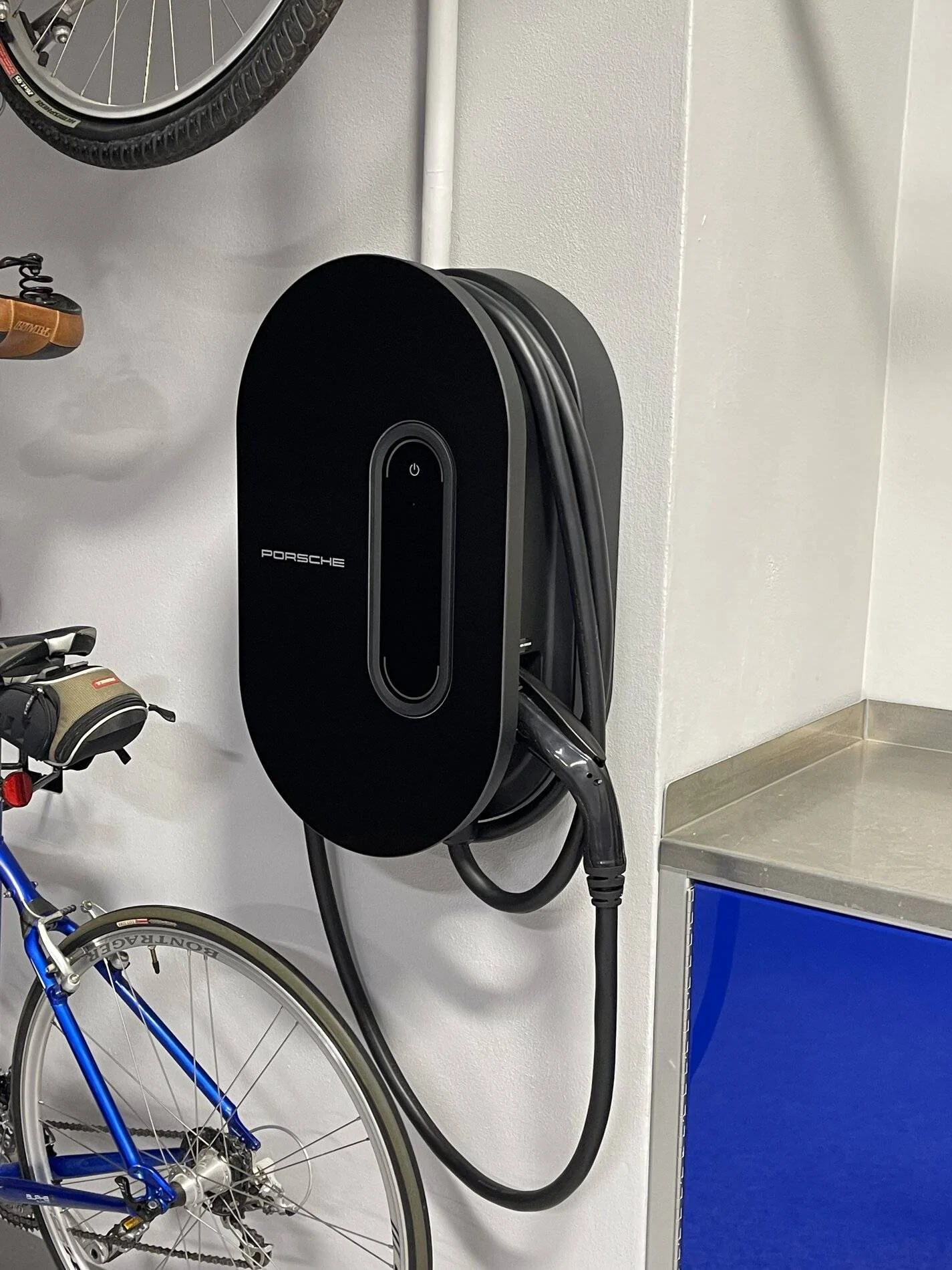

here is the install manual for the Porsche North American 19.2 kW EVSE…
breaker/output settings from 10 amp to 80 amp (charging capacity)
dip switches for 240V, 120V, 208V
only sadness is a 14.8 ft charging cable - a bit short for a $1600 charger
160
5,810
8,646
only sadness IMHO is the 14.8 ft charging cable vs. industry standard 25 ft - for a $1600 charger I’d expect a 25 ft charging cable
I wonder if the 25ft charging cable part for the PMC+/PMCC is compatible with this charger?
5 hour charging times are nice but only required when car is nearly empty - daily usage will be much much less…
there is a table of settings for charging rates from 10 amps to 80 amps - so this is a good flexible charger and can be installed with virtually any breaker size
also has dip switchs for 120V/240V/208V power sources…
this is a competitive 100 amp EVSE inline with other offerings of similar quality and feature set.
the only thing it’s “missing” is any apparently ability to share load with other EVSE like ChargePoint, ClipperCreek, Tesla Gen2/Gen3 Wall chargers - allowing one to install multiple EVSE’s that share a single breaker and split the load while charging multiple vehicles…
however I believe that functionality is supported by the Porsche Home Energy Manager product which is not yet a thing in North America - so Porsche has this functionality but it’s not yet available in North America - time will tell…
based on the specs and price I see _NO_ major reason not to consider the Porsche Charger if you’re starting from scratch with an EVSE install - a minor reason would be to consider EVSE’s with split load functionality for your eventual multi-EV household - but I’ll spot Porsche the difference here and assume once/if the Home Energy Manager becomes an offering for North America that it would support that…
otherwise in this category of EVSE I’d consider something like the ClipperCreek 80/100 amp chargers with share2 functionalty so that you can charge 2 EV’s off of one single breaker.
but kudo’s to Porsche for this well priced and competitive offering - it’s a great choice for most Porsche Customers.

Great to have more options and finally reasonably priced (including the plastic dock).
If I did it again, I'd still opt for the PMCC + Docking Station because I like the flexibility of having it not hardwired with a 14-50 outlet.
My other locations will be the docking station + PMCC on a standard household outlet. I'm very happy with my setup so far and it looks great.
There is an abundance of PMCC and docking stations as I have a lot of people reaching out that they have one for sale=).
If I drove more, utilized the charger more, I would not use the PMCC and go with a ClipperCreek for a bulletproof and safe setup.

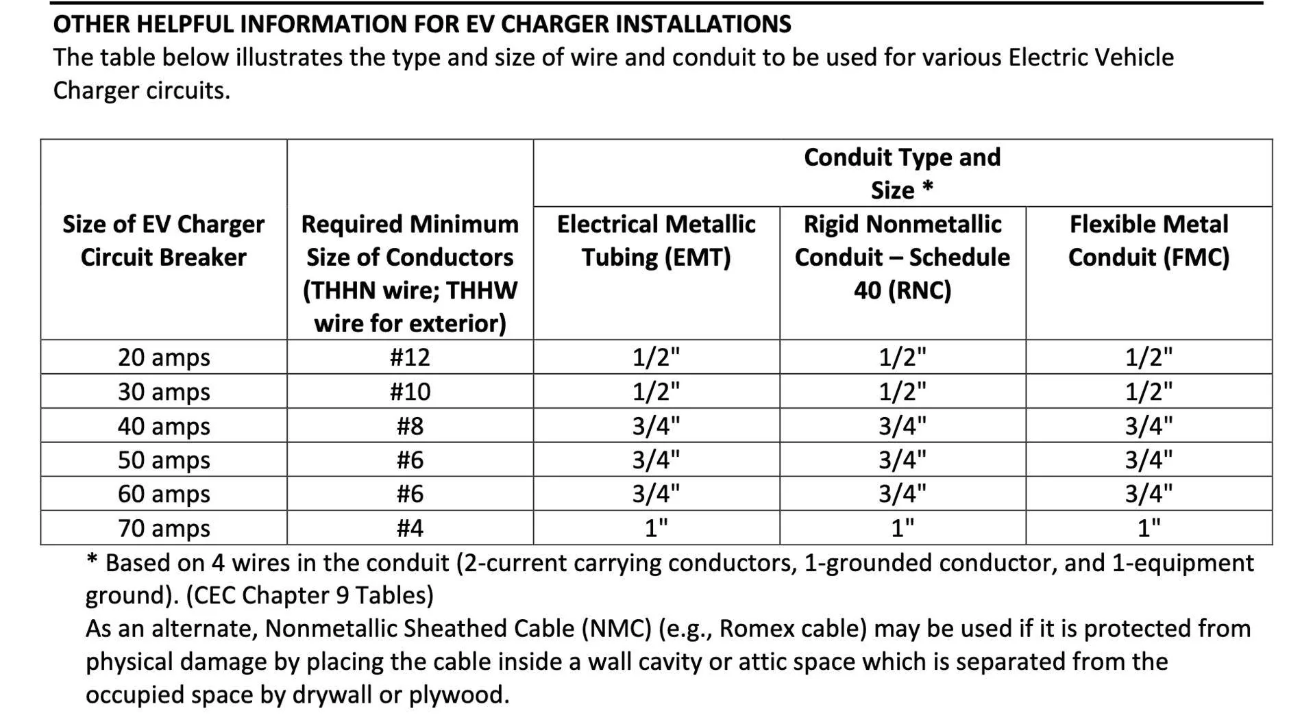

Thanks for the information about EVSE in home garage, and future-proofing. Couple of questions.
--I plan to have work done by licensed electrician - info is for my planning. --
1. I understand at least some 220v EVSE units only require 3 conductors. To meet electrical safety and code requirements, should a circuit having a NEMA 14-50 receptacle be wired with 4 conductors or 3? Is either ok for safety and code, or does it depend on what the receptacle -which has contacts for 4 wires - is used for?
2. If I want to start by using a plug-in 40 amp EVSE on a circuit with NEMA 14-50 receptacle, but have the ability in the future to convert that same circuit to a 48 amp hard-wired EVSE requiring a 60 amp circuit breaker, is it ok for electrical safety and code requirements to initially install wiring and circuit breaker sized for 60 amps, but use NEMA 14-50 receptacle and 40 amp plug-in EVSE? (At some point in the future the same circuit could be hardwired to a different EVSE and the receptacle removed.)
Jhenson29
Jeremy
Feb 9, 2021
2,803
4,190
St. Louis, MO
14-50 receptacles have to have the neutral connected.
The EVSE just won’t use it.
No. Wire can be upsized if the terminal it is going to is rated for the size, but the breaker needs to be 50 amps.
