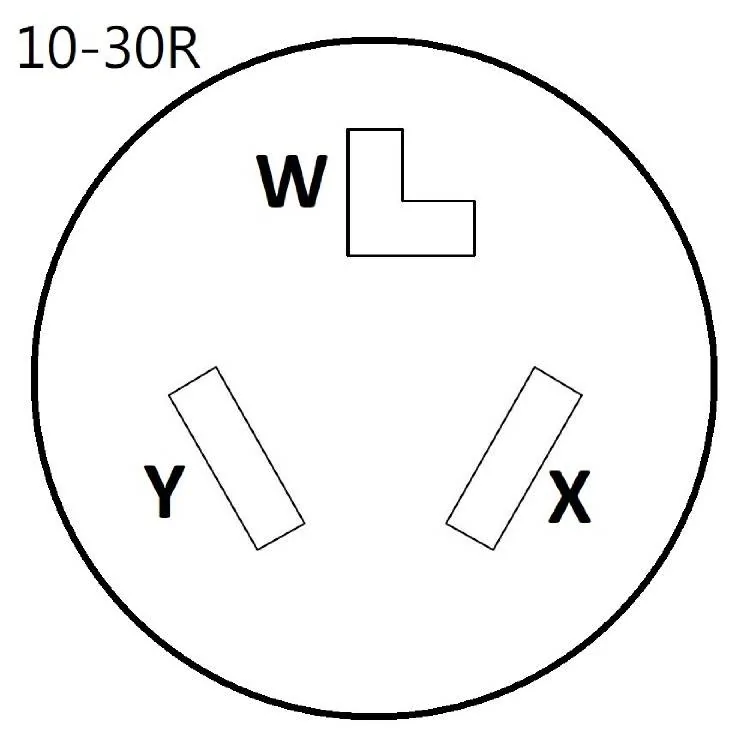

Level 4 - I have an unused 30 amp circuit in/near my garage - NEMA 6-30, 10-30, 14-30 plug 5.76 kW - 240 volts @ 30 amps (24 amps for charging)
Porsche Taycan [US] - Over the Top - the well equipped EV home garage…for those that wish to "over do it"… 150px-Nema_6-15.sv
Porsche Taycan [US] - Over the Top - the well equipped EV home garage…for those that wish to "over do it"… 201901175c40777316a1b
Porsche Taycan [US] - Over the Top - the well equipped EV home garage…for those that wish to "over do it"… NEMA-14-30-PLUG-DIAGRAM-(w)-800x800
(16 hours for a full charge from near zero % battery)
this is the bare minimum for an EV owner in my humble opinion but honestly will do just fine for most usage. The only issue with this approach is the plug is unlikely to be well located relative to where you'd want it for EV charging and EVSE placement - still it's better than nothing and will offer a healthy 57 kWh for a 10 hour overnight charge or almost 200 miles daily driving range for a 10 hour charge session.​
Porsche sells a NEMA 6-30 or 14-30 adapter for the PMCC that comes with the car, and your electrician bill is likely to be cheap to change/move the plug. This is a great choice and if you already have one of these in the garage it certainly is going to be the cheapest option for getting your EV charging up and going.​
Also a viable option if your electrician says your home can't handle the addition of a 50 amp circuit without a main panel upgrade (expensive o_O:crying::headbang::() - you might be able to get away with a 30 amp breaker - for less $$$​

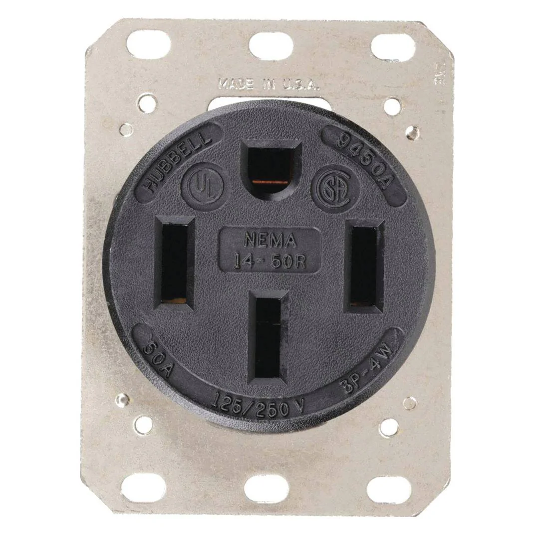

Level 5 - I have or I'm going to install a 50 amp circuit + plug - NEMA 6-50 or NEMA 14-50 - 9.6 kW - 240 volts @ 50 amps (40 amps for charging)
Porsche Taycan [US] - Over the Top - the well equipped EV home garage…for those that wish to "over do it"… 1450_vs_650_large
(11 hours from a full charge from near zero % battery)
this is the recommend path from me and Porsche and the EV community at large - this will exploit the full power of the included Porsche Mobile Charge connect and is the largest circuit one can have installed with a mobile EVSE. NEMA 14-50 can provide a healthy 96 kWh in 10 hours of charging, which is more than the capacity of your Taycan's battery. Daily drives of up to 80 miles a day will be dispatched over night in less than 3 hours of charging time on one of these circuits. This circuit matches the Porsche North American specification for maximum charge rate and is an excellent all around choice.​
There is nothing wrong with this install and it will nearly maximize your Taycan's charging rate and for 98% of your lifetime usage it will never take more than 4 hours to charge your vehicle - this is affordable, easy, and will serve you well over the next several years.​

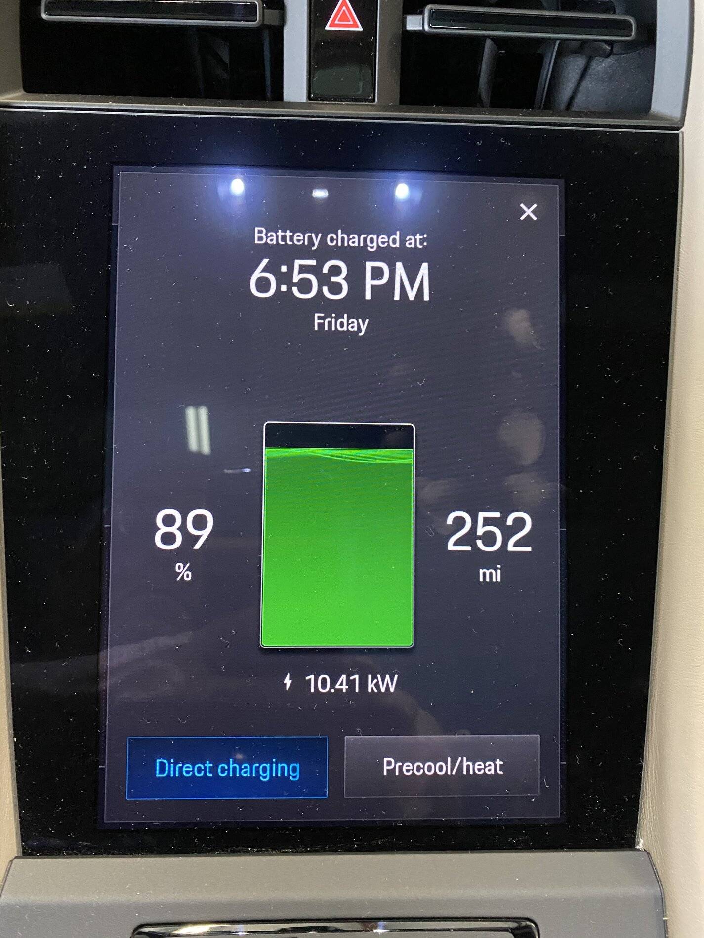

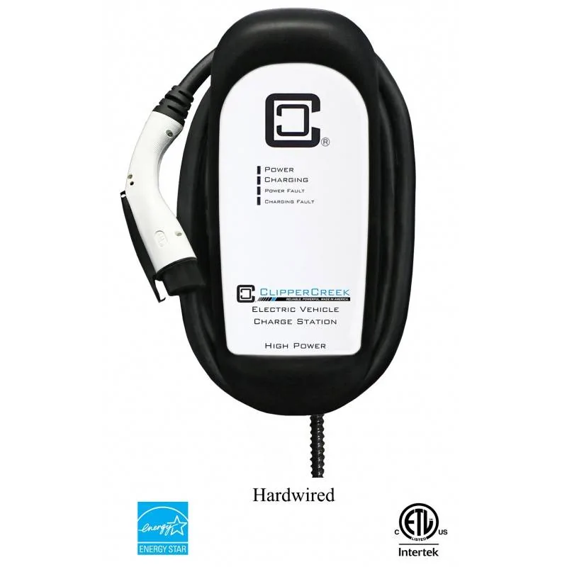

Level 6 - I read Internet forums and I know Porsche is lowballing us with the 9.6 kW specification - my Taycan can actually charge at 11 kW - 240 volts @ 60 amps (48 amps for charging)
Porsche Taycan [US] - Over the Top - the well equipped EV home garage…for those that wish to "over do it"… HCS-60 with cert and energystar-800x800
(8.5 hours for a full charge from near zero % battery)
it turns out the maximum charge rate for your Taycan is not 9.6 kW, but in fact 11 kW like the rest of the world. However to realize that charge rate you'll have to install the Porsche Wall Charger or a non-Porsche EVSE (no problem 100% confidence in this approach - honestly no big deal) - but the charger will NOT be mobile, it will be hardwired.​
However to realize this you need to have a 60 amp (or more) circuit installed and purchase something like a Porsche Wall Charger, ClipperCreek HCS60 EVSE or Tesla Wall Charger Gen2/Gen3 (or others) - this will charge your Taycan at it's true maximum charge rate of ~11 kW - meaning in 4 hours of charging you can pump 44 kWh of raw unbridled power into your battery - leading to a driving range of just over 140 miles range. Your wimp-ass daily roundtrip commute of 52 miles will take a mere 100 minutes of charge time - I laugh at your charge time and think you are too much of a pretty boy to have it this good!!!​

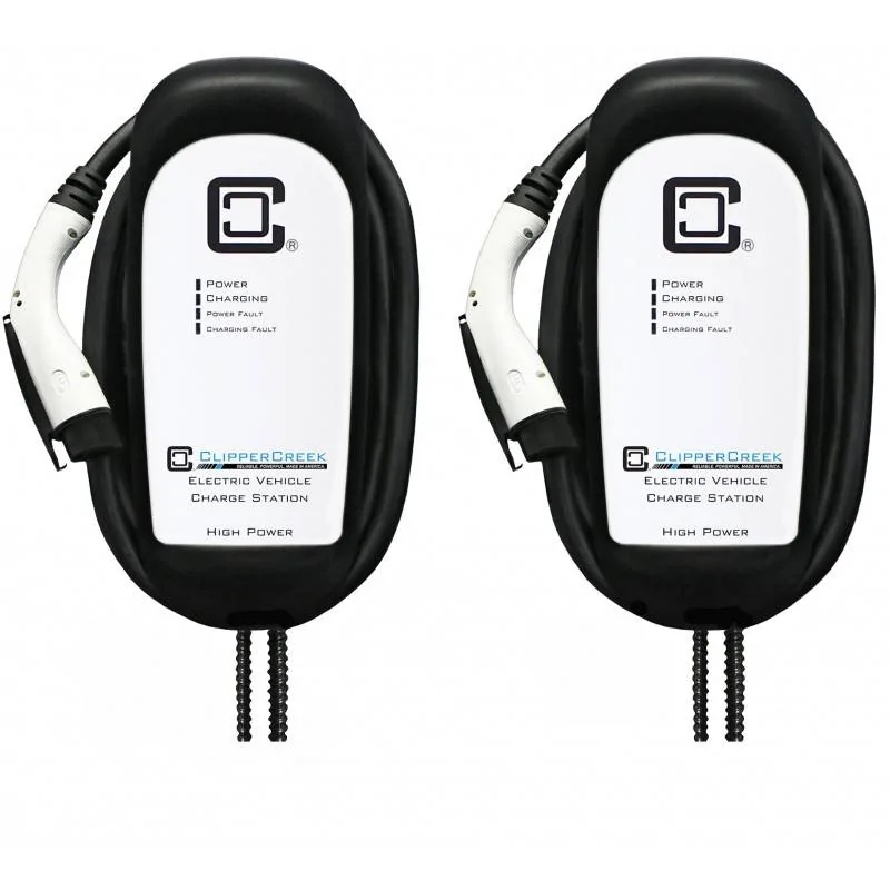

[OCT. 2020 UPDATE] Level 7 - I ordered the 19.2 kW charging option for my MY’2021 Taycan - Porsche missed the memo that even Tesla no longer shipped EV’s witih more than 48 amp L2 charging on board.
ClipperCreek HCS 100 (100 amp breaker) - 19.2 kW of charging goodness!
80 amps of charge rate!!
(6 hours or less for a full charge from 0% battery)​
Congratulations you’ll be able to charge faster than all of us! I’m quite frankly jealous. 19.2 Kw charge rate can charge the Taycan from 0% to 100% in slightly less than 6 hours. Daily commute distances (70 miles or less) will be dispatched in just about 1 hour of charging. This is the maximum specified charge rate available from an L2 (Level 2) North American J-1772 standard. The _ONLY_ way to charge an EV any faster in North America would be to install a FastDC charger costing 10’s of thousands of $$$ and probably requires rare 3-phase commercial electrical feeds.​
My recomendation for this install is the Porsche Wall Charger, ClipperCreek HCS100 or HCS80 - you’ll need a 100 amp circuit/breaker to achieve the full 19.2 kW charge rate. Consult with your electrician about funding his child’s college education for this installation. The HCS80 w/Share2 functionality is a great choice here but will only charge a 64 amps (15.36 kW) but given it can be shared with a future 2nd EVSE to split the load it’s a great choice.​
Highly recommend a full subpanel in the garage if you’re going this route. A full 150/125/100 amp “sub-panel” with appropriate breakers to match what ever high amp charger you install will lead to EV charging happiness.​

Drum roll please, :rock:this is @daveo4EV ideal over the top totally un-necessary EV garage setup plan for today, tomorrow and the future:​
  • Add a 125 amp circuit to your existing main house panel
    • Route this 125 amp circuit to a brand new 8+ slot 150 amp sub-panel installed in your garage
    • Install a 100 amp breaker as the main breaker in this new subpanel (double breakers for maximum safety, 125 amps at the main, 100 amps on the sub)
  • Install an 80 amp breaker in the new subpanel
    • off of this new shiny 80 amp breaker - install a ClipperCreek HCS80 share2 EVSE (64 amps of charging goodness for your Taycan and future EVs)
      • NOTE: this will not charge your Taycan any faster than the HCS60 - but will potentially charge future EV's faster if they can handle the raw power
      • UPDATE: MY’2021 Taycan’s and beyond have a 19.2 kW on board charging option - to take advantage of this charge rate you’ll need an 80 or 100 amp breaker and matching EVSE - 80 amp breaker = 64 amp charge rate (15.36 kW), and 100 amp breaker = 80 amp charge rate (19.2 kW)
  • Also Install a 50 amp breaker in the new subpanel
    • off of this new shiny 50 amp breaker - install a NEMA 6-50/14-50 plug for maximum easy of use, and flexibility. This plug will be there incase your EVSE is broken (wife has run over the cable and broken your plug) or just testing EV equipment for which you need a NEMA 14-50/6-50 plug handy
A nice juicy 125 amp dedicated circuit to your garage will allow for future dual 60 amp EV chargers to charge 2 EV's at 48 amp each!!! And the addition of a NEMA 14-50 for the pure convenience of having a 14-50 plug handy means that you can test, and play with various EV chargers with a minimal hassle factor. Yes my friends this is how you over do an EV charging setup. 60/80 amp EVSE from Clipper Creek & NEMA 14-50 plug for all your other EV testing/charging needs. All wrapped up in a nice tidy 100 amp sub-panel in the garage so that it's easy to change and play with your EV charging configurations to remain over the top and flexible far into the future.​

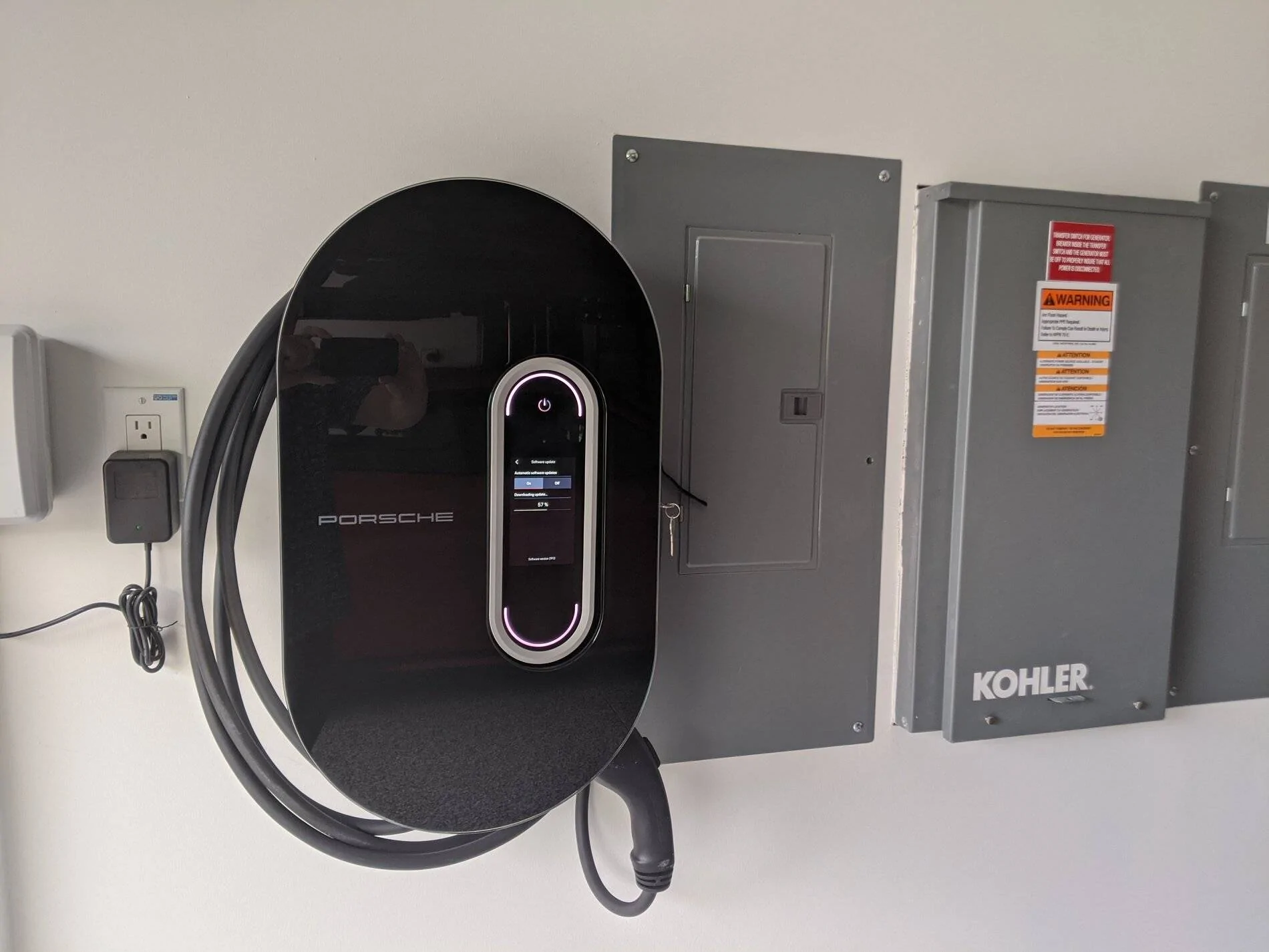

I have a 100 A line (on a 100 A breaker in the main panel) going into my garage where a sub panel has two 50 A breakers which each feed a NEMA 14-50 outlet.
That’s exactly my setup. We’ll likely get another EV next year and wanted to future proof the garage. Since I’ll likely never charge from 0 -> 100% SoC in my garage, the Taycan’s existing charge rate is fine for me.

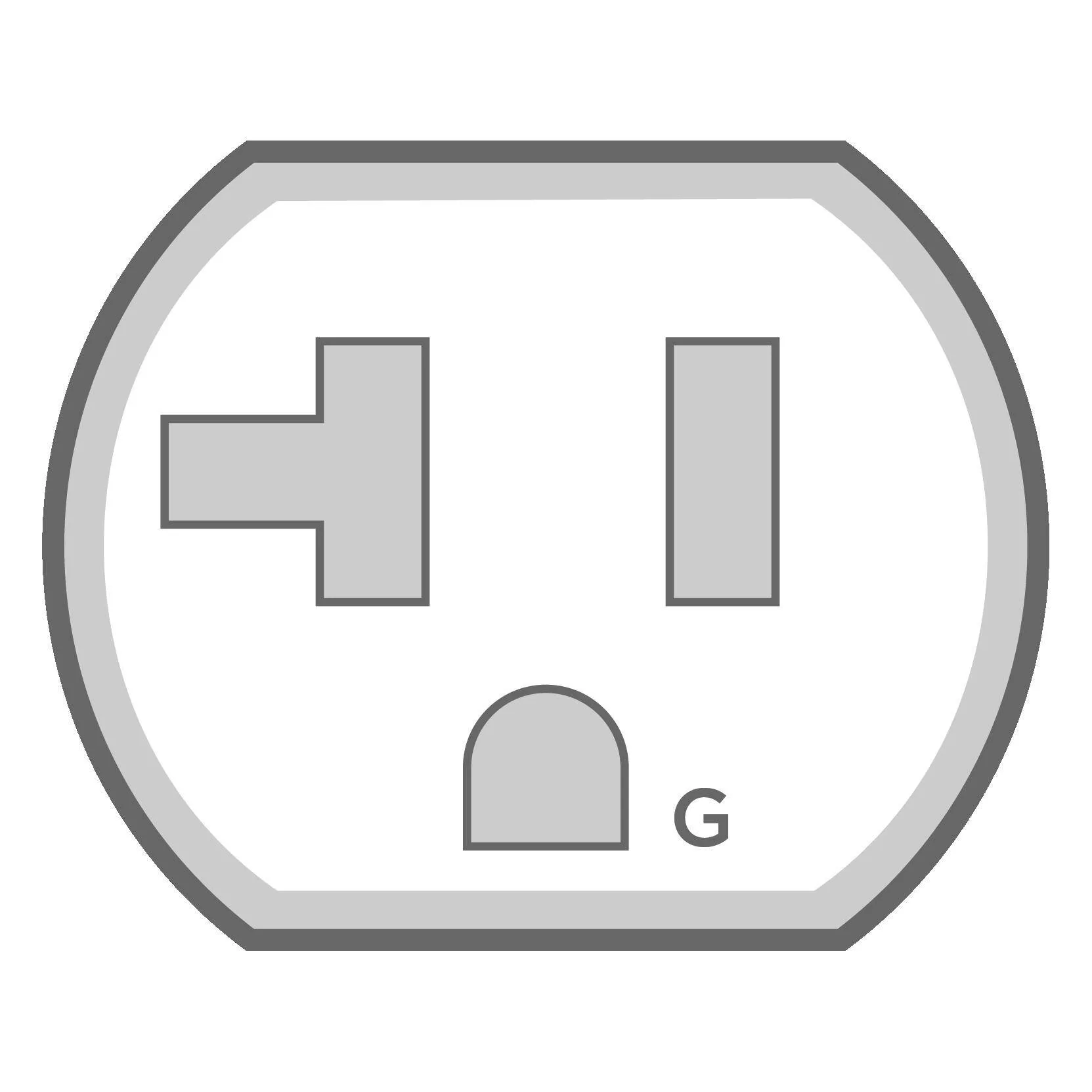

Level 1 - Inadequate but some people try - NEMA 5-15 Household Outlet - 1.44 kW - 120 volts @ 15 amps (12 amps for charging)
(70 hours for a full charge from near zero % battery).
this can be done, and for 8-10 hours over night you can add 12-14 kWh - which is about 50 miles daily driving range - I don't recommend it -but technically it works and most garages have an existing NEMA 5-15 so this is the zero cost I'm going to use what I have approach. In North America the PMCC comes with this plug adapter so it will all just work - but be painful slow for any serious charging demands​
Level 2 - Slight better but still Inadequate - NEMA 5-20 - 1.92 kWh - 120 volts @ 20 amps (16 amps for charging)
(50 hours for a full charge from near zero % battery).
not much better than the NEMA 5-15 but is technically faster - 8-10 hours charging is almost 20 kWh - or about 65 miles daily driving range - again many people might have this already in their garage for an engine block heater or air compressor​
the PMCC does not come with a NEMA 5-20 adapter, and Porsche doesn't sell one - you'd have to buy an EVSE that offers this support - and by the time you're buying another EVSE - why oh why would you stop here? It's documented purely for completeness.​

Well my friends you've come to the right place :cool:. There are steps you can take to make your current EV charging scenario maximize your Taycan charging experience, but also prepare you for your glorious multi-EV future.​
  • Buy an EV with more than 11 kW charging capacity - yeah we've got you covered!
  • Need charging for multiple EV's simultaneously - yeah no problem!
  • Want to have both plug based and hardwire options for maximum ease of use and EV kingdom control - yeah this is the setup for you!

Here: A 22kW charger will supposedly be installed this month. The unit has already been delivered to the installation company, all we need is a installation date.
It took special permission from the utility operator. Usually, the maximum that can be installed is a 11kW unit. But I wanted to be "ready for the future" ;-).
In real life, the car is usually charging between 4 and 10kW, depending on the weather. I have driven the car exclusively on photons for the last two months. Modern photovoltaics are a miracle.

Tom
Aug 14, 2020
96
103
Tampa, FL
911 Carerra 4 GTS, GT4RS

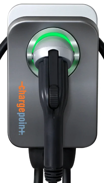

So far all is good with the Porsche Mobile Charger Connect :like:
New house wired with industrial grade NEMA 14-50 receptacle.
I am only charging once-twice per week so this is working for now.
However the ChargePoint Home Flex that can be hardwired for charging at 48 amps looks very tempting...
