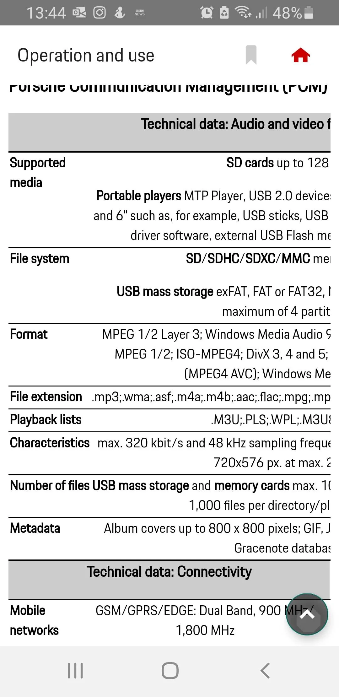

You can attach a USB c drive as a device and manage in the device manager. Have a browse through the Porsche Good To Know App (download it if you haven't already) for media and supported types. This way you'd use the PCM as the head unit to control.
Partial screen grab below
Looks like it won't work with my ALAC files then :( unless their FLAC decoder can do it.

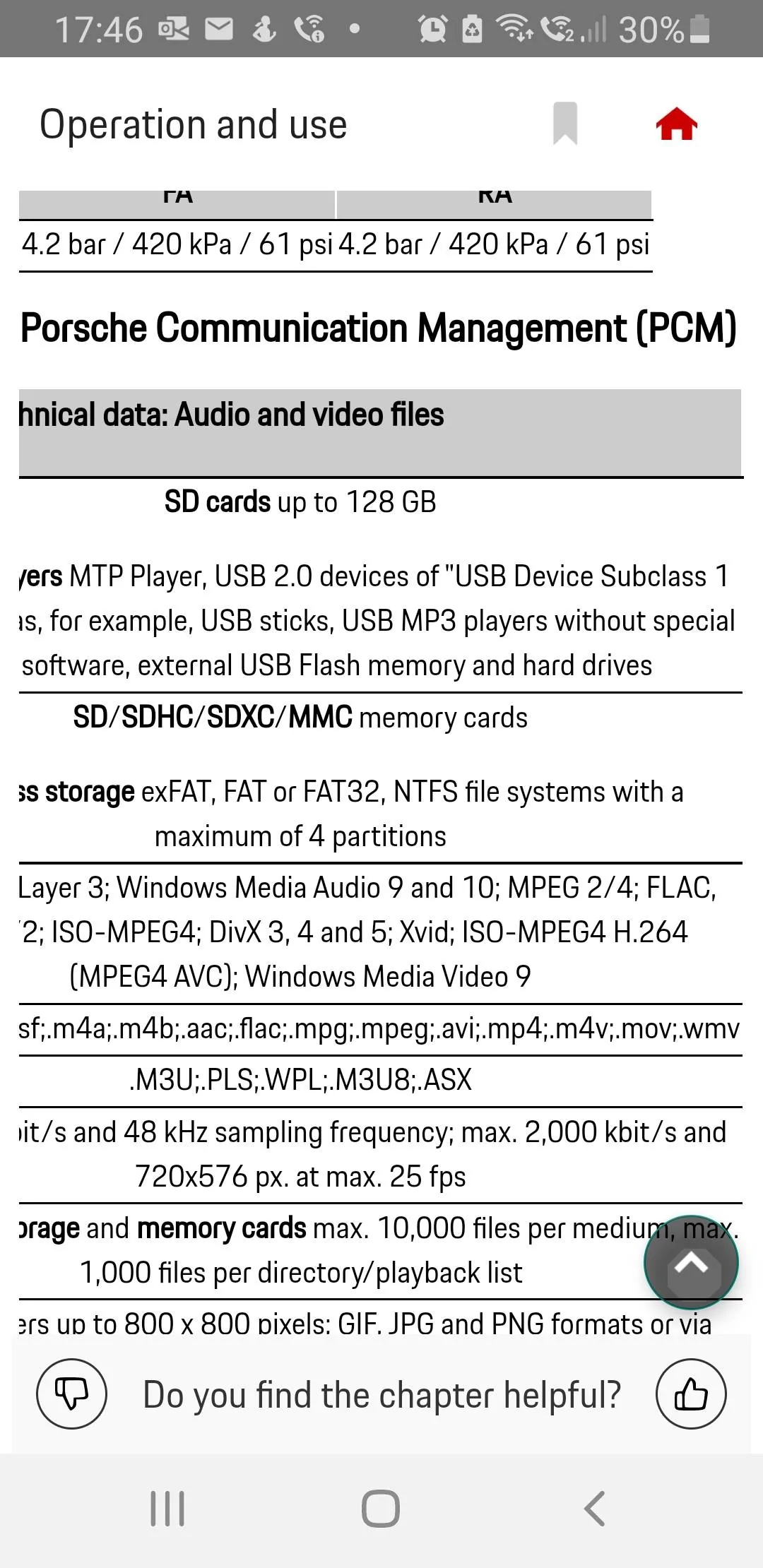

No, flac is supported - it is on the RHS and clipped from my screenshot. This is the clipped part
Yes, I saw FLAC is supported but ALAC isn't on the list and all my files are ALAC, so unless the similar FLAC decoder works on my ALAC files that will be a no go.

Further investigation shows me to be an idiot.
The ALAC files are stored with the m4p suffix so are playable from that compatibility list.
