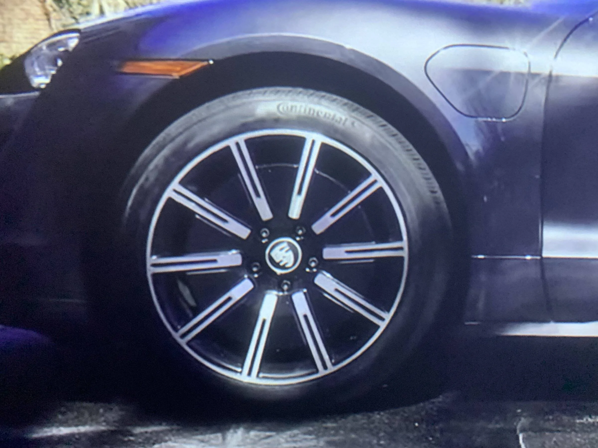

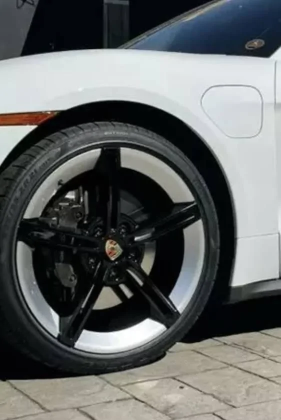

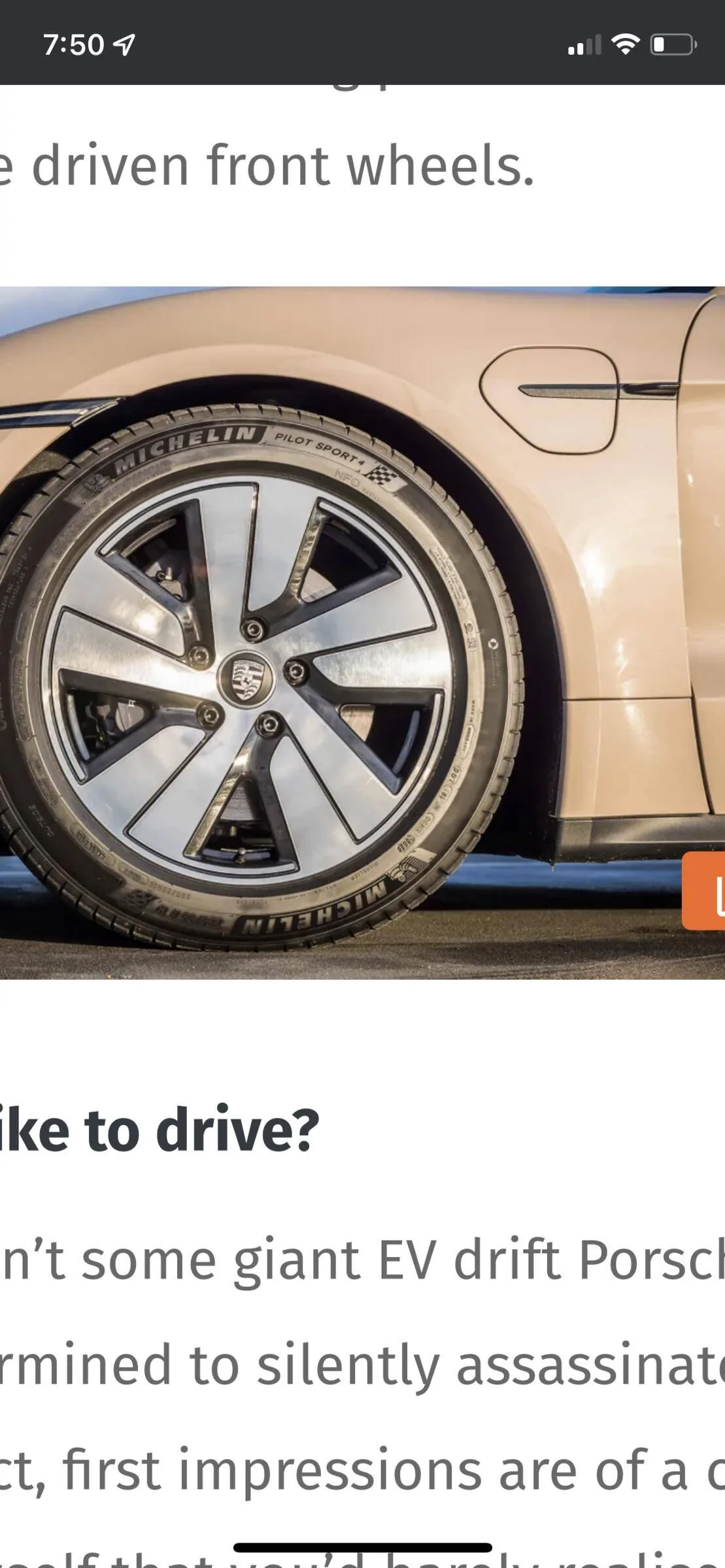

These are some of the pics that have me wondering…. I’m comparing the lower fender line to the centerline of the wheel hub. Very different relative vertical positions.
The rose one is RWD with confirmed air suspension
The blue one is air suspension with CETE modification (from what I understand that would be the lowest air suspension position)
The white one I believe is a RWD spring based on other pics. But I can’t verify that for sure. Finding profile pics of RWDs with verified spring suspension has proved to be difficult.
If the difference is that big I will probably option the air suspension.
Anyone have a confirmed RWD spring profile pic?

Btw nickmbp, great idea on how to find the difference of 1/2”.
And that’s a big visual difference if your talking a 1 1/2” fender gap vs a 1” one.

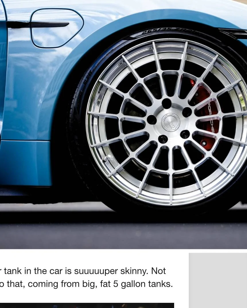

I did just verify on a you tube video. You can move it to the lowest position at least while parked
I did also find a picture of a RWD verified without the air suspension. The alignment of the fender line and wheel centreline is clearly higher. And the wheel to fender gap is clearly larger. I plan on changing the stock rims out with aftermarket 21 or 22” rims. This gap would then be to big for my preferences. Looks like a $2300 option for me.
