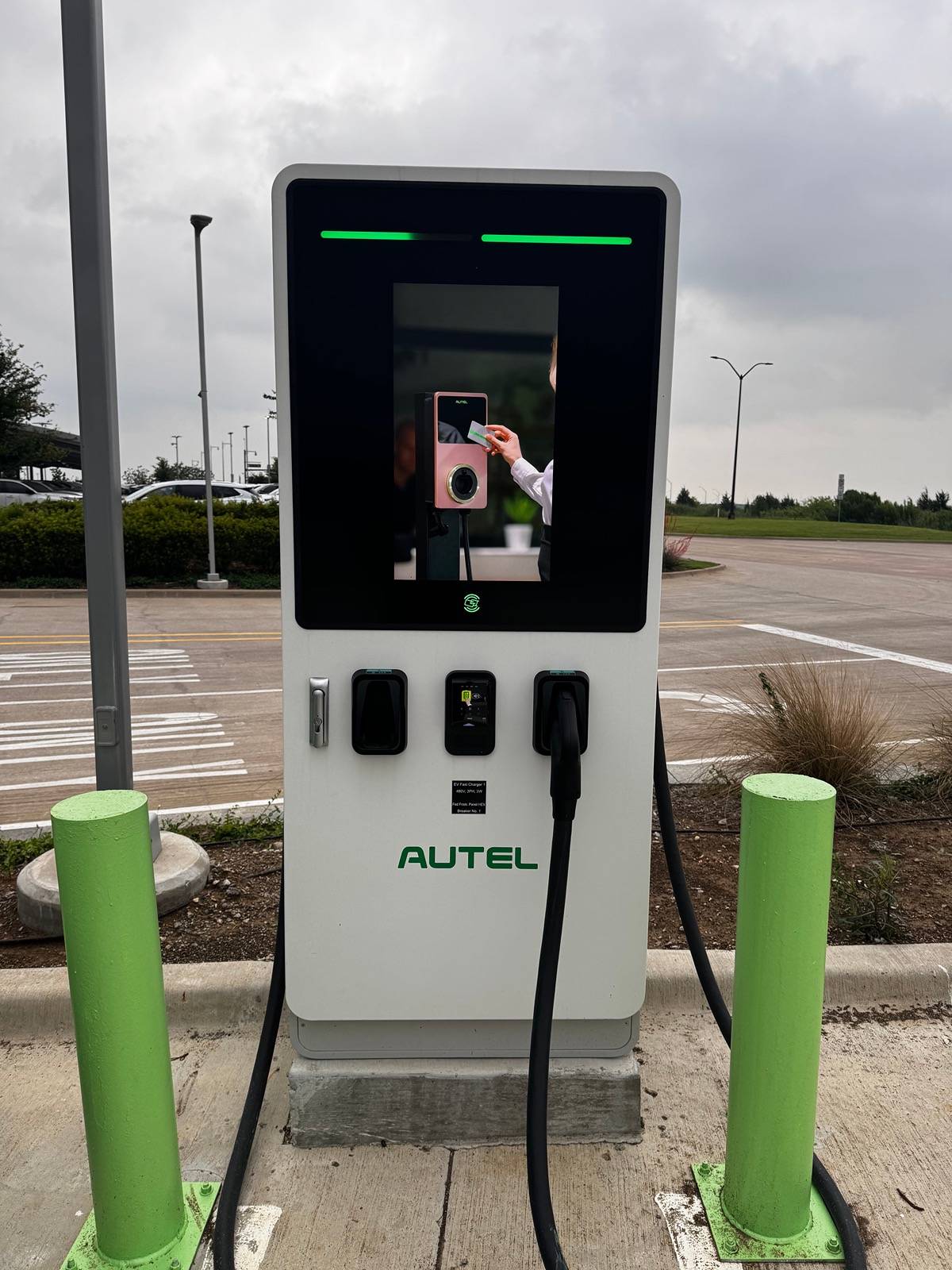

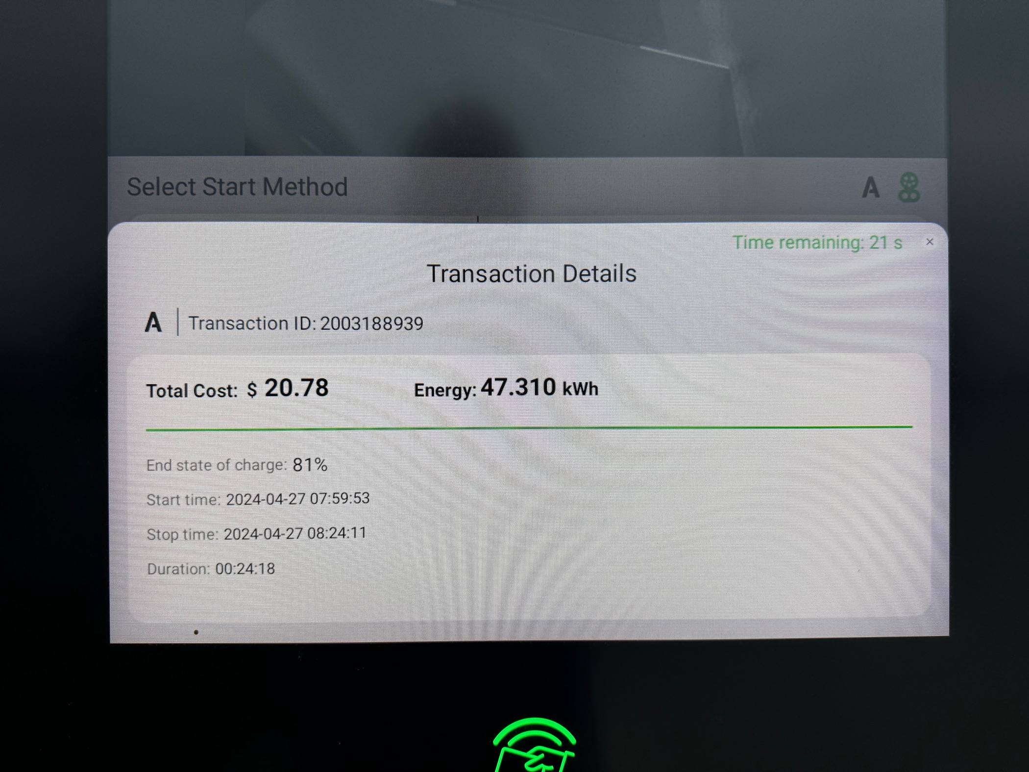

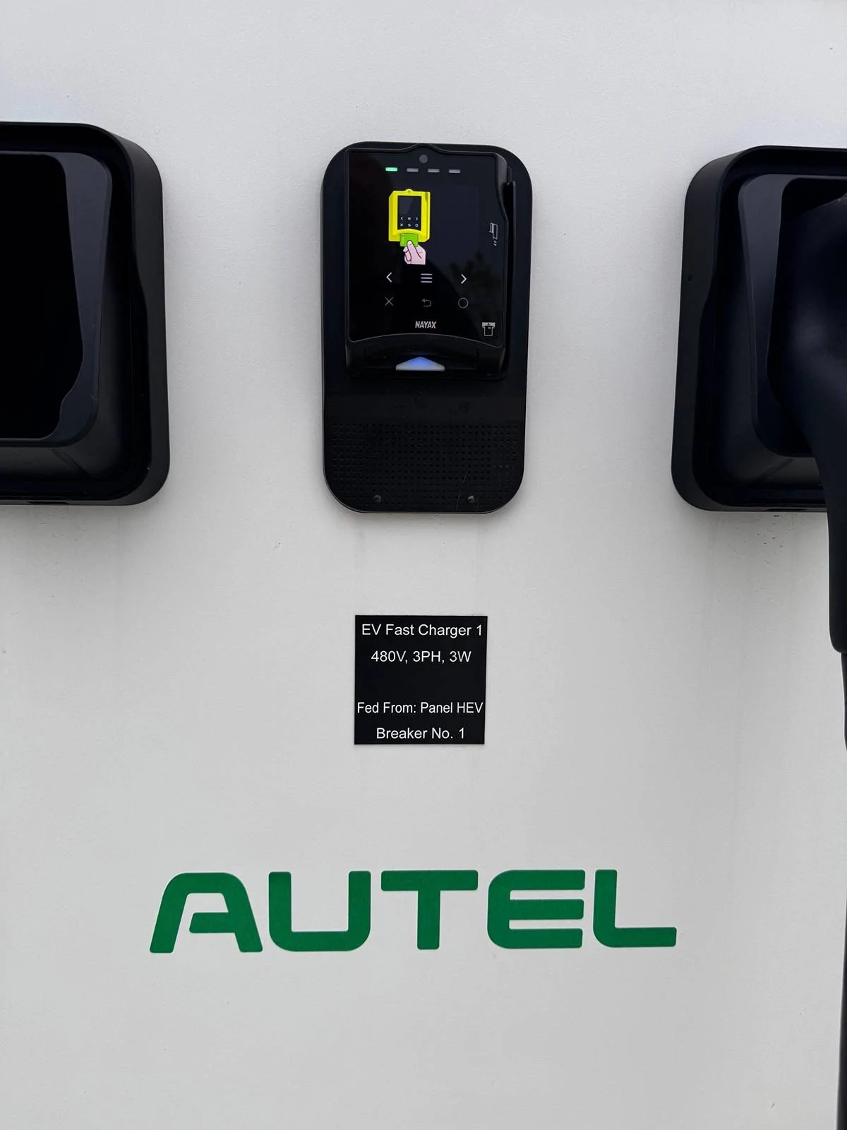

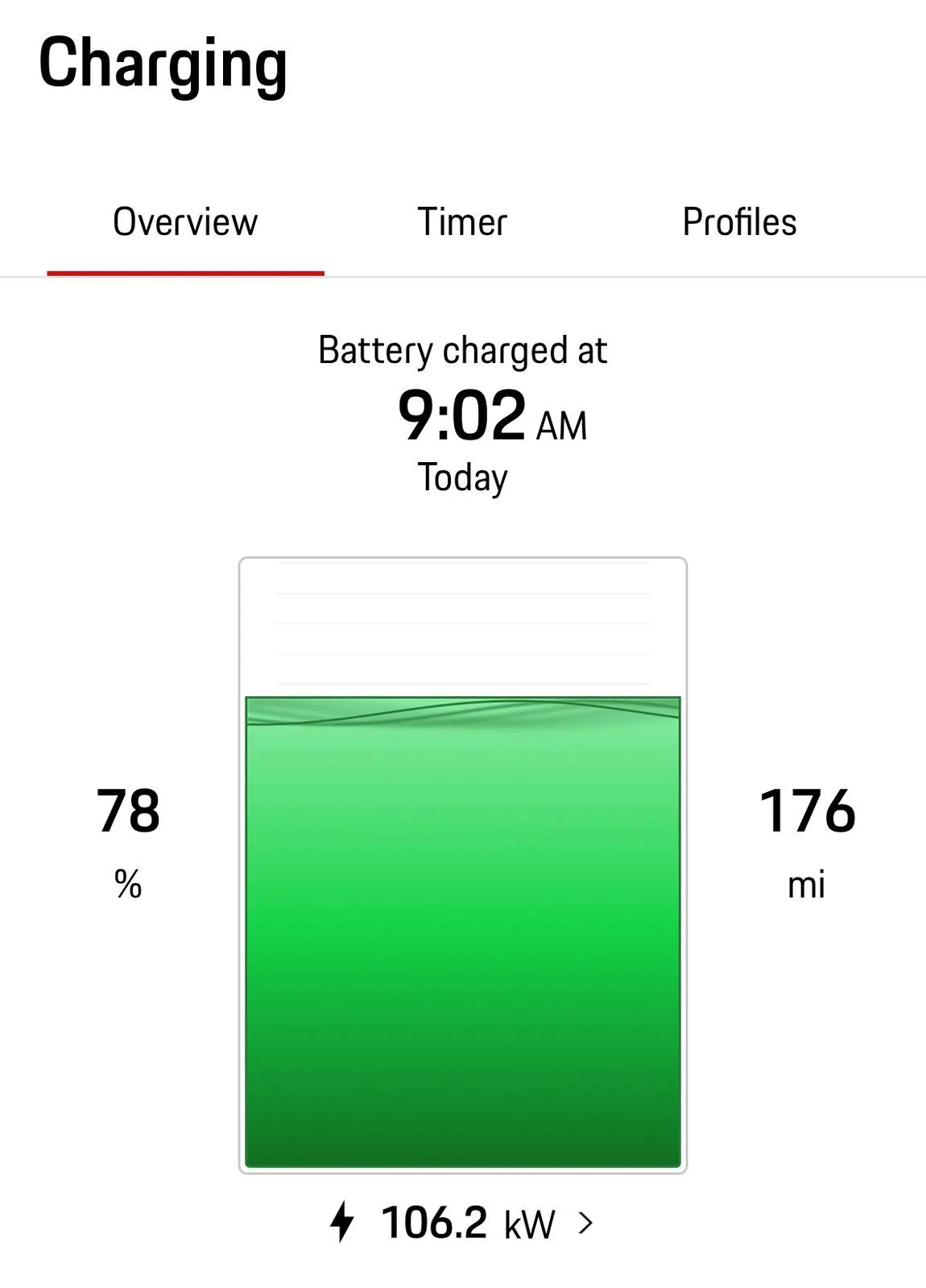

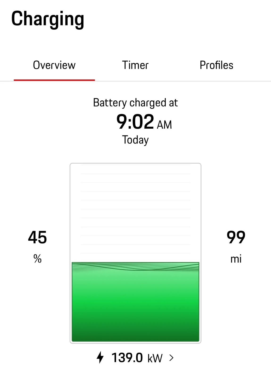

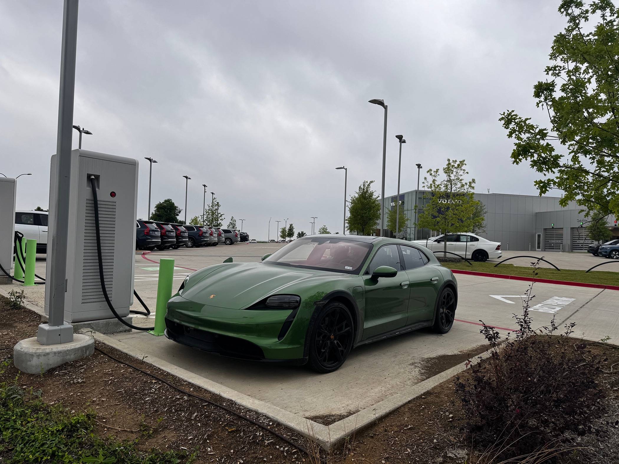

I was on a trip this weekend and needed to charge near my hotel (Tesla Destination chargers did not work with my TeslaTap, I assume they were locked to Tesla only). The closest DCFCs were some Autel 480V chargers outside of a Volvo dealership near DFW airport. I drove to these chargers on Saturday morning without any battery preconditioning (SoC was ~25%, battery temp around 80ºF IIRC) and immediately got a charge rate of ~140kW. The charging session lasted about 24 minutes and went from 25%-80%. Not bad at all considering how long it would have taken me if it were capped at 50kW without the 150kW option. I liked these Autel charging stations, they looked nice and worked great. Total cost was $20.78.
One interesting thing I noticed between these Autel and the EA chargers I normally used... The charging rate at ~80% SoC was above 100kW with the Autels and was about 60-70kW at the EA station I used later that day. The EA station was delivering 195kW earlier in that same charging session so I'm wondering if there is some kind of benefit to the charging curve (at higher SoC) with these 400V charging stations as compared to the 800V stations.

In 2022 everybody said the 400V option was a paperweight. I just happened to have it. The car limits the charge rate based on the battery temperature, and SOC, and charger maximum. There really shouldn’t be a difference. Was the battery temperature the same? Perhaps the EA station was “shared” power and there were other cars?

Battery temperature was higher at EA since the car was able to precondition the battery.
