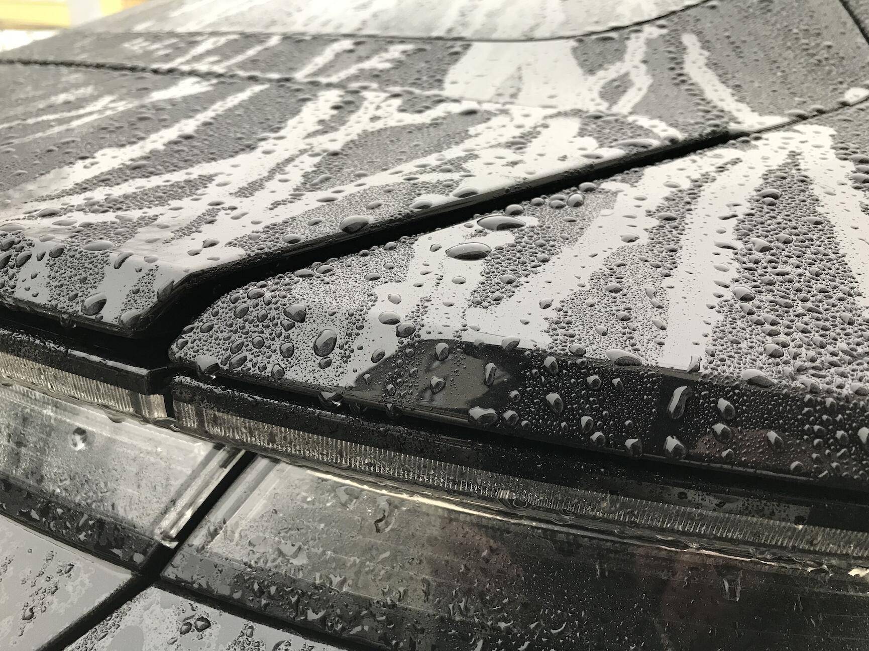

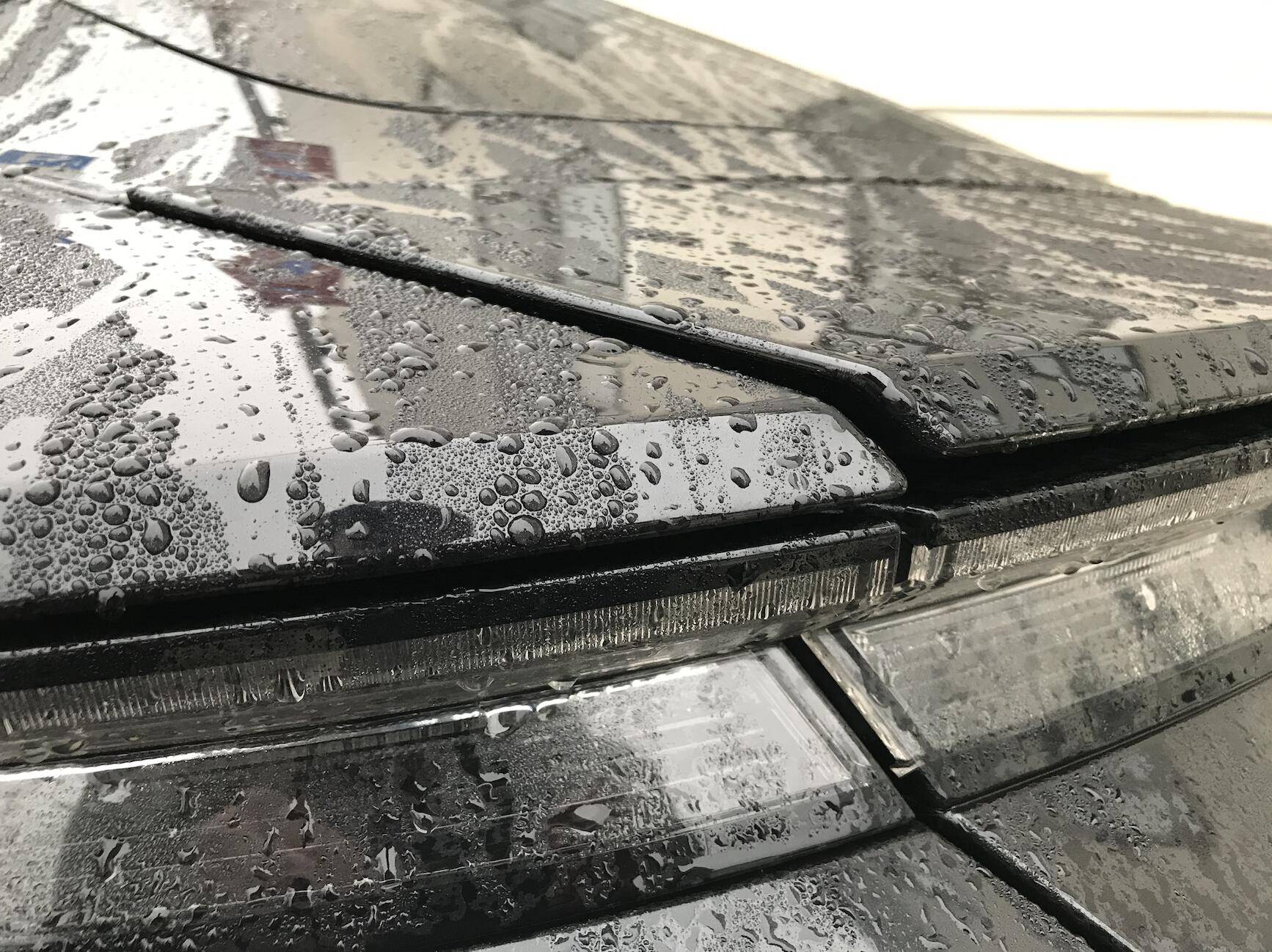

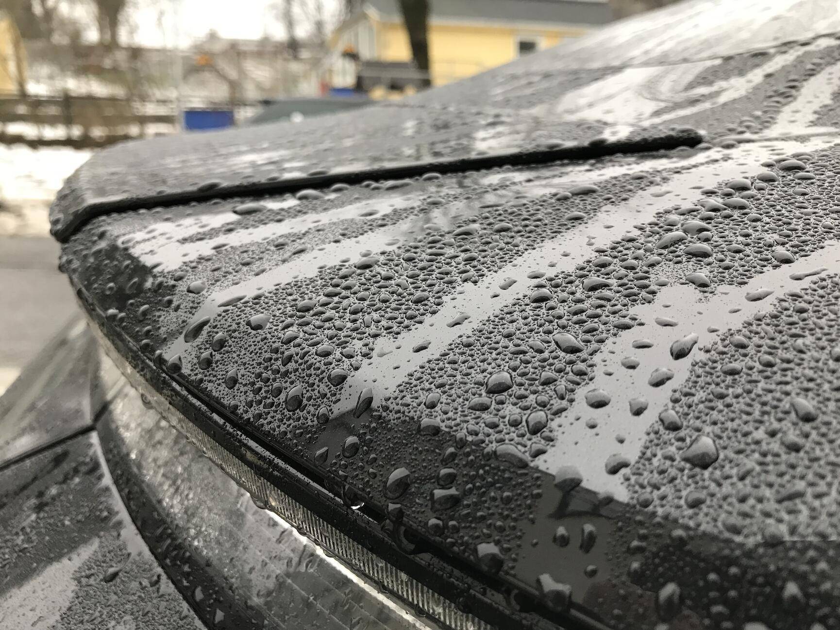

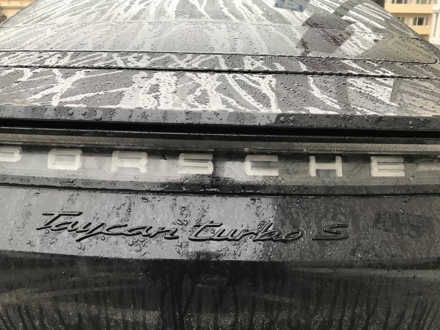

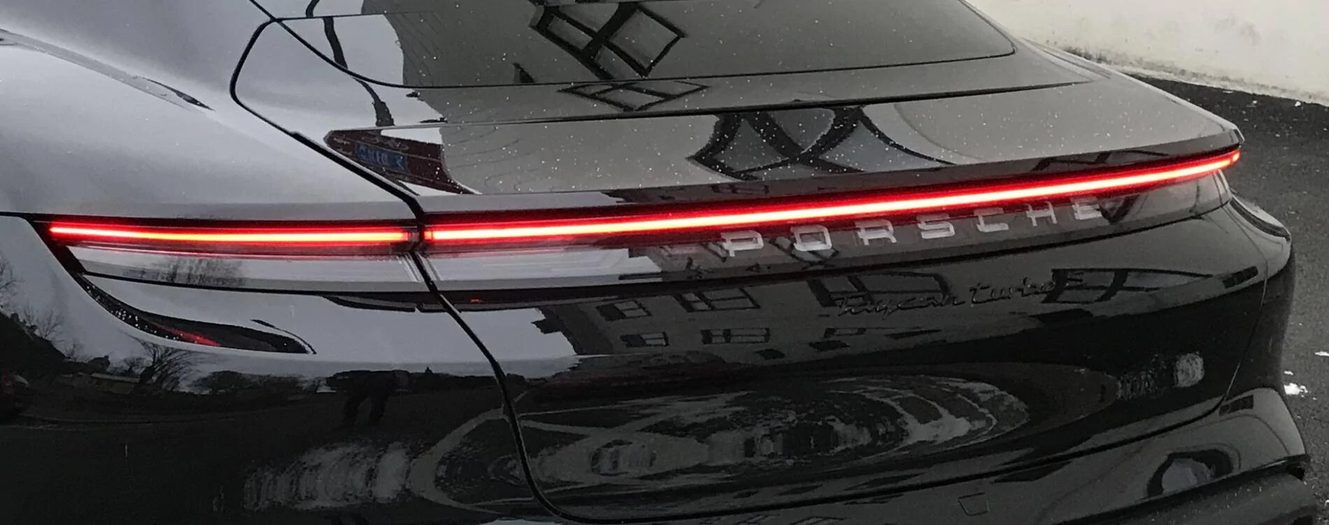

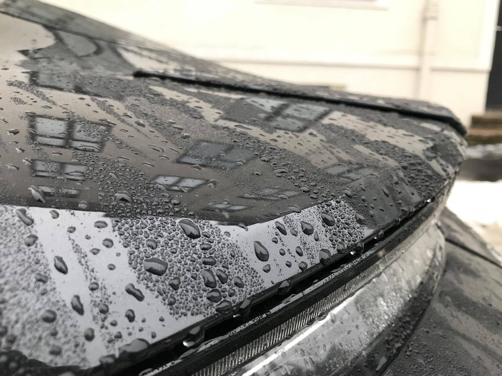

Unfortunately my TS got this spoiler fault also. Not a big issue really, and not much of disalignement, but still visible when knowing your Porsche like we sure do. Some Taycan owners have more gaps, and other have less - mine is somewhat in between.
Below are som photos showing this, as of yet, unsolved problem. The spoiler goes up on both sides, and down in the midle. I don't think anyone else than us owners will notice, as it is not visible until you look more closely ?
It happens over time, and does not go back into position. A Porsche in this price class should be 100%, so I'm confident it will be taken care of. I have been informed that Porsche Germany are working on a fix for all the vehicles affected, and I am sure it will be fixed somewhat soon ???
