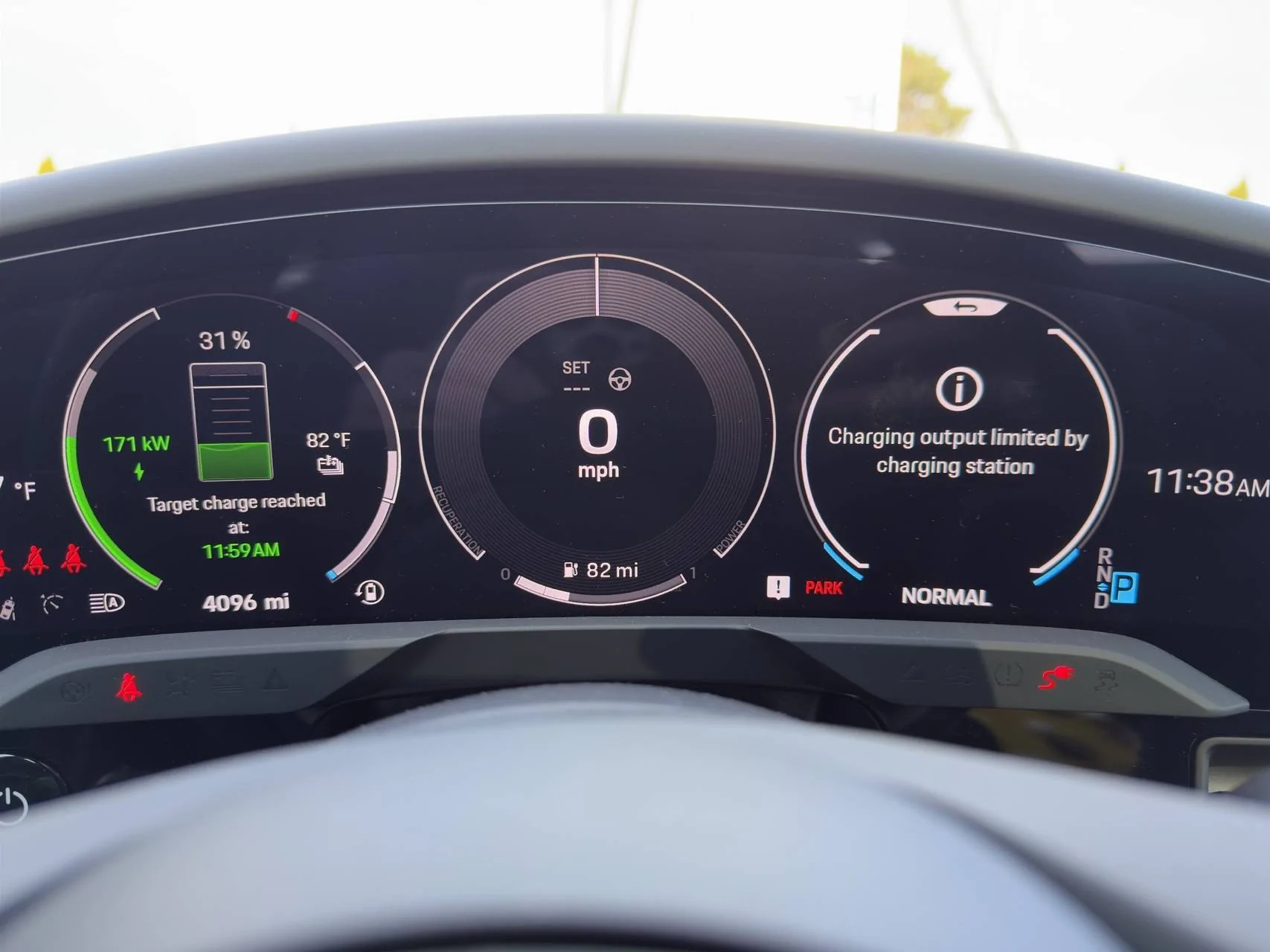

Our household’s best EA speeds have been on 150kW labeled units, into the 180s.
Merrimack seems to have a good track record. Although just not along any routes I drive.
Manchester NH though keeps suffering from broken chargers and long lines. Maybe one of these days I’ll brave it just for the experience if I’m taking our daughter to the mall when visiting grandma and grandpa nearby.
I had a reasonably good experience in Quebec at EC, hitting the 140s.
Obviously we define "good experience" very differently. If the car gets everything what it wants, IMO it's a good experience. If the car indicates something like this, then it's not, even when it gets 170kw.

@corgidad is showing how cool the left tube battery screen is now on the refresh, but I did not realize it also comes with a point the finger and blame the charger message on the right tube. Do not have that in the J1 I, so very jealous.
Yeah I really like that the car tells me how fast I can possibly charge at any given time and the difference between how much the car wants vs gets. Really helpful to optimize my charging stops (also whether to precondition the battery or not). The finger pointing is just hilarious 😆
If Porsche used the Tesla approach, we'd all have it by now, and J1.2 owners would have had a more thoroughly tested (on J1 customers) software.
