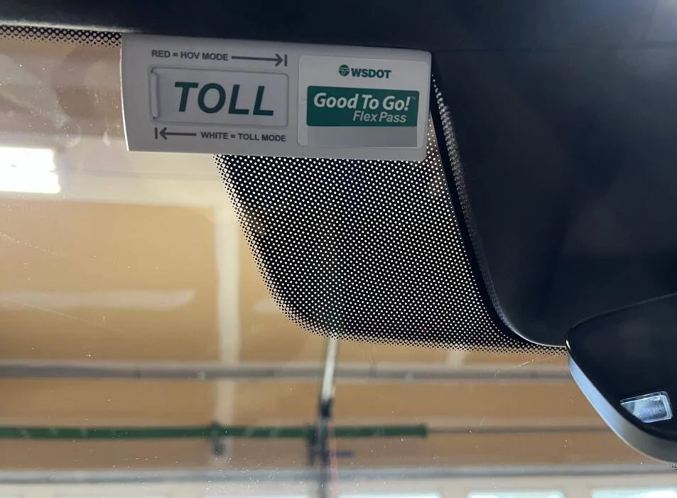

In case you are wondering where to place your GoodToGo Flex Pass in a Taycan with noise and thermal insulated glass, the answer is in the dotted area at the top of the windshield next to the mirror.

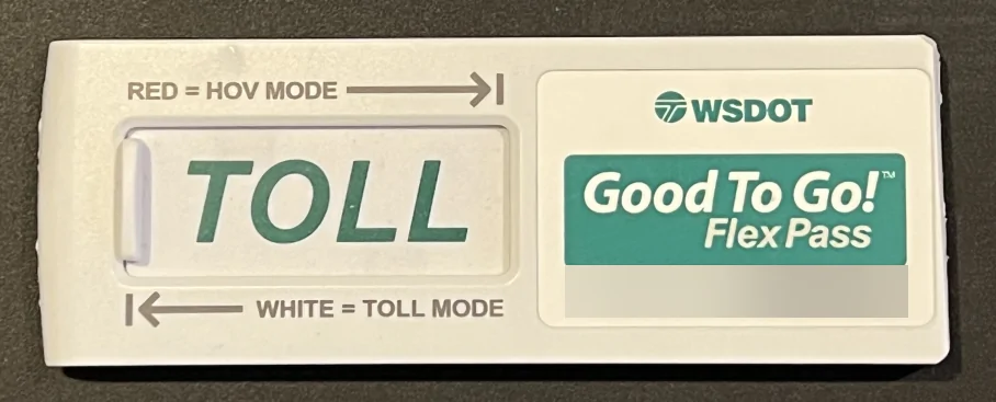

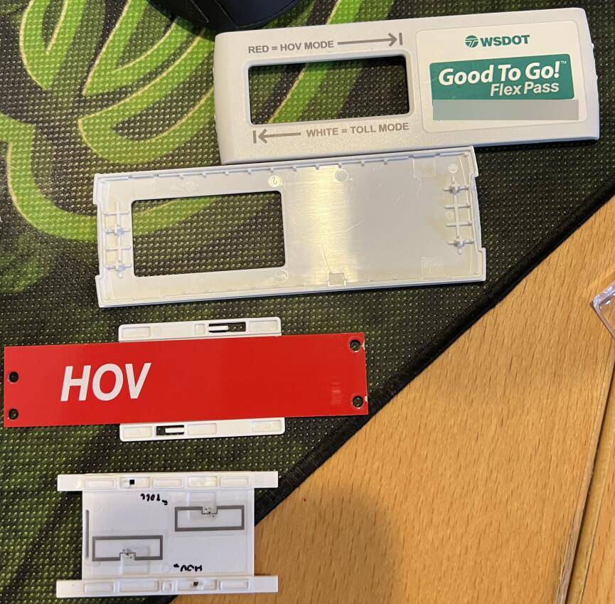

That area is a little small (my wife's Audi Q8 eTron has the same area but large enough to fit the whole pass with a holder), so to fit it, I ended up doing some simple reverse engineering on the tag, determined that the RFID antennas are near the centerline when exposed, either to the left of center in toll mode, or to the right of center in HOV mode (only one of the antennas is exposed at a time, the red circuit board has a copper plane which blocks the other one depending on the position of the slider which contains the antennas).
Porsche Taycan WA GoodToGo Flex pass placement 1693444051609

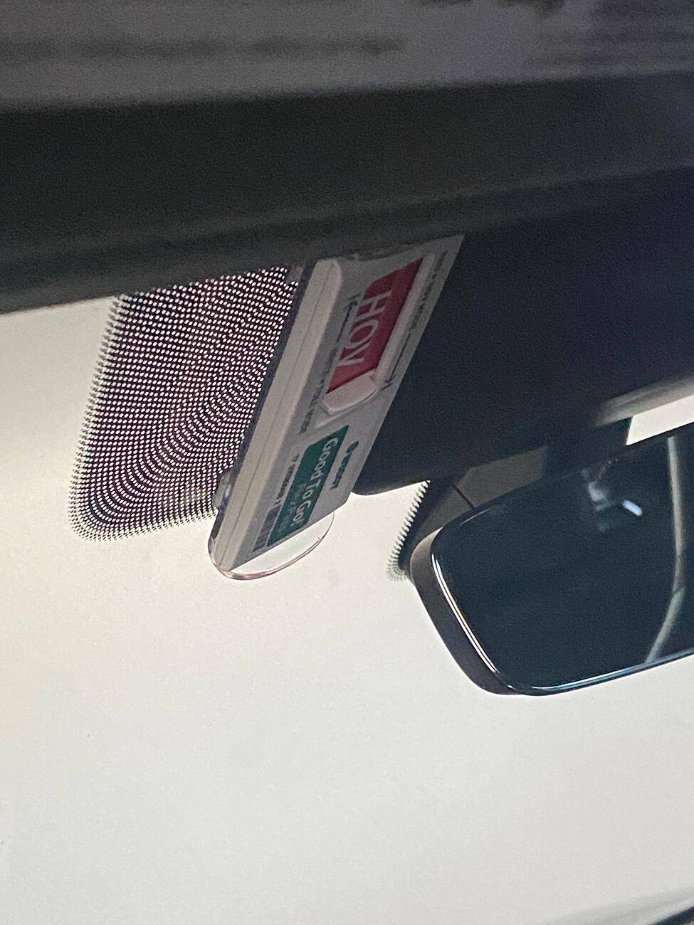

I then ground off a quarter inch of the right side to make it even shorter on the right (shift it towards the right into the dotted area) - in retrospect I could have just ground off the top right corner.
Porsche Taycan WA GoodToGo Flex pass placement 1693444175764
and mounted it tight up on the windshield without the holder (which would have pushed it to the left)
Porsche Taycan WA GoodToGo Flex pass placement 1693444933138
It's been working on my car for months now without any issues, so I thought I'd share it as a verified, working solution.
I hope this helps someone. Note that it might work without making it shorter, or even the whole thing with the holder if you want to install it diagonally, I just wanted the RFID to be well within the dotted area, and for it to be as unobtrusive as possible, but still easily accessible and visible to the driver.

This is exactly what I was looking to learn about. One question, could you just mount the pass vertically so it fits in the dotted area without having to modify the pass frame? Thanks
73
6,372
5,628
You should be able to mount it vertically, or diagonally. As long as the antennas are in the dotted area, they should work. Remember to test in both positions, TOLL and HOV as the corresponding antennas are in different places.
gremlin
May 13, 2024
Washington State
2022 Taycan 4s, 2023 GT4, 2013 Boxster S, 1971 911
I've got ours mounted diagonally to the right of the mirror and it's not being picked up, unfortunately they closed the office in Bellevue that you could do tests at, so instead we're left waiting for the mailed bills when we figure out it doesn't work!
