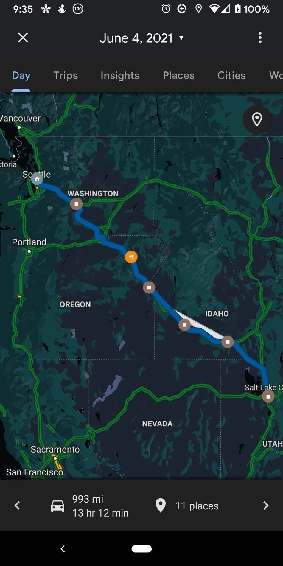

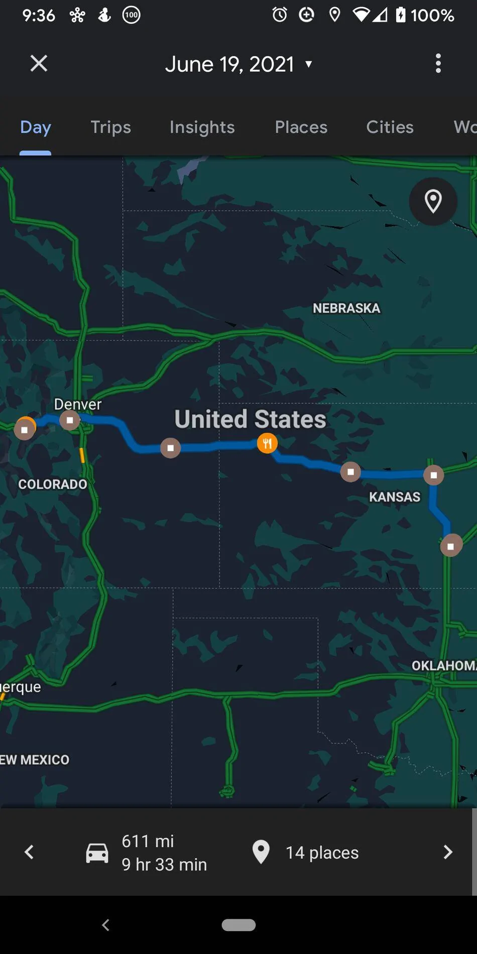

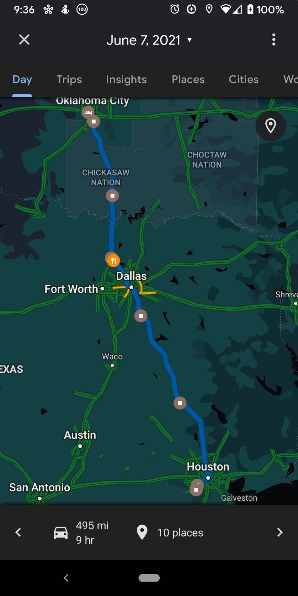

Prior to the trip we used A Better Route Planner (ABRP) to get an idea of the highways which we'll be on and to figure out what major cities we could stay at along the way. This helped setting an agenda for each day and so that we can figure out food options for lunch and dinner. The route which ABRP planned was relatively close to what PIRM suggested. The only difference was the route from Denver to Oklahoma City. PIRM wanted to take I70 where ABRP wanted to go I25 south and then East on I40. Now as for why ABRP is important, PIRM was not able to generate a route from Seattle > Houston which is not too surprising. To compensate for this, we would punch in the major cities we would be passing thru from ABRP so that PIRM could come up with a route. As soon as we were 1-2 stop away, we would then change the destination to the next major city so that PIRM would add the necessary charging station.
Our plan for the trip was to do about 10-12 hours of driving a day, stop every 2 hours or so which was about how all the EA stations were laid out, and then book the hotel the same day. The only issue which didn't quiet work out too well was finding a hotel for cheap when you have a dog travelling with you. You can't really use apps such as Hotwire since even though they'll book you at a pet friendly hotel, you're at the mercy of the hotel regarding pet fees. Some are great and some like to charge you up the wazoo. On the way back, we just simply used Bookings.com and booked rooms at La Quinta since they only charge $20 for pets.
There was plenty of great scenery along the way and I personally feel that everyone needs to do at least 1 road trip across the US in their life. The US is a very diverse place and I think sometimes we lose sight of that. Along the route, our favorite stop was at Green River, Ut. The 350kw charger was actually charging at full speed and located at a local coffee shop (Green River Coffee) where they roast their own coffee beans. Then 1 block down from them was one of the best taco trucks (Tacos La Pasadita) I've ever had. If you are ever there, get their al pastor and tripas (get it crispy) tacos. Not only did we stop there on the way down to Houston, we dropped by again on the way back where I loaded up on their tacos. The scenery in Utah and Colorado were magnificent. However we were a bit too early in the early year to be able to drive through endless miles of corn fields. Whether that's good or bad, that's a tough one to decide.

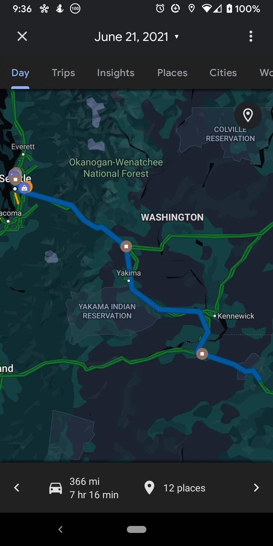

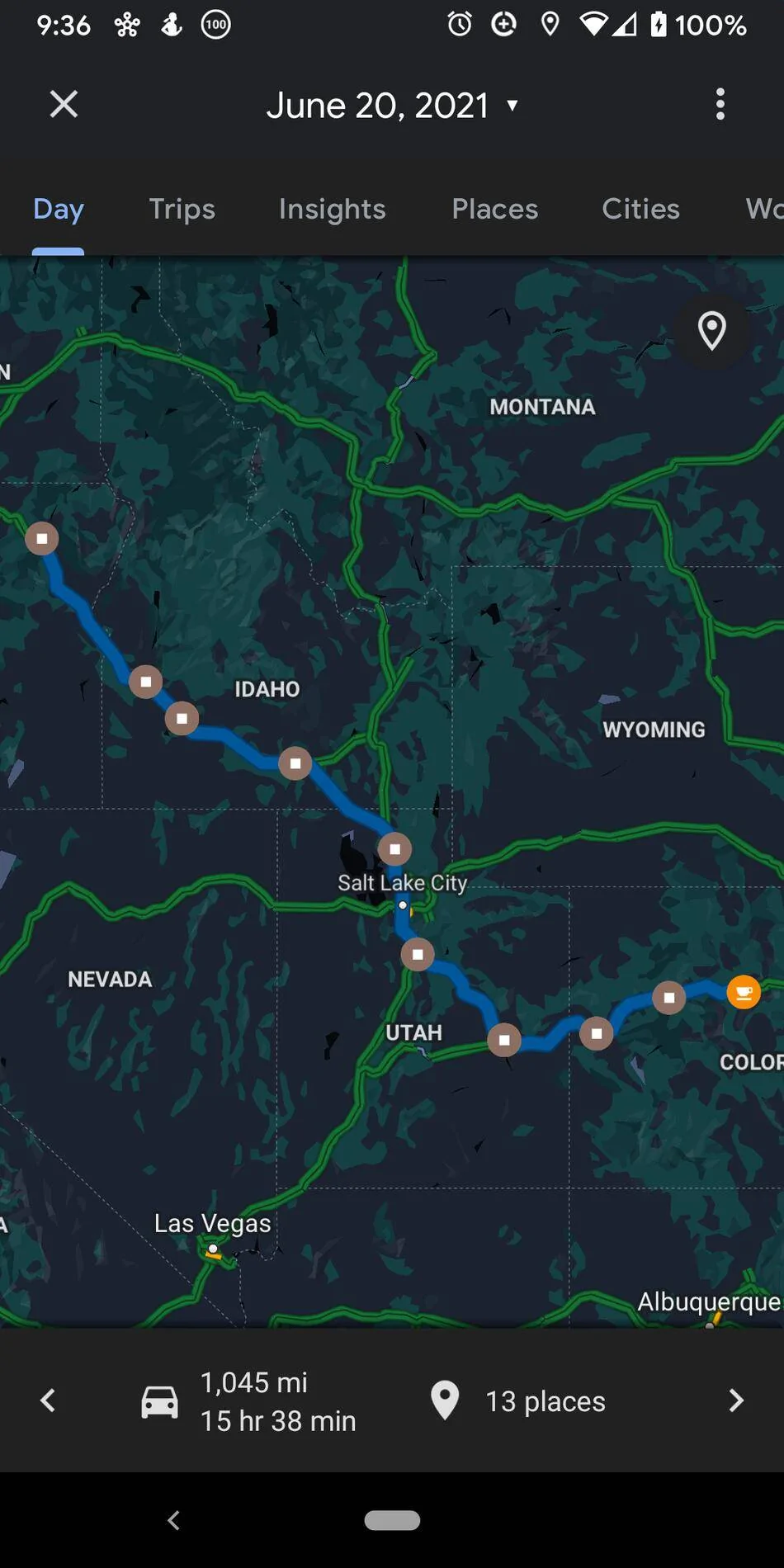

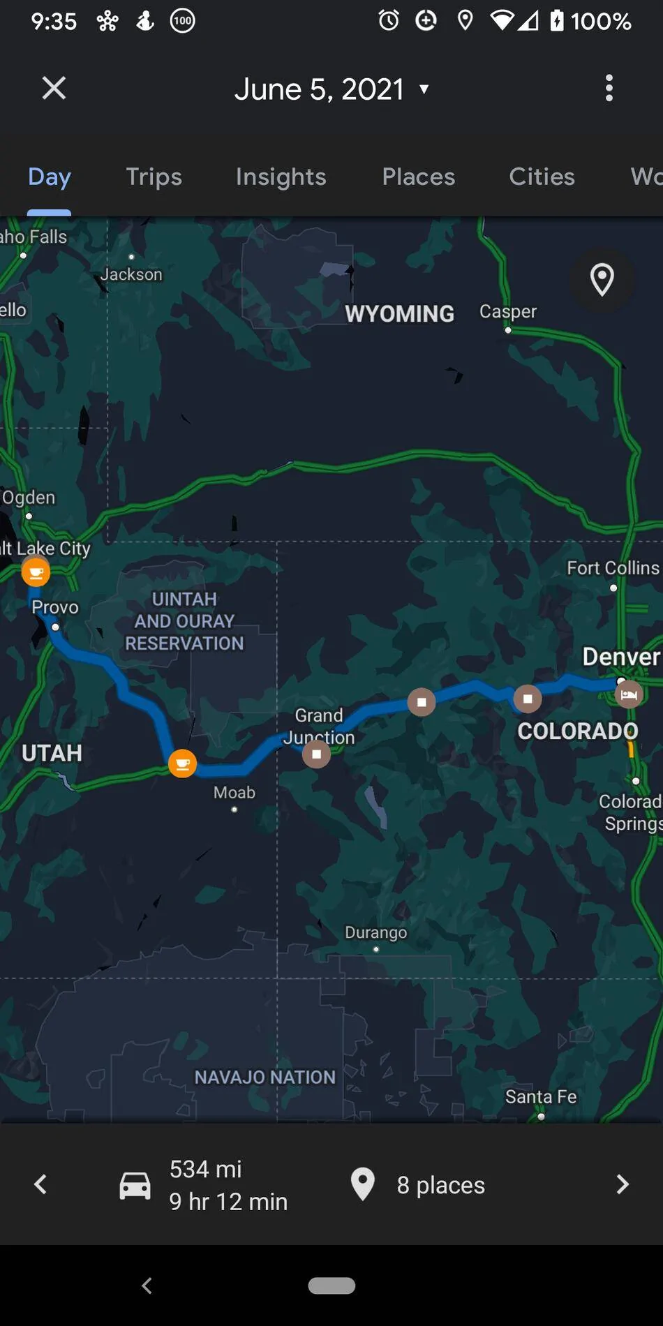

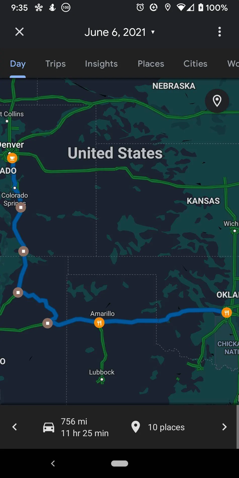

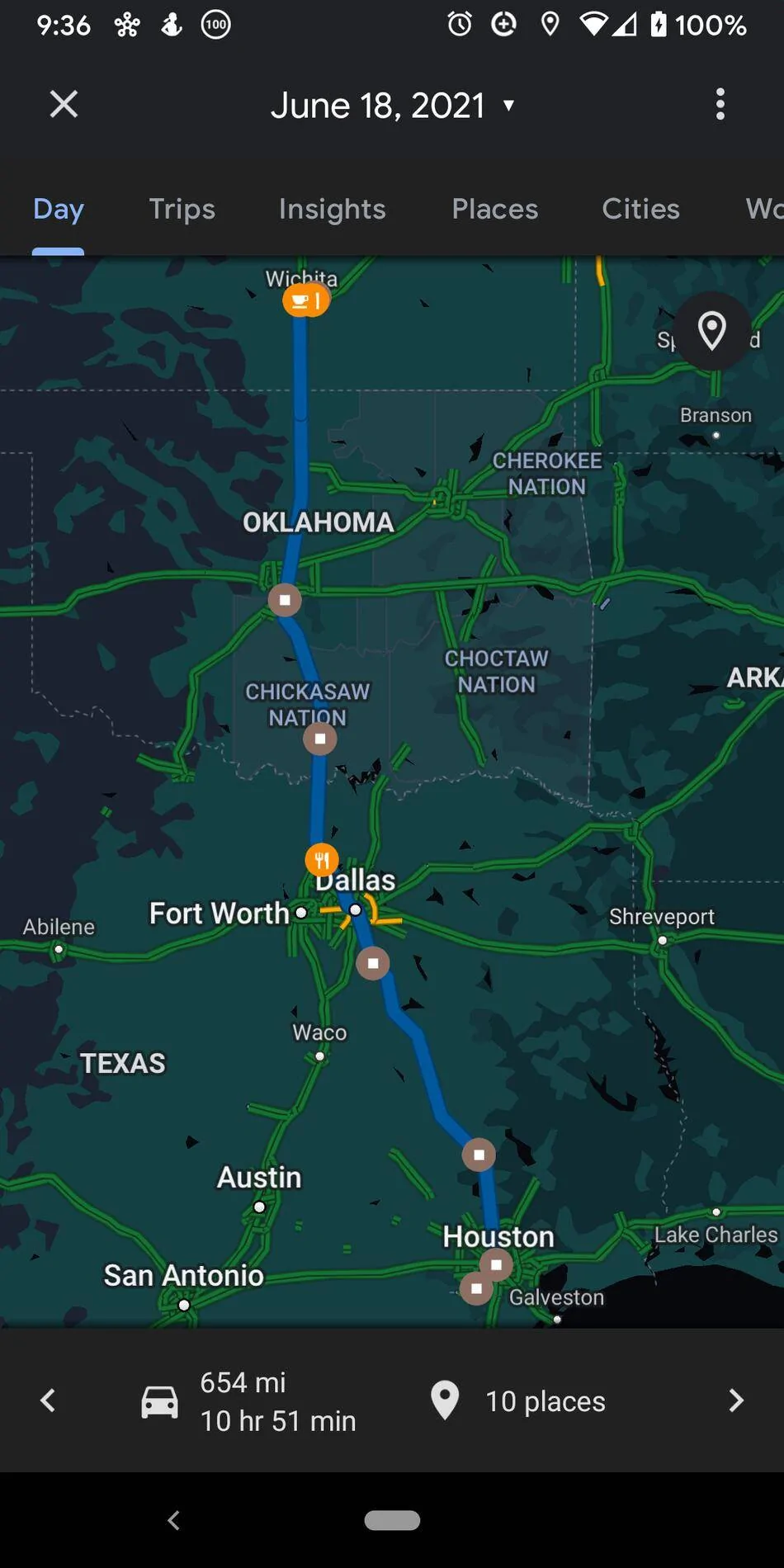

Seattle > Houston
Houston > Seattle

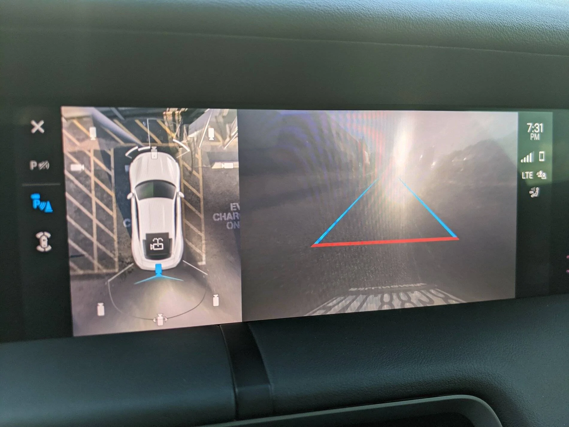

Two other issue happened as well which are currently being looking at too. 1) I started hearing a high pitch whine on medium to hard acceleration and regen. I believe this is related to the high voltage lines as it's happening on both acceleration and regen. 2) On the last two stop of our trip, DC fast charging also failed. We weren't able to activate the charger thru either the Porsche app nor the EA app. We were able to get the charger started by using a CC, but it was be at a decreased 66kW charging rate. Had issue reaching Porsche, but once we were able to reach EA customer service, they were able to somehow get the chargers activated and charging at full speed. Anna from EA was wonderful and even informed her team to expect a call from us in about 2 hours as we still had 1 more stop left. This happened on 6/20 and at 3 locations on all 12 stations. When this happens after you've been driving for 18-19 hours and it's 1am, you get pretty dejected. No idea if this is an issue w/ the Taycan or with EA. (7/7 - Dealer noted that they found code pertaining to charger station issue. Same issue was reported in another thread around the same time where I was having issues.) After we got back home at around 7am, we got a few hours of sleep and decided to try another charger again and drop the car off at the dealership. This time the car was able to start the DC fast charge but only for 1 minute before stopped unexpectedly. The dealer is checking up on this as well, and we haven't heard anything back yet. I hope Porsche can figure out what the issue is. In the mean time, I'm in a Macan. No where nears as fast as the Taycan, but I do love how fast and responsive the infotainment is. Makes me wonder what the hell happened to the infotainment in the Taycan. We also had an instance where all the cameras went out, no idea on the exact cause, but eventually restarting the car fixed it.

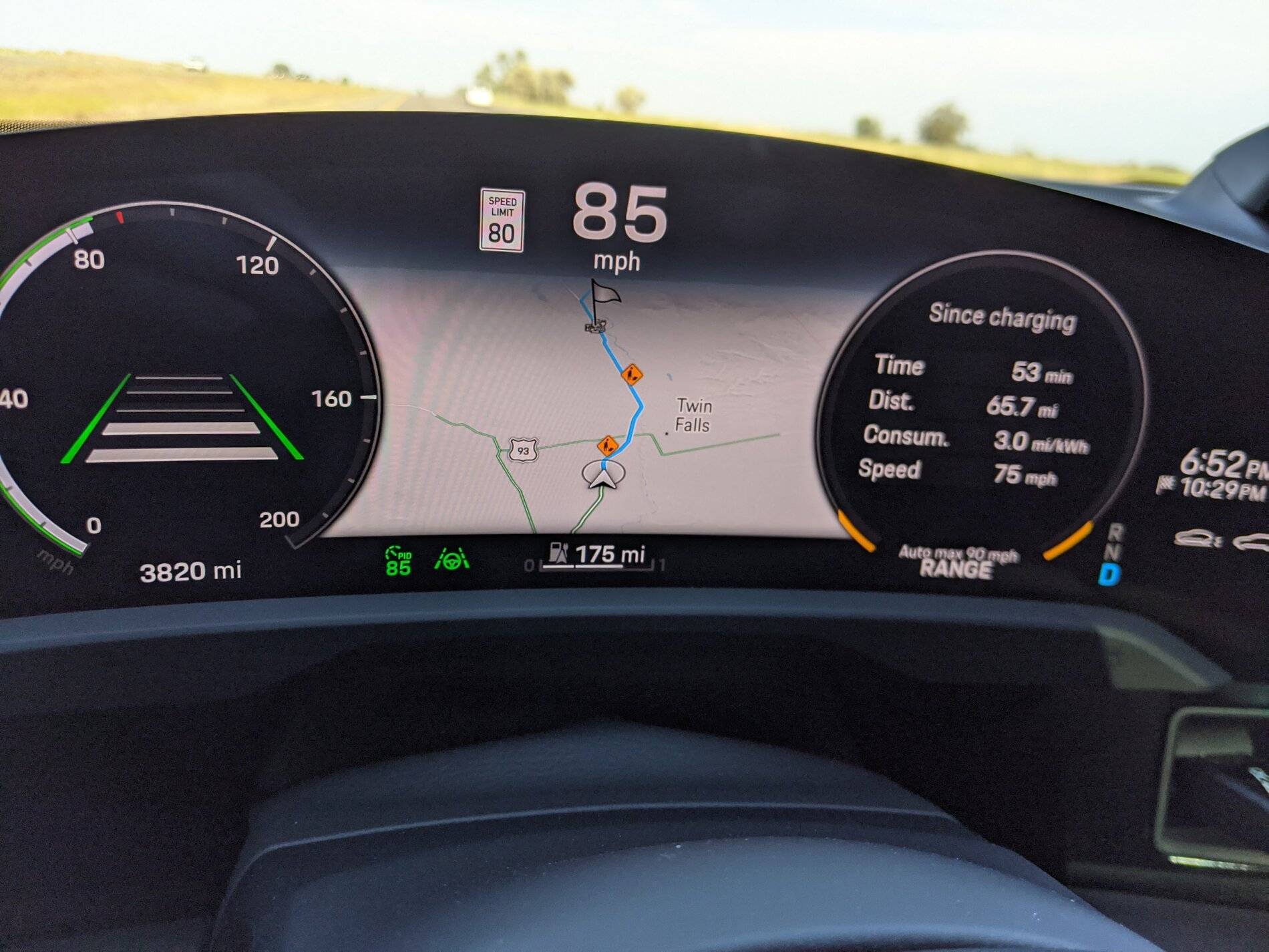

- Taycan will get 3.0-3.5 mi/kWh going 75. 2.4-2.5 when you're traveling at 85. If you get a tailwind, it is possible to do 3.0 mi/kWh going 85. (See photo below)
- Different charging curves for 350kw vs 150kw charger. So even if you're past the SOC to get 270kW, it can still be worthwhile to use the 350kW.
- Taycan is too aggressive when it tries to bring the car back down to the max speed limit whether it's set because of range mode or because of speed limit signs. Be very careful on this or you may accidentally brake check someone.
