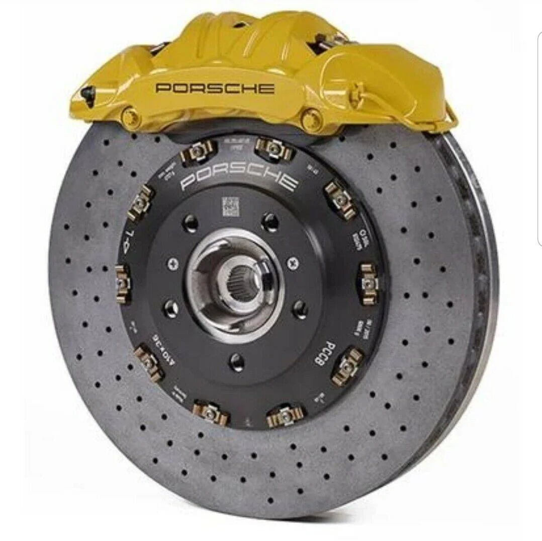

So I’m trying to finalize the spec of my 4S CT, and I’m set on a 4S instead of a turbo, but I’m having trouble with the brakes.
In most literature and posts where PCCBs are mentioned as saving weight they are being compared against the massive steel PSCBs which are undoubtedly super heavy.
The benefits of reducing unsprung and unsprung rotating mass are many, and I won’t relitigate them here, but for those of us who may want to optimize the spec of a 4S the choice is not obvious as to which will be lighter and more responsive. I’m thinking that the PCCBs are much bigger diameter, so they may actually come out as a negative for rotational inertia versus the 4S brakes (goes with radius squared).
Has anyone been able to source weights for each setup, especially broken out into disc and caliper weights?

I had the opportunity to attend a Porsche tech session in Atlanta when I first got my 991.1 GT3. The GT3 had 380mm cast iron rotors as standard and 410mm PCCB's as an option and we got to handle them both. The weight difference was almost 11 pounds per wheel for the front rotors per the Porsche engineer.
The Taycan has 360mm front rotors as standard and the optional PCCB's are 420mm. The optional PSCB's are 410mm. There is clearly going to be less than 11 pounds difference between the 360mm cast iron and the 420mm PCCB's and you also have to factor in the weight of the larger 10 piston calipers on the PCCB's. I suspect the PCCB's still have a slight advantage but call it close to a wash weight-wise. The problem, IMO, is that the standard brakes aren't available with 21" wheels and, most importantly, they dust so they weren't an option for me.
The PSCB's can be had with the larger wheels and they apparently dust very little but they are almost as big as the PCCB's so the difference in rotational factors you mention has got to be pretty negligible. OTOH, my guess is that weight wise the cast iron PSCB's are easily 15lbs heavier than the carbon ceramic rotors at the front. That's a lot from an un-sprung mass perspective.
I'm not going to argue whether a given driver can feel the difference or how much of a performance advantage there is but FWIW, I think the numbers above are realistic. Only you can decide whether it's worth the extra money for PCCB's. I had them on my GT3 and I ordered them for my Taycan 4S.

The PCCB is approx 5kg/ disc, saves ~4 x 5 kgs compared to the PSCB
However, as of model year 2021, the calipers are heavier than the now 6 piston ones of the PSCB
Frankly, the PCCB doesn't make sense on an EV as recup kicks in anyways and the PSCB is massive.
Avoiding dust is prob the biggest advantage of the PSCBs

the ONLY reasons to consider PCCB's for the Taycan are:
1. you're tracking it (not a good idea) it's fun but it is too big and too heavy and tracks lack fast charging to keep you running all day
2. dust management
dust management is what tips it over the top for me
although with regen carrying 90% of the load that's 90% less dust also…PCCB's are probably a big huge waste on an EV given very very low friction brake usage…
years ago I came to admire "monster cables" ability to "sell" stuff to people - I believe they hit their peak in terms of extracting money out of people with their "gold plated optical" audio cables (think about it)…pure money extraction with no shame.
that's how I feel about PCCB"s on an EV that has 90% of it's braking handled by regen…go Porsche!!!

Exactly. You could have the best brakes in the world but the reality of the situation is that the Taycan barely uses them. I have standard brakes and my wheels have never shown a massive amount of brake dust. I’ve done 5000 miles since December and it’s never been an issue.
also, in regards to weight, the car wash over 2.1 tonnes. Saving an extra few kg (in my opinion) isn’t worth a few extra thousand in cash.

or to put it more succinctly:
PCCB's on a Taycan are like Gold Plated Optical audio cables.
and sold/an-option for the same reason people make gold plated optical cables.
hint below for those less engineering inclined…
if you're transmitting data via optical mechanisms - the gold is purely decorative and PLAYS no role in improving signal quality of the cable. gold improves things when you are using electrical transmission methods - it plays zero role in an optical system since the light is transmitted by fibre optics immune to any conductivity improvement offered by "gold"
and just so we're all clear how big thick and bold the word "sucker" is tattooed on my personal forehead - my 2020 Taycan has PCCBs - would I do it again for an EV? No! For an ICE vehicle? Yes!
hmmmm -now that I look - yellow is very close to a "gold" color - and the yellow calipers are a lot like the gold plating on the optical cables - yeah I pronounce the metaphor complete!!

Well, this sucker is going to get great pleasure every time I look at my Taycan and see those big, beautiful, cross drilled PCCB brakes and yellow calipers behind Mission E wheels. Better eye candy than all the optional trims and treatments in the world and no regrets for the money spent.
And I might really use the hell out of the friction brakes on occasion; just because I can. ;)
