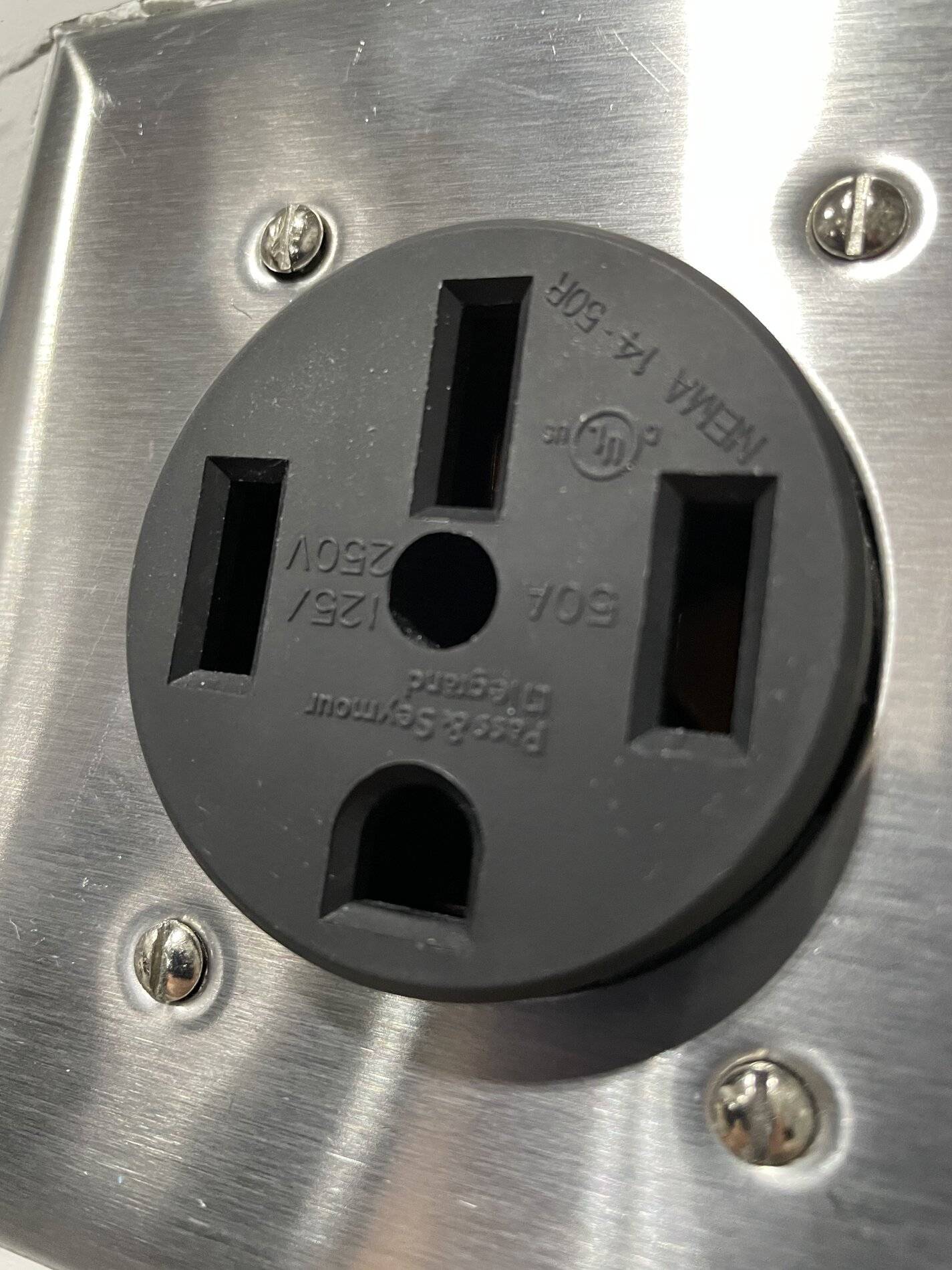

While waiting for my Taycan delivery, I recently had a 50 amp circuit installed in my garage by a licensed electrician. Got the permit and the county inspector approved the install yesterday. The electrician installed a NEMA 14-50 outlet upside down as I asked and as needed for the Taycan. So I've since noticed by reading here in the Forum, that not all NEMA outlets are created equal and I'm wondering if the one he installed is robust enough or if I need to install something better built so that I don't burn down my home...
He installed a Legrand Pass & Seymour 14-50 outlet that does not quite match what P&S shows on their website or on their datasheet. Lettering is in different places which makes me wonder if what was installed is counterfeit.
So I'm wondering:
1) Does anyone have this same brand outlet, and if so,
2) Have you had any issues with it?
3) What brand are you using that is holding up well?
4) And other than Leviton, what other brands should I stay away from?
Thanks.

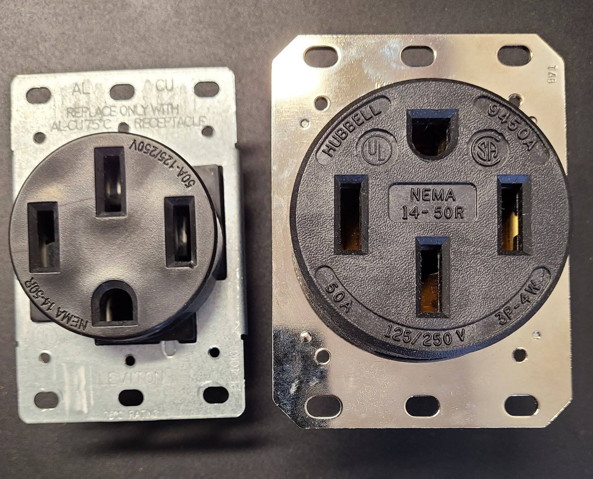

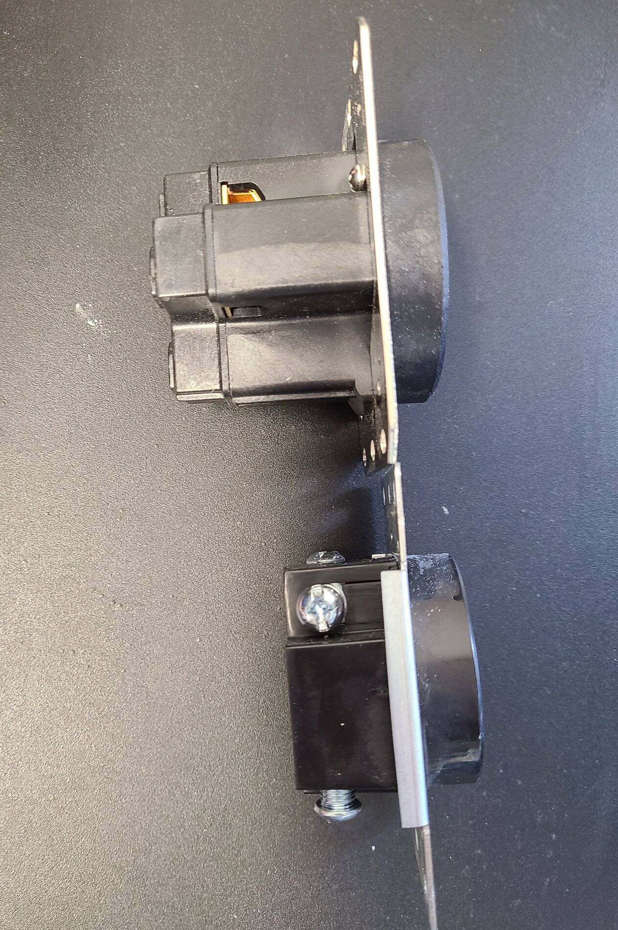

Photo of Hubbell ($100) vs Leviton ($10). The difference is very noticeable.
If you use Hubbell, make sure
- you buy the faceplate with the larger opening lime this
- you use a deep electrical box because the Hubbell is much longer
- thickest wire it accepts is #6 (Leviton accepts also #4)
Overall very happy with Hubbell's quality but there is one thing that Leviton was better. While installing it, Leviton's tightening screws face the installer so it is easy to tighten up, while Hubbell's screews face the wall so you might not have enough space to work the tool if you don't have much extra wire.
