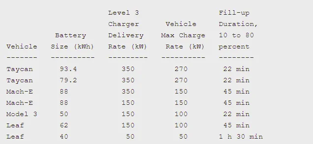

I would add a little more to the fast DC charging section. If you read that WSJ article, you can see how people who just dont know about charging can get confused. All fast charging is not equal, as apps like PlugShare will show fast charging stations that give 25kw all the way up to the 350kw rates. So some people new to EVs might think it’s all the same and route to a 25kw station and think they’ll top off in 30 minutes or so, when that could take hours. A good reference that seems to work for me when I explain it to people is to think about Internet speeds. Most people are familiar enough with that reference. I explain that 25mbps is the government definition of high speed Internet, but then you have Google Fiber running at 1GB or 2GB and compare them download speeds and Internet surfing quality with those two very different speeds. That seems to get folks attention and understanding of how very different fast charging can be.
You also might want to note that many things can interefere with your vehicle reaching it’s top supposed charging rate, including weather, battery temperature and what charge is remaining on the battery when they start. To get the top speeds, most EVs like their batteries under 20% state of charge when they start charging and the battery temperature pretty high to get them high scores when charging. Temperature outside can affect it as well. Some EVs can pre-condition the battery too. Also to note that sometimes it’s just an error in the connection to the charging station. You might plug in and get a terribly slow 30kw connection on a 350kw station. Stopping the charging and reconnecting can often clear that up. Maybe tell people that if they get a connection speed less than half what it should be, try re-initiating the charging session.
Hope this helps! You have a really good article going here!
Lots of good points in here. I updated a few sections of the article based on your feedback. I also tried to keep it simple. Thanks for the feedback.
