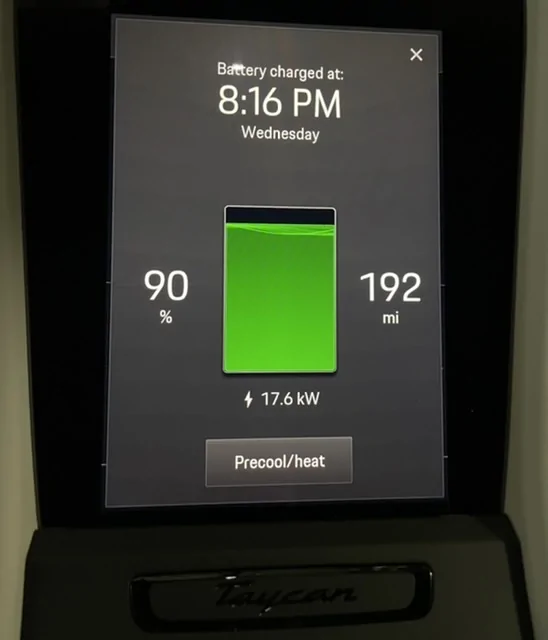

I took delivery of the car last week. I promptly drove it to the detailer for PPF, etc., so I haven’t even charged it overnight yet. I did initiate a charge for a few minutes to just to confirm the 19.2kW charger was functional.
Porsche didn’t commit to fixing it, but they have backed off their original position of “it can’t be fixed”. Unofficially, the sales manager at my dealership was told by PCNA that they hope to fix it in software. Not a plan, but hope. I interpret this to mean they’re exploring options with suppliers and don’t yet know if they can fix it or create a workaround.
Porsche didn’t commit to fixing it, but they have backed off their original position of “it can’t be fixed”. Unofficially, the sales manager at my dealership was told by PCNA that they hope to fix it in software. Not a plan, but hope. I interpret this mean they’re exploring options with suppliers and don’t yet know if they can fix it or create a workaround.
