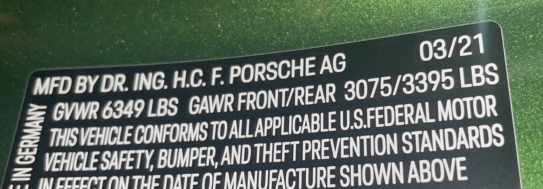

so quick follow up: where do I find the build date?
Not sure about others, but the sticker in the drivers door is not there, there is only the tire sticker in between the two doors (bottom-outside of b-pillar).
