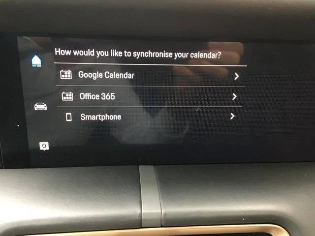

If I go into Calendar in PCM I am asked if I want to synchronise my calendar,
Google Calendar, Office 365 or Smartphone. I do not have the first two calendars, only Apple iCal. So I need to do it with my Smartphone.

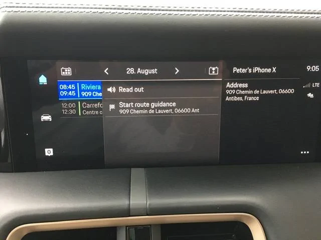

Once joined on the hotspot the calendar syncs fine and I can see entries per week and click on them to see the details
Porsche Taycan What is the PCM HotSpot for anyway? 569F153A-81CD-4695-8361-C98C29316E44
As you can see on the screen I can now transfer this to the navigation system and get the guidance.

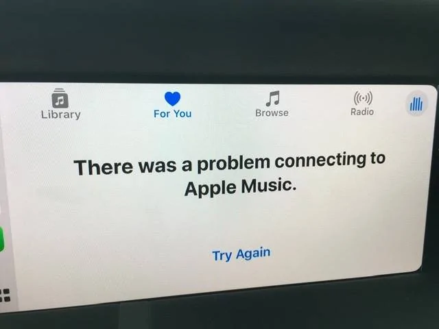

Bluetooth was OFF so the phone obviously does not work in the car. Switching Bluetooth back on phone works and is still connected via WiFi to the car.
I can also play my music via Bluetooth, but only music stored on the phone. I can not stream from any streaming service since I have no internet connection in my phone! Also if I want to use Waze or Google Maps for direction or Waze for warning about speed checks or other trouble along my route it will not work.
When I plug in the phone to use Apple CarPlay and perhaps play music it can not connect to the internet.

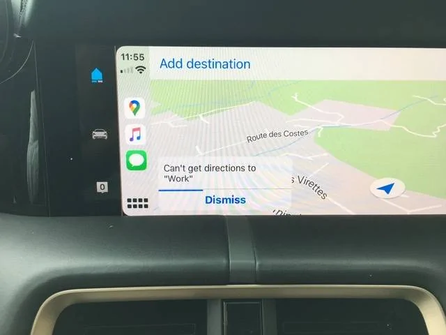

Switching the WiFi OFF then Apple ~CarPlay etc all works fine, but now Calendar is no longer working.
Once the car and phone are linked via WiFi all internet connections from the phone is dead.

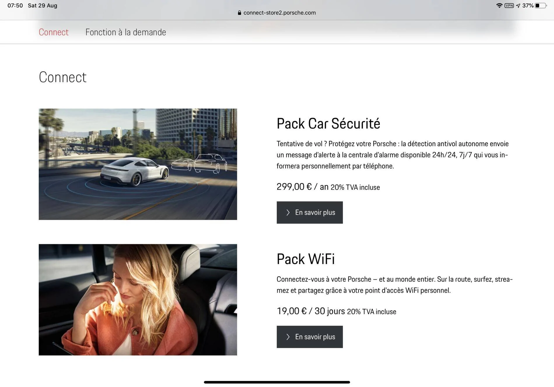

There is the option here to get the data package, which I have NOT subscribed to.
19 Euros for what exactly? Just data on the built-in LTE connection?
