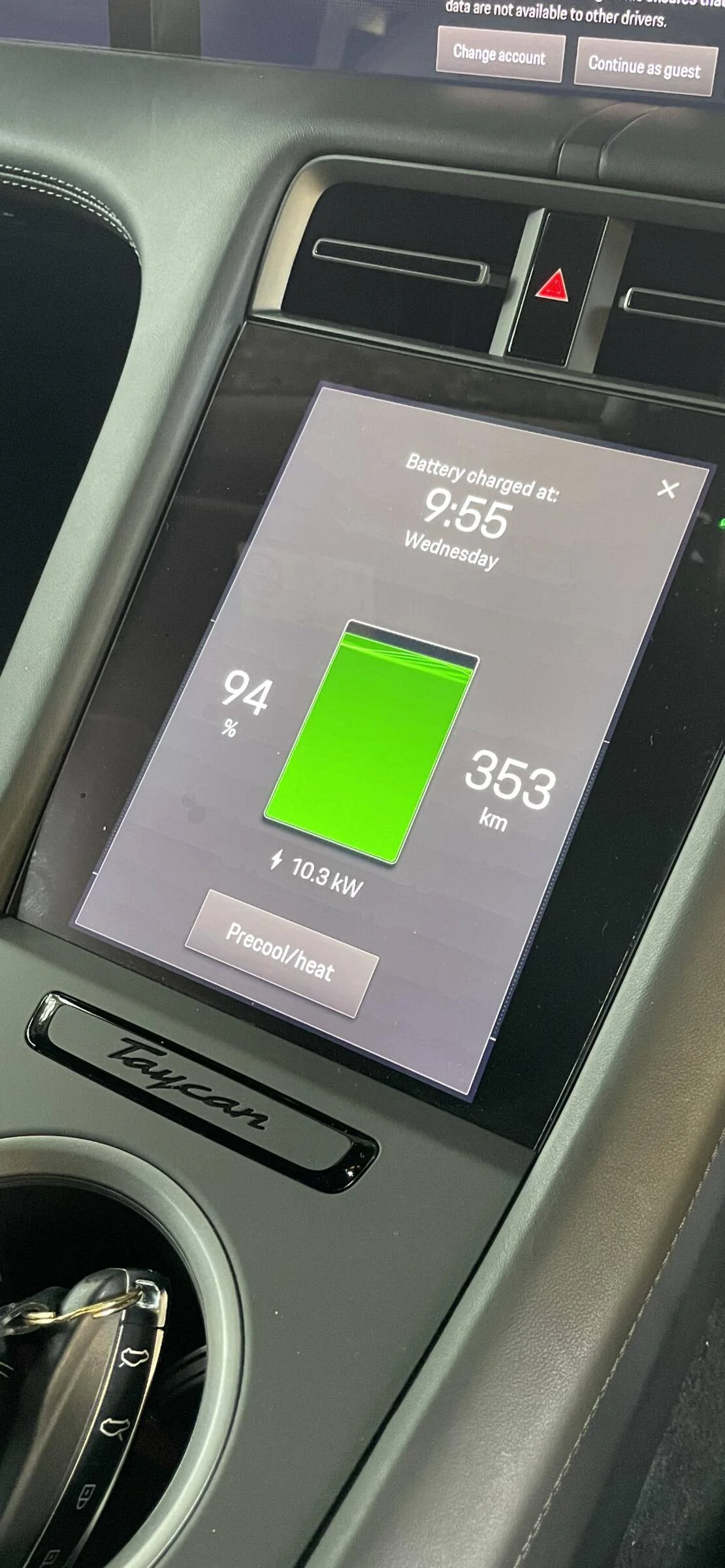

Is it for self comfort only ? So why this option so close to battery settings ?
Is it just to make me feel good when I am enetering the car after the cold night ?

It requires quite a lot of energy to heat the car so the idea is to preheat it while it’s still plugged in to not drain the battery before a trip or similar.

Note that while charging at home, if your charger is not powerfully enough, it will drain battery regardless.

it also heats the battery to 12-13 degrees c.
When normally doing a direct start of preconditioning roughly 1/2 hr before departure my car CT4S My22 is basically heating up the car, seat and steering wheel. The battery is just heated up from the outdoor temperature (roughly 0 c) to about 5-6 c.
However yesterday while using the timer, it also heated up the battery to 23 c.

Mostly for cabin comfort and can be set remotely via the app and / or use of a Timer. Cold / frosty mornings - use the feature to warm up the interior of the car.
Side effect is (obviously) to increase the temperature of the main battery which helps with range.
Note that it isn't the same as preconditioning the battery prior to charging.
Read the section in the Porsche Good To Know App for more details.
