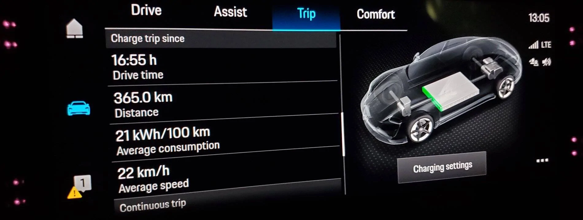

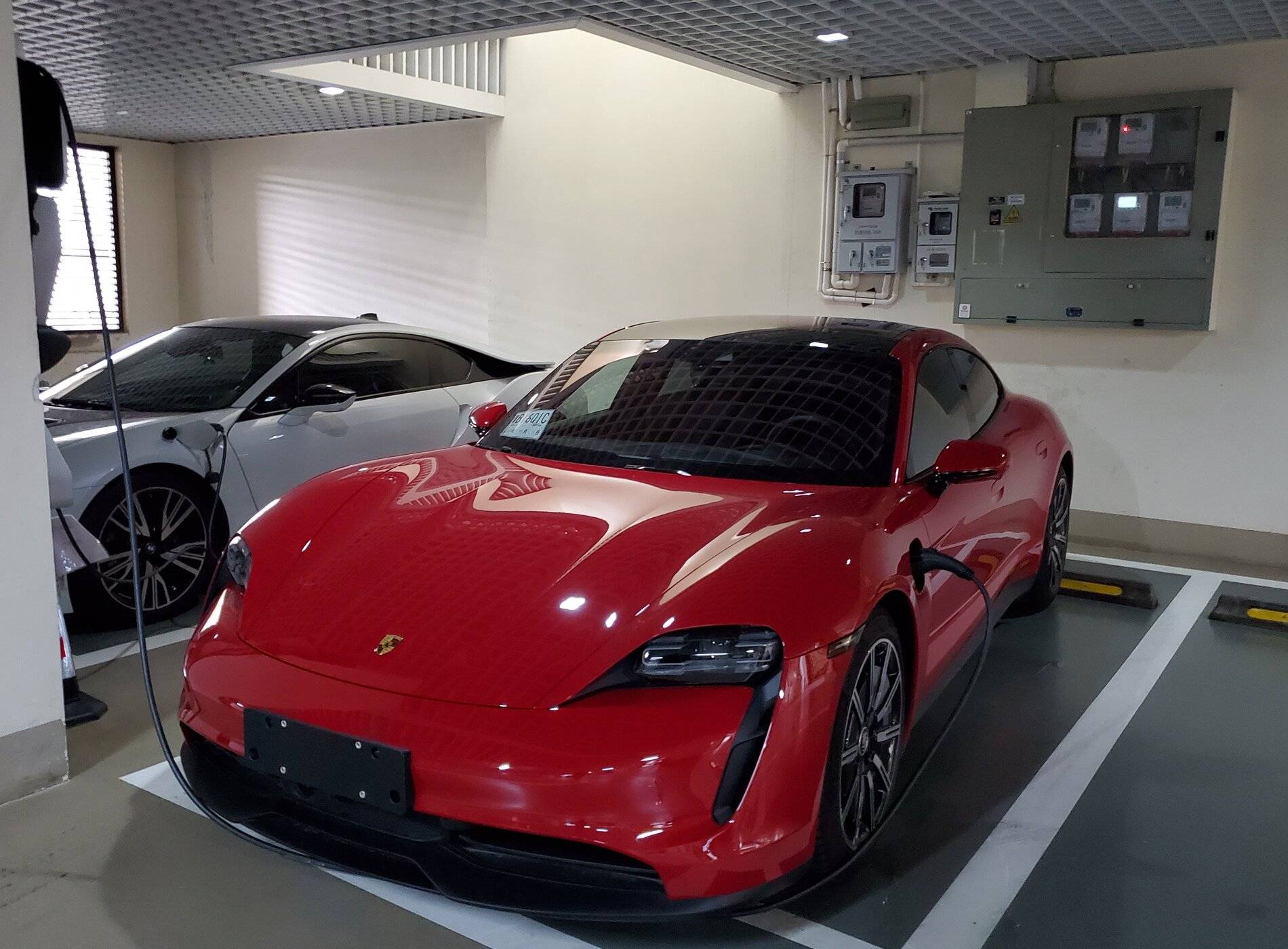

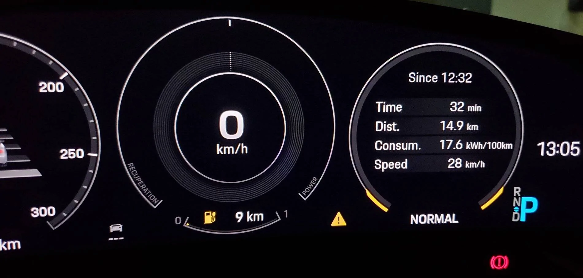

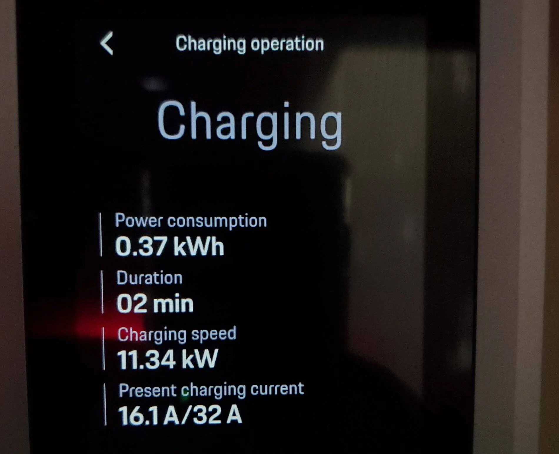

Today, I ran the battery down to less than half a percent.
Porsche Taycan What level are you?  Post your garage charging plans or what you've done 20200910_155827
Porsche Taycan What level are you?  Post your garage charging plans or what you've done 20200910_130535
Porsche Taycan What level are you?  Post your garage charging plans or what you've done 20200910_130520
Porsche Taycan What level are you?  Post your garage charging plans or what you've done 20200910_131928
I want to see, how much goes into for 100% SoC and how long it takes.

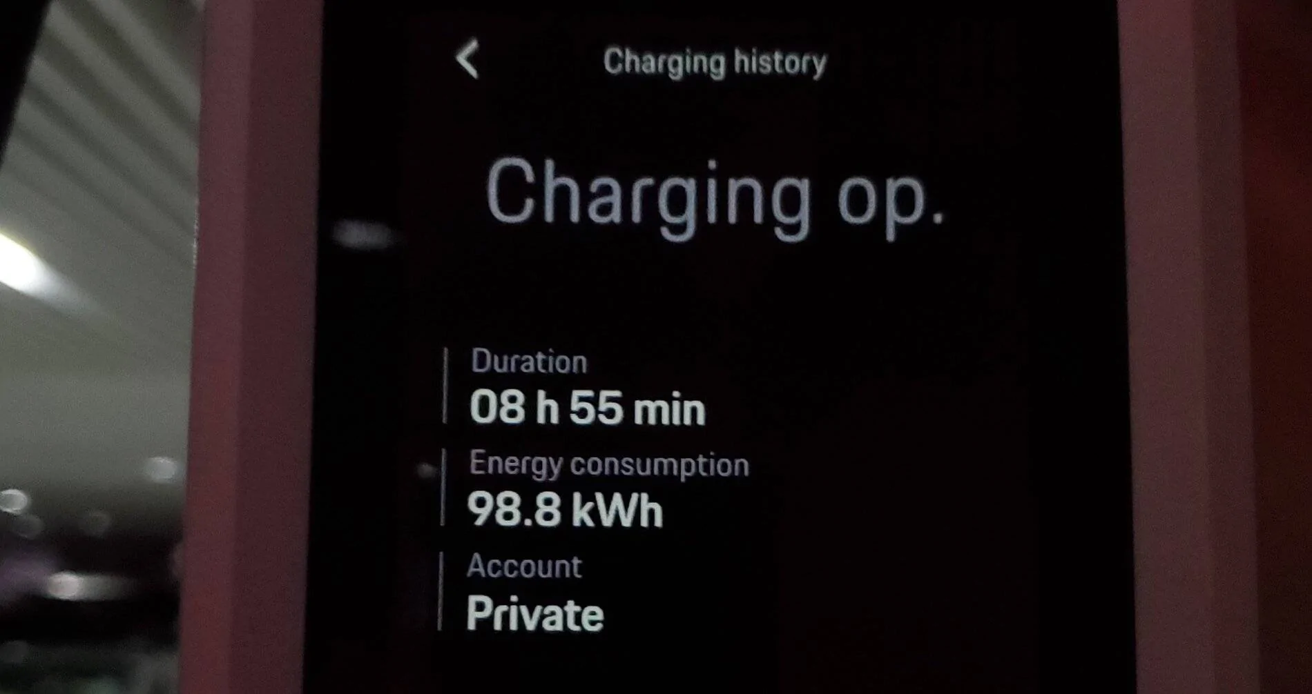

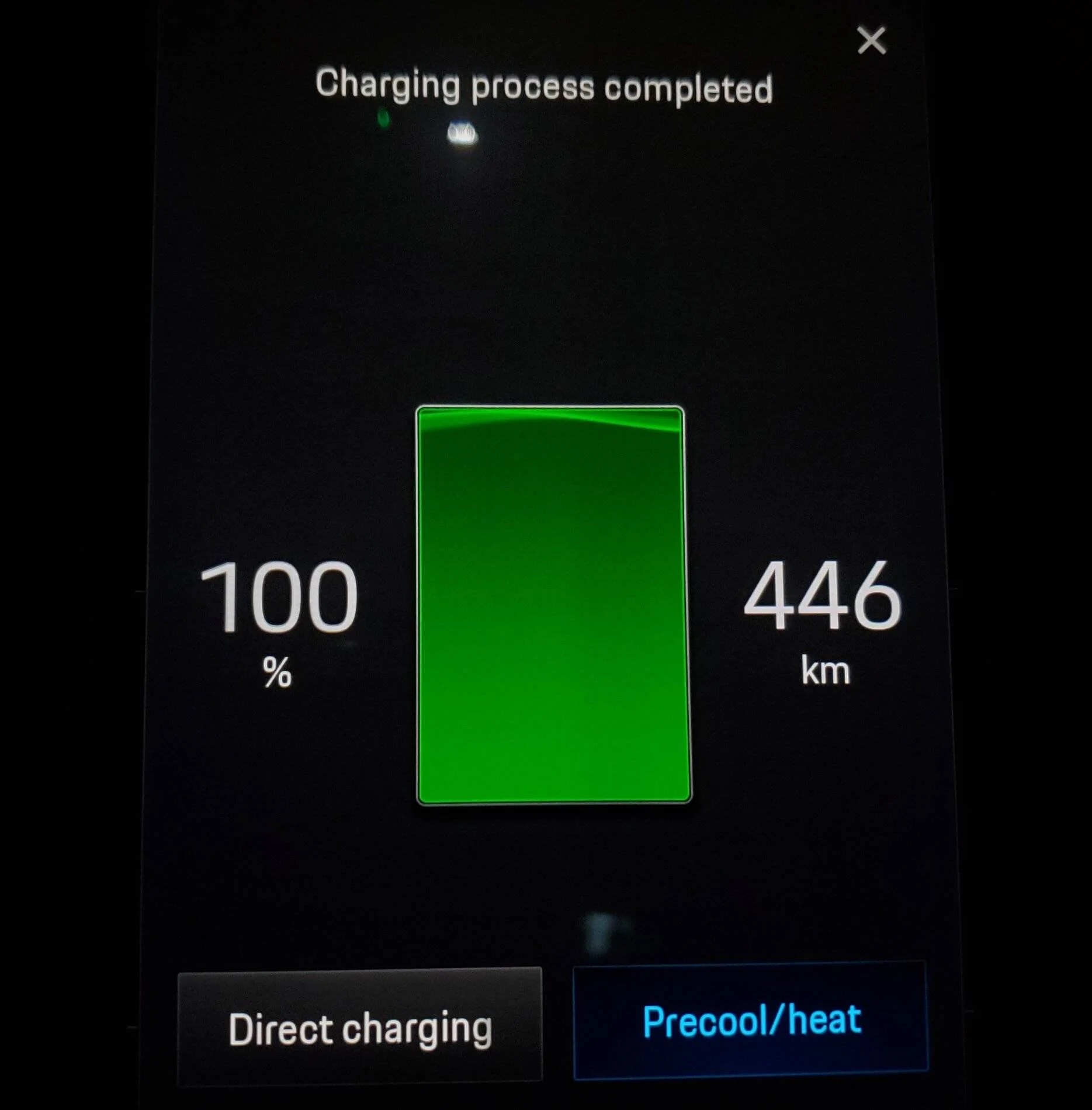

Follow up, after charging finished:
Porsche Taycan What level are you?  Post your garage charging plans or what you've done 20200910_221023
Porsche Taycan What level are you?  Post your garage charging plans or what you've done 20200910_221347
The grid power supply reports 101.81 kWh consumed, that is 3 kWh (3%) more than what the charger reports. I assume, that 98.8 kWh is what the charger measures on the output. So we still don't know how much kWh went into the battery and how much was consumed by the AC to DC converter in the car.
On a side note: After charging the reported 446km changed to 401km range this morning. Also not quite sure why over night the BC changed his mind...
