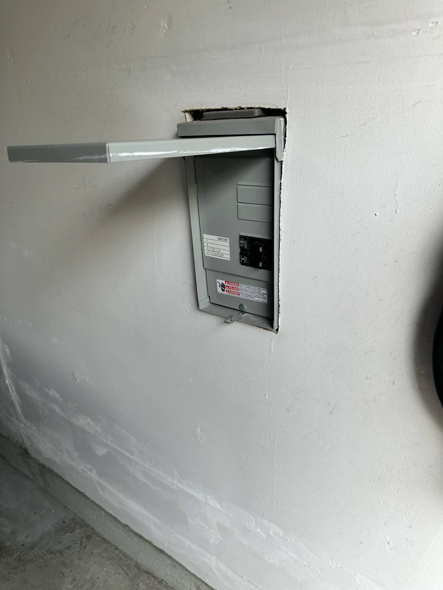

Here's what I've got. It's a 100A circuit for a Tesla. I can probably do a 50/50A split, and if I did, what plug would I have installed? Does the Taycan come with any plugs other than a standard nema 120V 15A? I was thinking a Nema 14-50? This is a quick-fix thing to call my electrician with, not a long term wall connector installation (yet!)

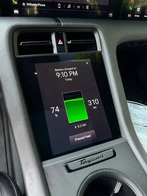

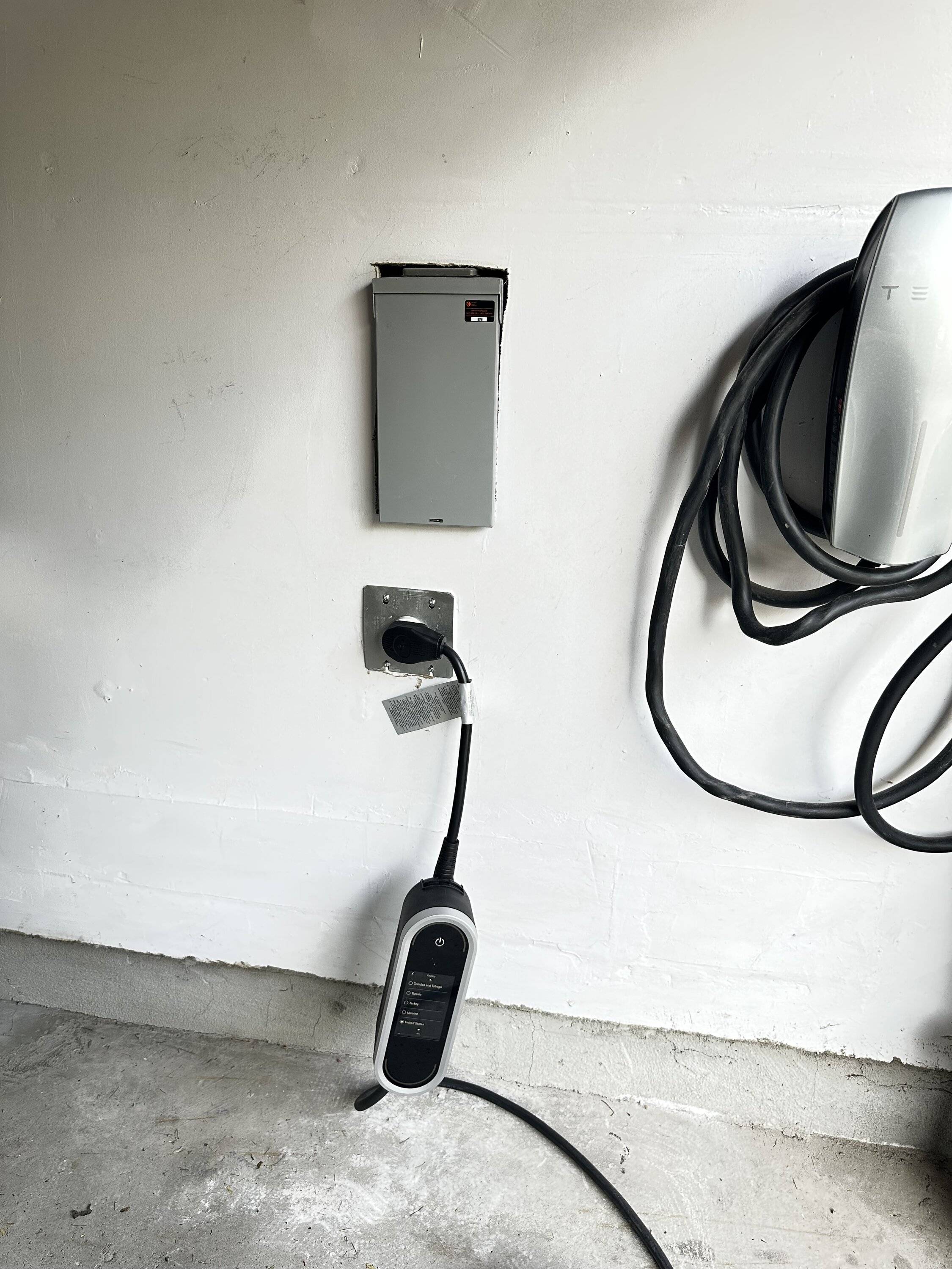

okay 14-50 plug installed and we’re charging at 8.2kw
expected and normal for 9.6 kW "raw" with a 40 amp outlet.
